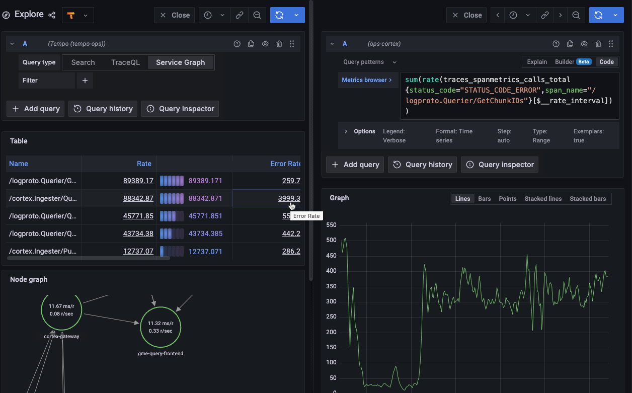

Let’s say you want to learn more about why cortex.Ingester has the highest error rates. Selecting the second row of the Error rate column displays details about the span metrics in a new window on the right side.
Error rate example

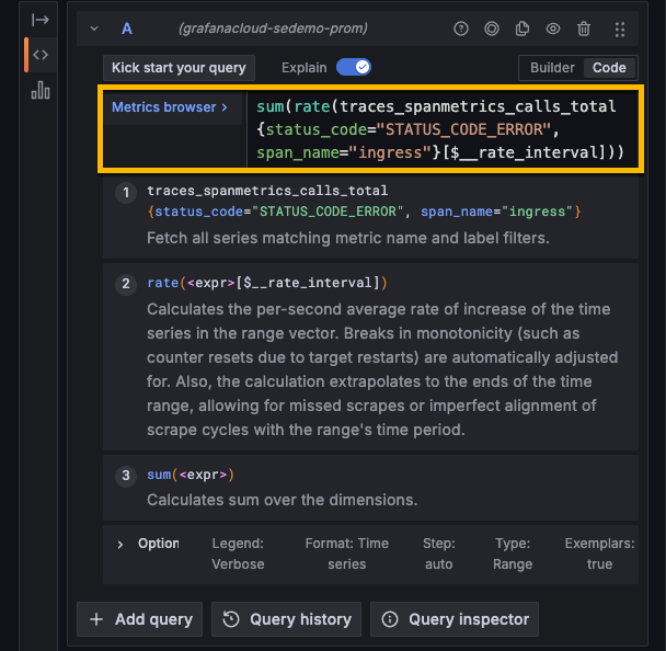

The metrics query used to generate the data appears in the Metrics browser field.
Error example query editor

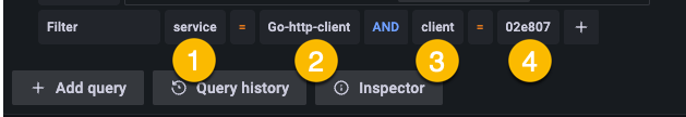

Each field or label represents a key-value pair. Number 1 selects a service as the label whose value is Go-http-client (2). The second key-value pair has a client as a label whose value is 02e807.
Filter example with numbers

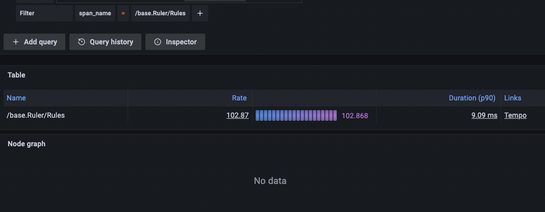

If your metrics queries are too specific, they may not return any results.
Updating the filter to be less specific returns a result. In this case, the results show only span metrics data associated with the span_name label with a value of /base.Ruler/Rules. No service graph data was available.
Filter example with one results
