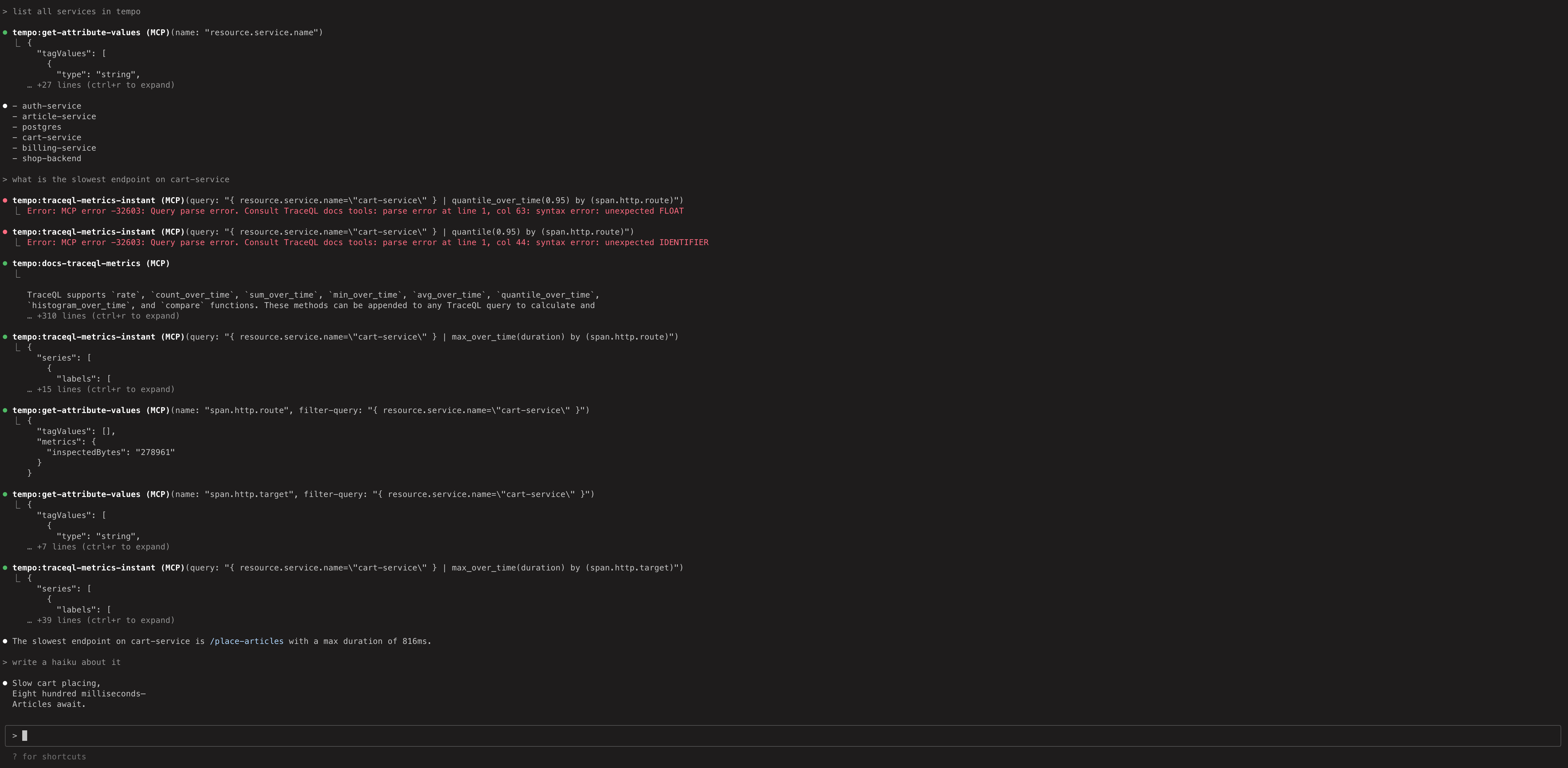

Quick start
To experiment with the MCP server using dummy data and Claude Code:
  1. Run the local docker-compose example in /example/docker-compose/local. This exposes the MCP server at http://localhost:3200/api/mcp
  2. Run claude mcp add --transport=http tempo http://localhost:3200/api/mcp to add a reference to Claude Code.
  3. Run claude and ask some questions.
This MCP server has also been tested successfully in cursor using the mcp-remote package.
Claude Code interacting with the Tempo MCP server
