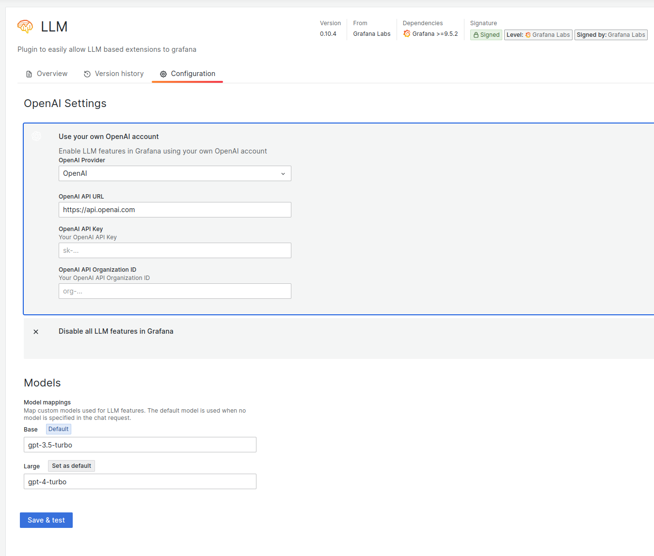

To get started:
  1. Add the LLM App plugin.
  2. Set up your OpenAI API Key and OpenAI API Organization ID.
Configure LLM App plugin for Grafana to set API key and organization ID.

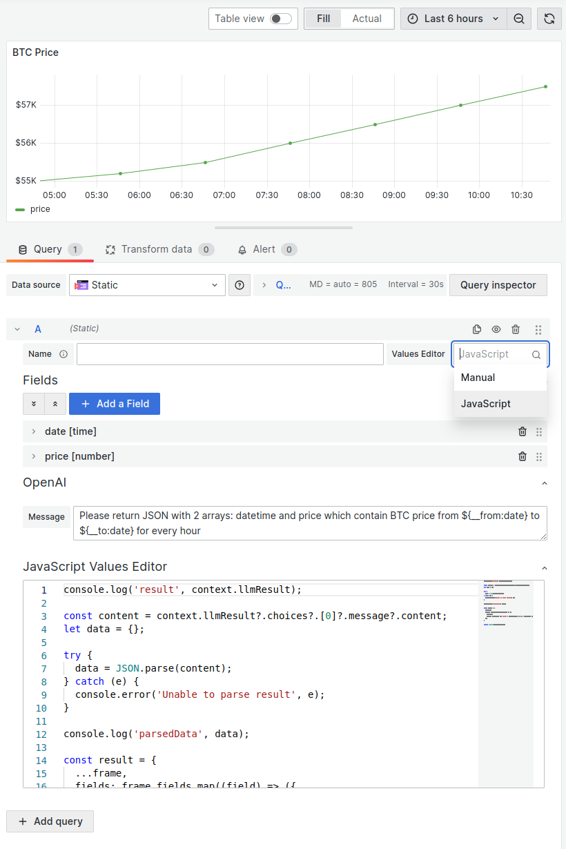

After you configure the LLM App, a text area appears in the Code editor mode of the Business Input data source.
Note
Dashboard and global variables are supported in the text area.
This text area lets you use the response from the LLM App with OpenAI. The system stores the result in context.llmResult.
Result returned from LLM App for BTC price.
Example with BTC price
Message
js
Please return JSON with 2 arrays: datetime and price which contain BTC price
from ${__from:date} to ${__to:date} for every hour
JavaScript code editor
js
console.log("result", context.llmResult);
const content = context.llmResult?.choices?.[0]?.message?.content;
let data = {};
try {
  data = JSON.parse(content);
} catch (e) {
  console.error("Unable to parse result", e);
console.log("parsedData", data);
const result = {
  ...frame,
  fields: frame.fields.map((field) => ({
    ...field,
    values: field.name === "date" ? data.datetime || [] : data.price || [],
return Promise.resolve(result);

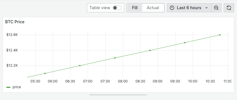

Result
You can display the data frame with any panel plugin.
Display OpenAI results for BTC price using native Time Series panel.
