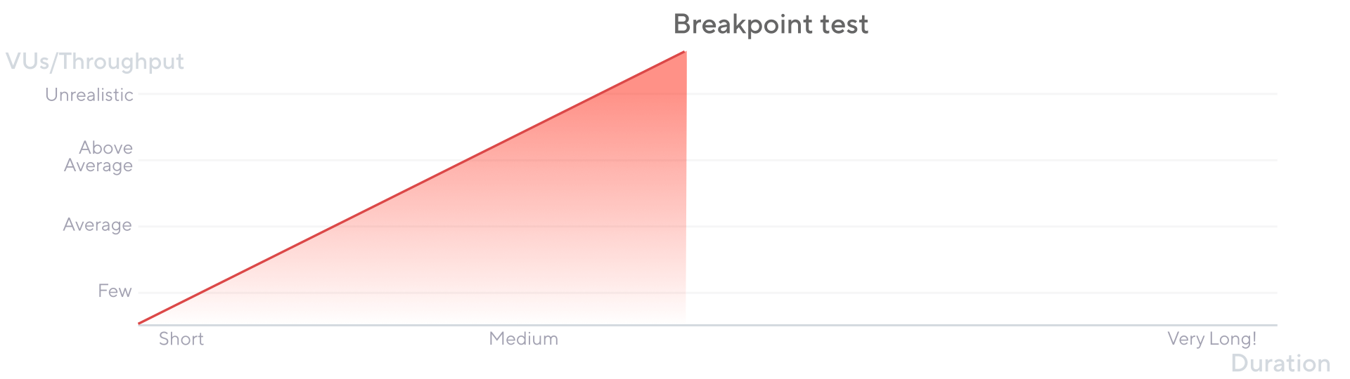

A breakpoint ramps to unrealistically high numbers. This test commonly has to be stopped manually or automatically as thresholds start to fail. When these problems appear, the system has reached its limits.

The breakpoint test is straightforward. Load slowly ramps up to a considerably high level. It has no plateau, ramp-down, or other steps. And it generally fails before reaching the indicated point.

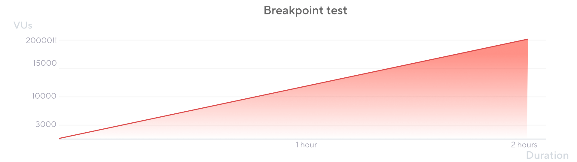

    { duration: '2h', target: 20000 }, // just slowly ramp-up to a HUGE load

The shape of the breakpoint test as configured in the preceding script
