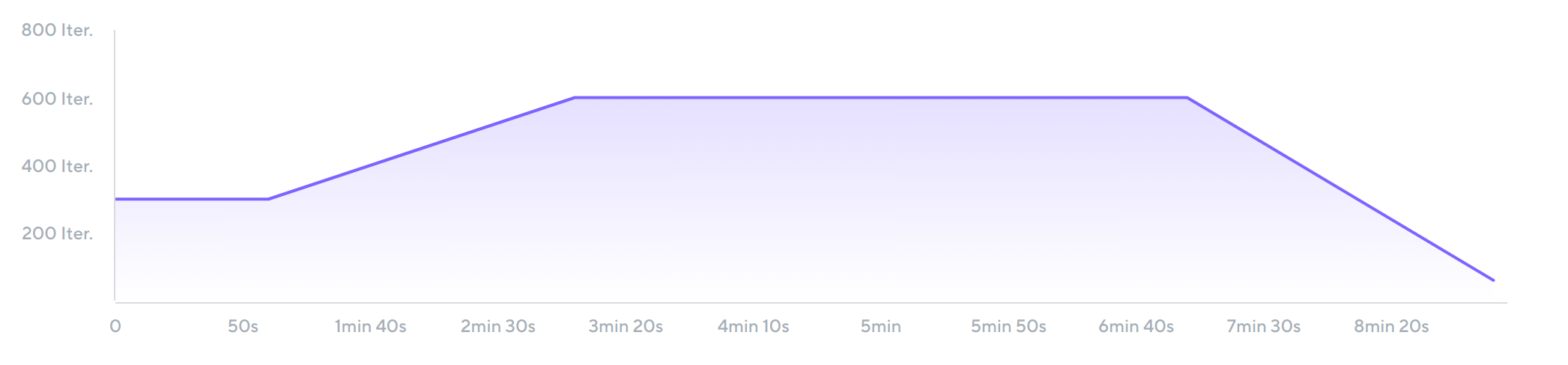

The following graph depicts the performance of the example script:
Based upon our test scenario inputs and results:
- The configuration defines 4 stages for a total test duration of 9 minutes.
- Stage 1 maintains the
startRateiteration rate at 300 iterations started per minute for 1 minute. - Stage 2 ramps up the iteration rate linearly from the stage 1 of 300 iterations started per minute, to the target of 600 iterations started per minute over a 2-minute duration.
- Stage 3 maintains the stage 2 iteration rate at 600 iterations started per minute over a 4-minute duration.
- Stage 4 ramps down the iteration rate linearly to the target rate of 60 iterations started per minute over the last two minutes duration.
- Changes to the iteration rate are performed by k6, adjusting the number of VUs
- The script waits for a period of time (defined by the
gracefulStopoption) for iterations to finish. It doesn’t start new iterations during thegracefulStopperiod. - Our example performed, 4020 iterations over the course of the test.
