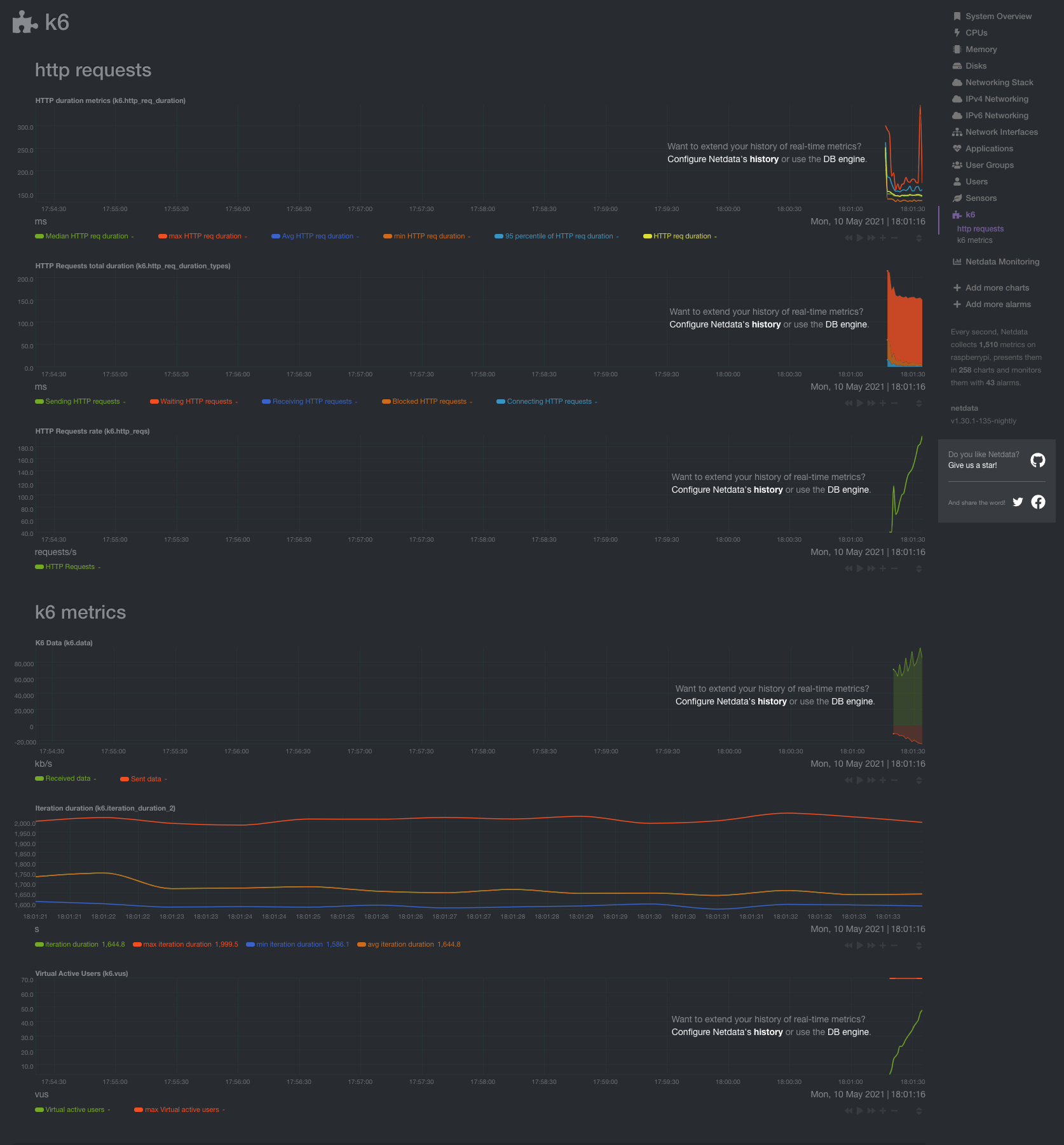

Visualize in Netdata
Netdata will automatically create charts for your application, as illustrated in the documentation.
Simply head over to localhost:19999 (assuming that you are running Netdata on the same machine) and find the k6 section. If you had opened Netdata before running the experiment, you will need to refresh the dashboard page.
