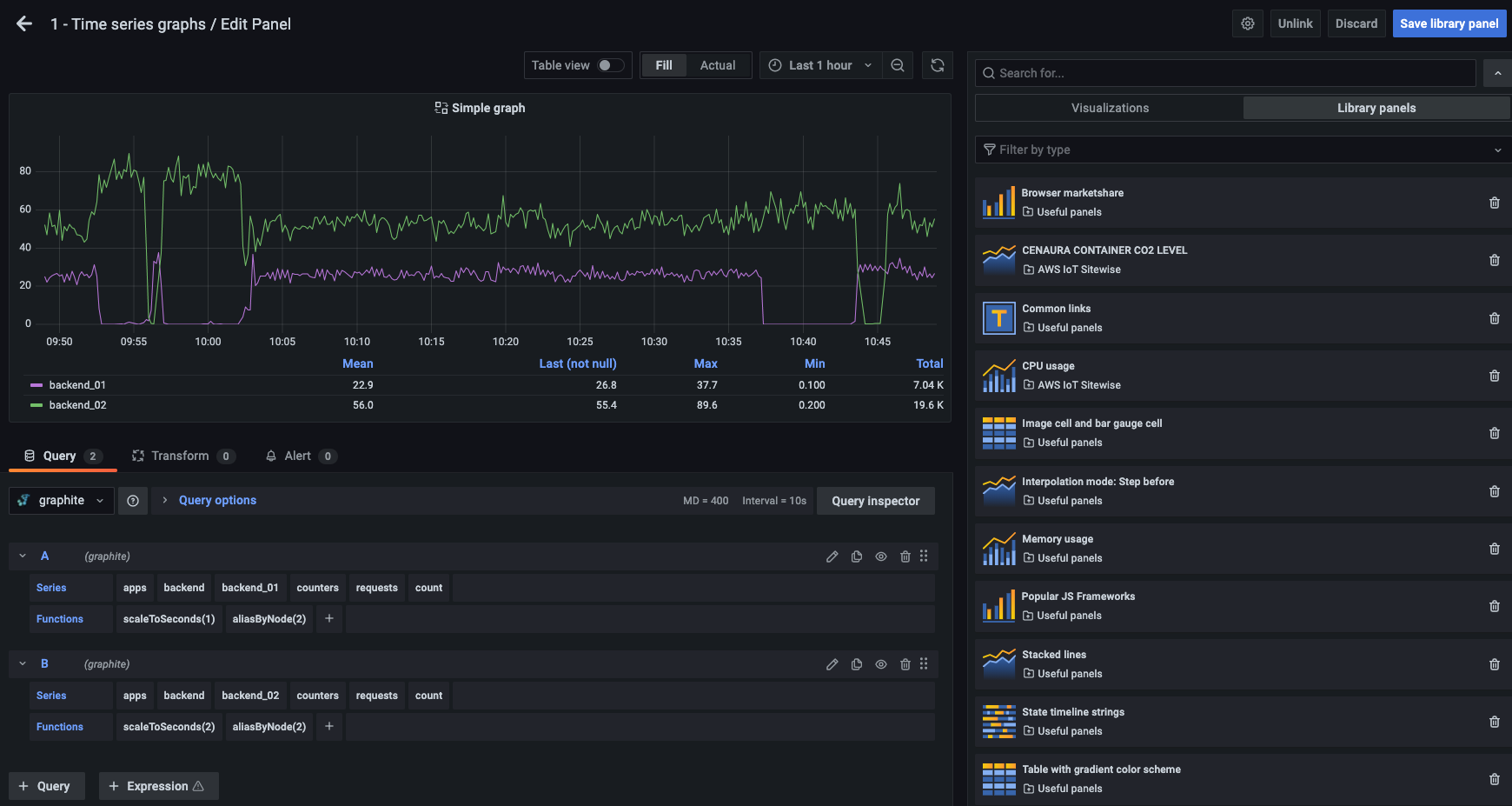

  2. Click the title of the panel and then click Edit. The panel opens in edit mode.
  3. In the panel display options (side pane), click the down arrow option to bring changes to the visualization.
    Screenshot of the edit panel

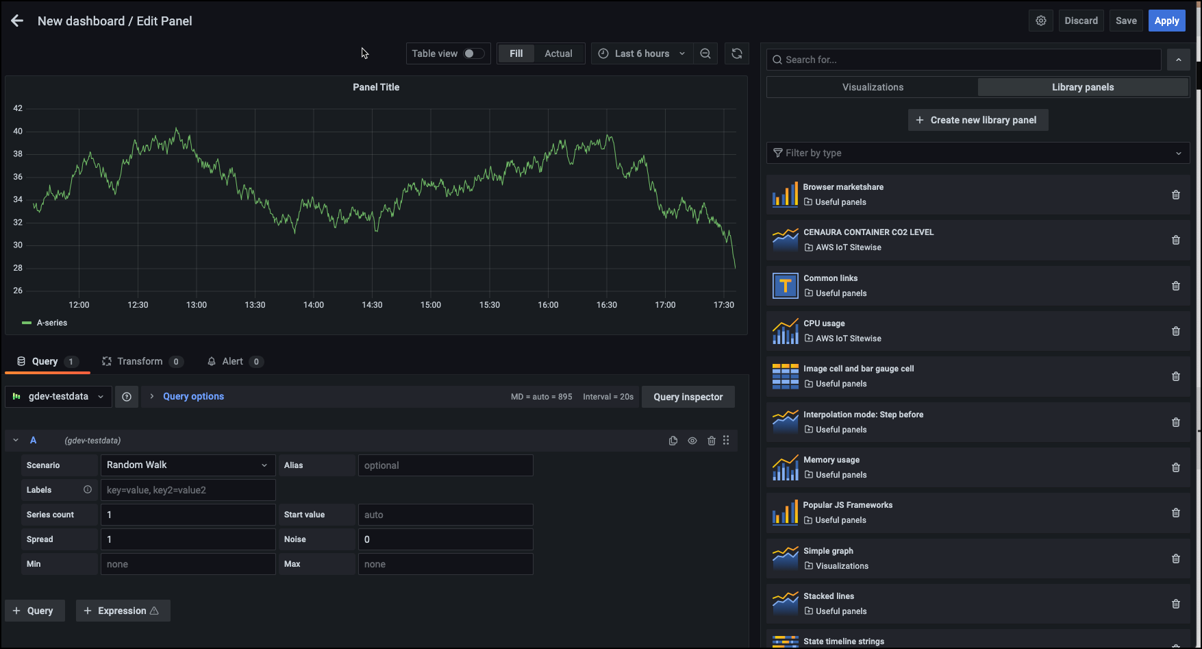

  4. Click the Library panels option, and then click Create new library panel to open the create dialog.

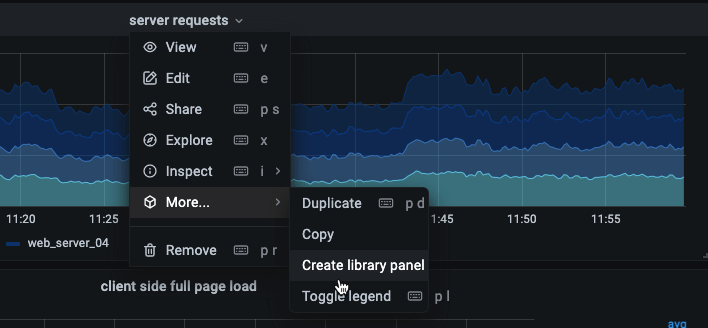

Optionally, you can click title of the panel and then click More > Create Library panel. Next, follow the instructions Step 5 in the procedure above.

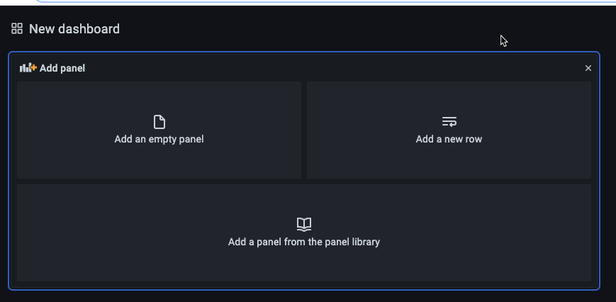

  1. Hover over the + option on the left menu, then select Create from the drop-down options. The Add panel dialog opens.
  2. Click the Add a panel from the panel library option. You will see a list of your library panels.
  3. Filter the list or search to find the panel you want to add.
  4. Click your desired panel and add it to the dashboard.

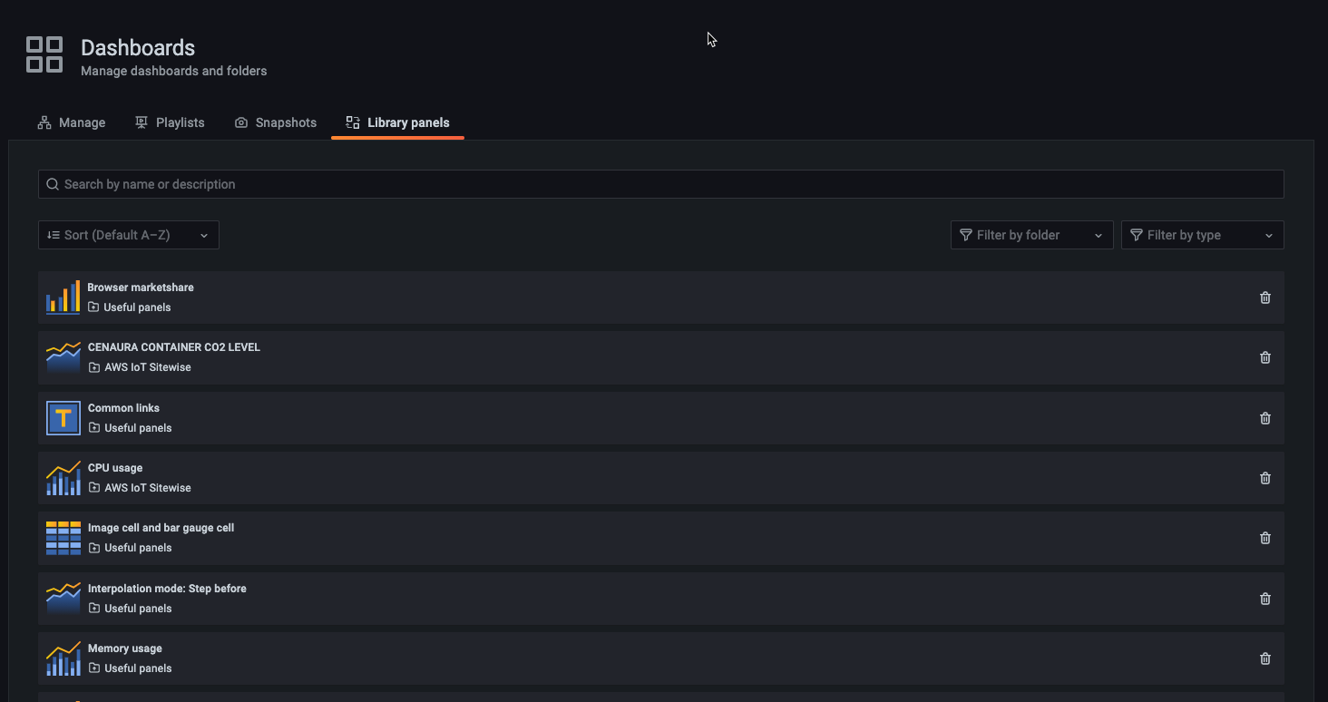

  1. Hover over the Dashboard option on the left menu, then click Library panels. You can see a list of previously defined library panels.
  2. Search for a specific library panel if you know its name. You can also filter the panels by folder or type.
