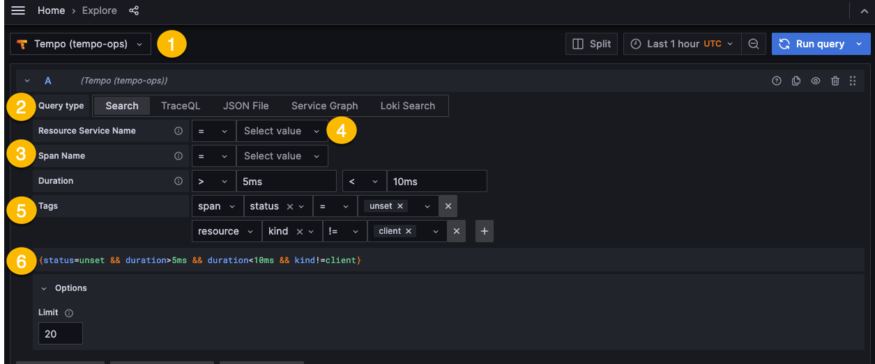

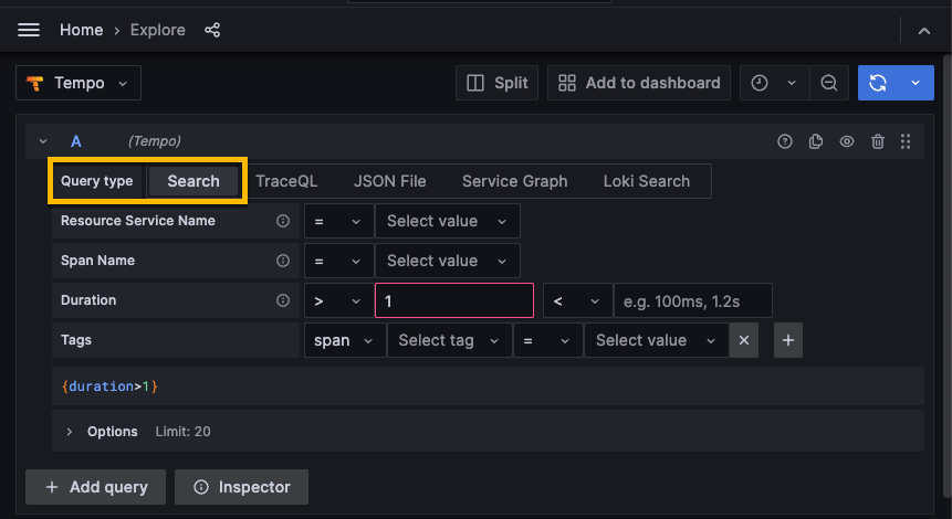

To access Search, select your Tempo data source, and then choose Explore and select Query type > Search. You can use the query builder to search trace data by resource service name, span name, duration, and one or more tags. The examples on this page use the default filters.

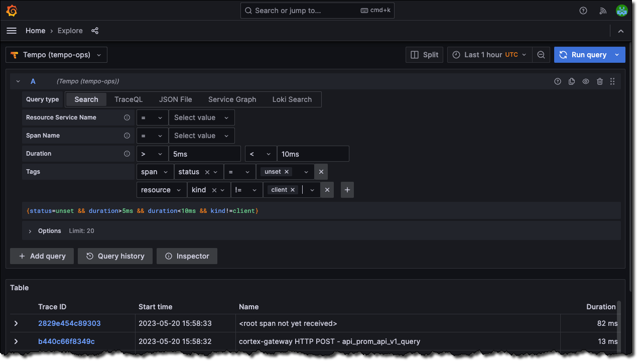

To perform a search, you need to select filters and/or tags and then run the query. The results appear underneath the query builder. The screenshot identifies the areas used to perform a search.

- From the menu, choose Explore and select Query type > Search.

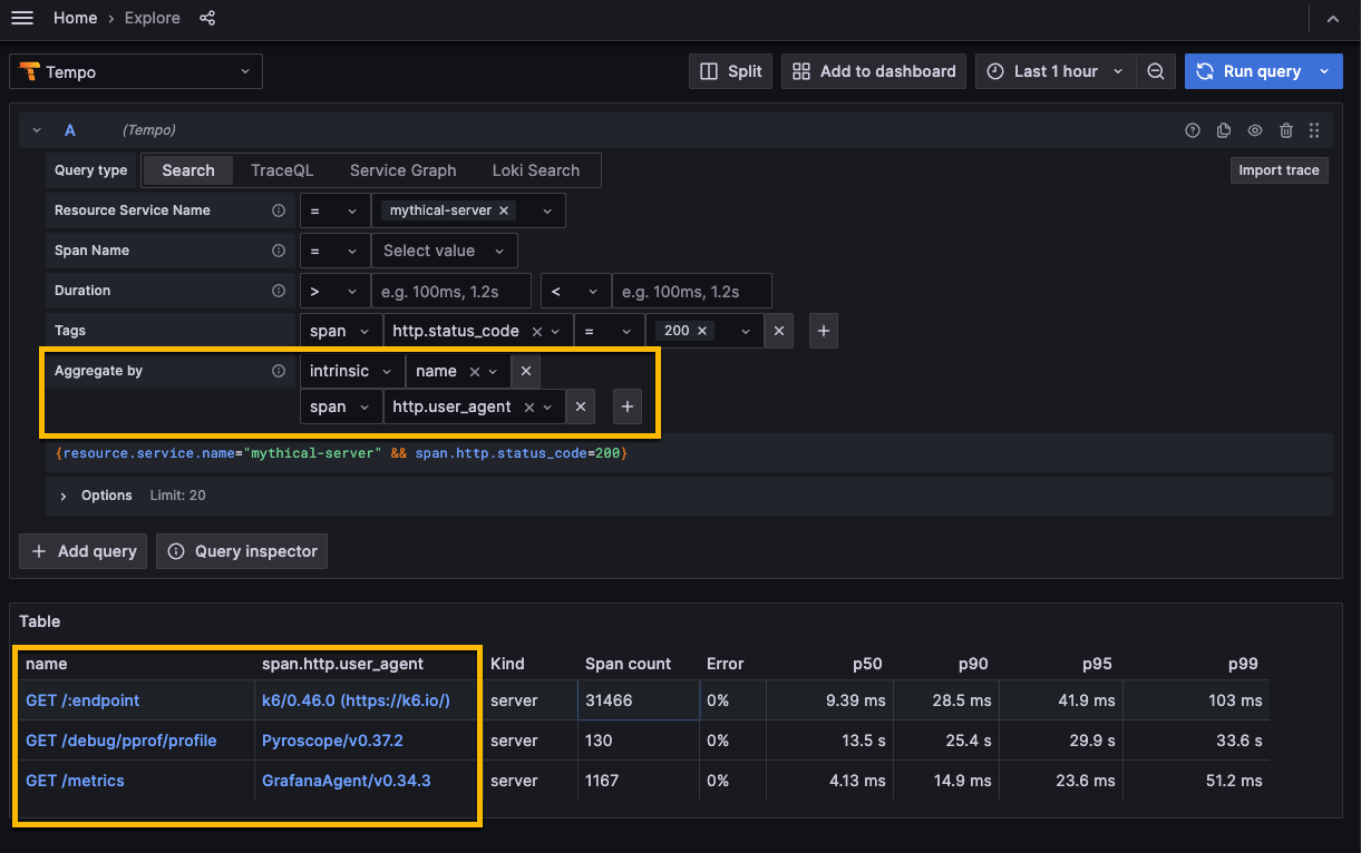

Using Aggregate by, you can calculate RED metrics (total span count, percent erroring spans, and latency information) for spans of kind=server
that match your filter criteria, grouped by one or more attributes.
This capability is based on the metrics summary API.
Metrics summary only calculates summaries based on spans received within the last hour.
For additional information, refer to Traces to metrics: Ad-hoc RED metrics in Grafana Tempo with Aggregate by
When you use Aggregate by, the selections you make determine how the information is reported in the Table. Every combination that matches selections in your data is listed in the table.
Each aggregate value, for example intrinsic
:name
, has a corresponding column in the results table.
For example, names matching GET /:endpoint
with a span.http.user_agent of k6/0.46
appeared in 31,466 spans. Instead of being listed by traces and associated spans, the query results are grouped by the selections in Aggregate by.
The RED metrics are calculated for every name and user agent combination found in your data.
The screenshot shows all of the successful HTTP status_code
API calls against the mystical-server
service.
The results are shown in the same order used in Aggregate by.
For example, Aggregate by lists intrinsic.name
followed by span.http.user_agent
The first column in the results Table shows name and then span.http.user_agent.

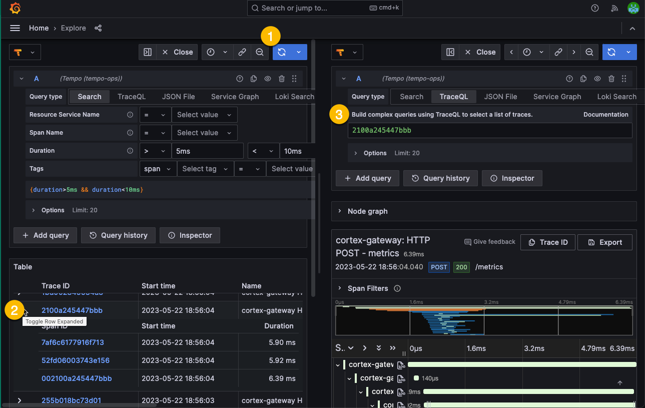

Select Run query to run the TraceQL query (1 in the screenshot).
Queries can take a little while to return results. The results appear in a table underneath the query builder. Selecting a Trace ID (2 in the screenshot) displays more detailed information (3 in the screenshot).
