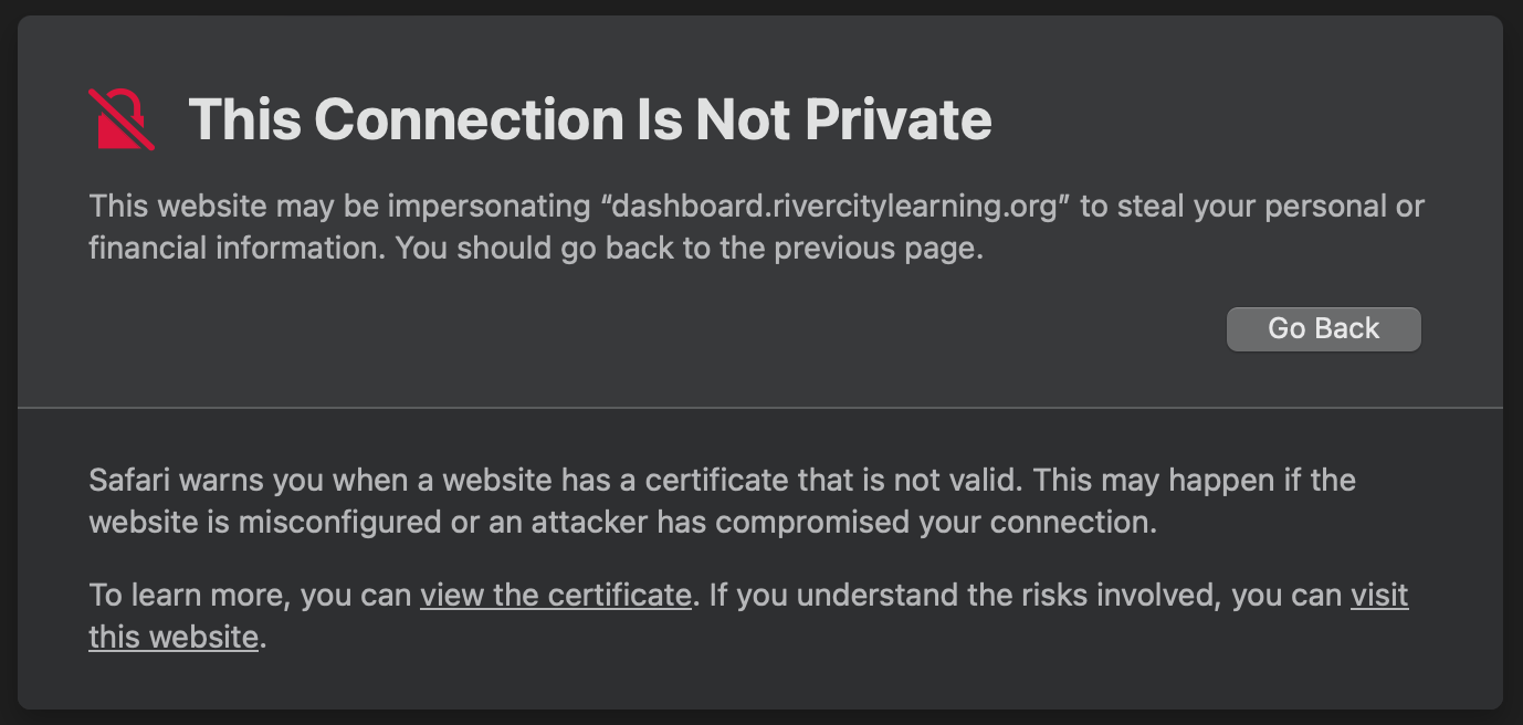

    Note: When using these files, browsers might provide warnings for the resulting website because a third-party source does not trust the certificate. Browsers will show trust warnings; however, the connection will remain encrypted.
    The following image shows an insecure HTTP connection.
    Insecure HTTPS connection
