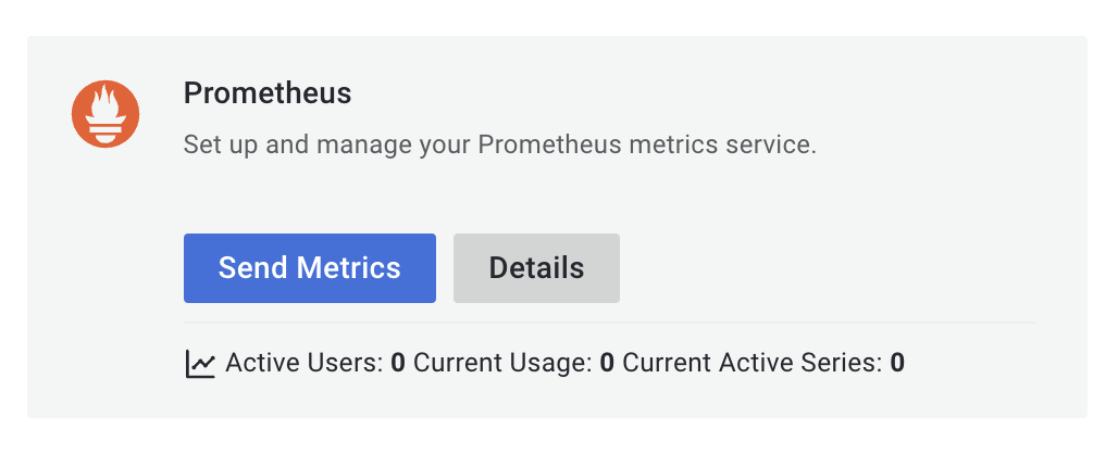

  1. Sign up for https://grafana.com/. Grafana gives you a Prometheus instance out of the box.
Prometheus details in Grafana.com
  1. Because you are running your own Prometheus instance locally, you must remote_write your metrics to the Grafana.com Prometheus instance. Grafana provides code to add to your prometheus.yml config file. This includes a remote write endpoint, your user name and password.

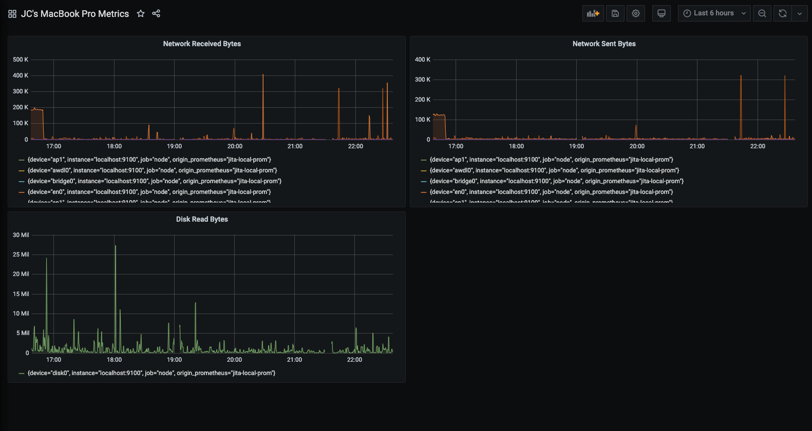

Start building dashboards
Now that you have a curated list of queries, create dashboards to render system metrics monitored by Prometheus. When you install Prometheus and Node exporter or windows_exporter, you will find recommended dashboards for use.
The following image shows a dashboard with three panels showing some system metrics.
Prometheus dashboards
