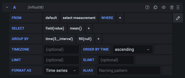

The InfluxQL query editor helps you select metrics and tags to create InfluxQL queries. There are two modes: visual editor mode and raw query mode. To switch between the two modes click the pencil icon in the upper right.
Visual query editor mode contains the following components:
  • FROM - Select a measurement to query.
  • WHERE - Select filters by clicking the + sign.
  • SELECT - Select fields and functions from the drop-down. You can add multiple fields and functions by clicking the + sign.
  • GROUP BY - Select a tag from the drop-down menu.
  • TIMEZONE - Optional Group data by a specific timezone.
  • ORDER BY TIME - Sort data by time in either ascending or descending order.
  • LIMIT - Optional Limits the number of rows returned by the query.
  • SLIMIT - Optional Limits the number of series returned by the query. Refer to SLIMIT clause for more information on this option.
  • FORMAT AS - Select a format option from the drop-down menu.
  • ALIAS - Add an alias. Refer to Alias patterns for more information.
