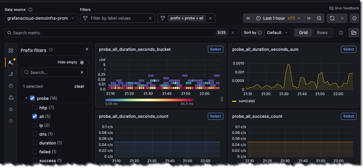

show metrics drilldown main page with filters highlighted
Apply advanced filters
Apply advanced filters to further refine the metrics that appear in Metrics Drilldown. Access the following advanced filters from the left-side menu of the Metrics Drilldown app.
Filter typeDescription
Rules filtersFilter metrics based on whether they use recording or alerting rules.
Prefix filtersFilter metrics based on their name prefix in the Prometheus namespace. Multiple selected prefixes use “OR” logic.
Suffix filtersFilter metrics based on their name suffix. Multiple selected suffixes use “OR” logic.
Group by labelsGroup metrics by their label values.
Note
Multiple selections for a filter apply “OR” logic, but selections between filters apply “AND” logic. For example, if you select both envoy and kafka as prefix filters, the app shows all metrics with a prefix of either envoy or kafka. Then, if you select count as a suffix filter, the app updates to only show metrics with the count suffix.
