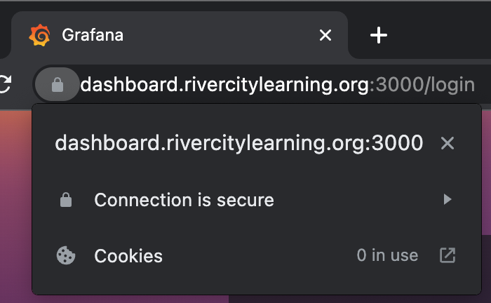

The following image shows a browser lock icon which confirms the connection is safe.
Secure HTTPS connection
