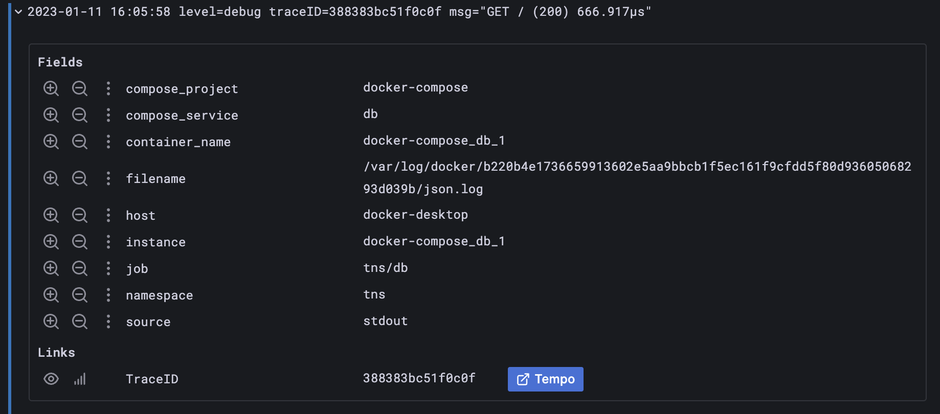

Log details view
In Explore, each log line has an expandable section called Log details that you open by clicking on the log line. The Log details view provides additional information and exploration options in the form of Fields and Links attached to the log lines, enabling a more robust interaction and analysis.
Fields
Within the Log details view, you have the ability to filter the displayed fields in two ways: a positive filter, which focuses on an specific field and a negative filter, which excludes certain fields. These filters modify the corresponding query that generated the log line, incorporating equality and inequality expressions accordingly.
If the data source supports it, as is the case with Loki and Elasticsearch, log details will verify whether the field is already included in the current query, indicating an active state for positive filters. This enables you to toggle it off from the query or convert the filter expression from positive to negative as necessary.
Click the eye icon to select a subset of fields to visualize in the logs list instead of the complete log line.
Each field has a stats icon, which displays ad-hoc statistics in relation to all displayed logs.
