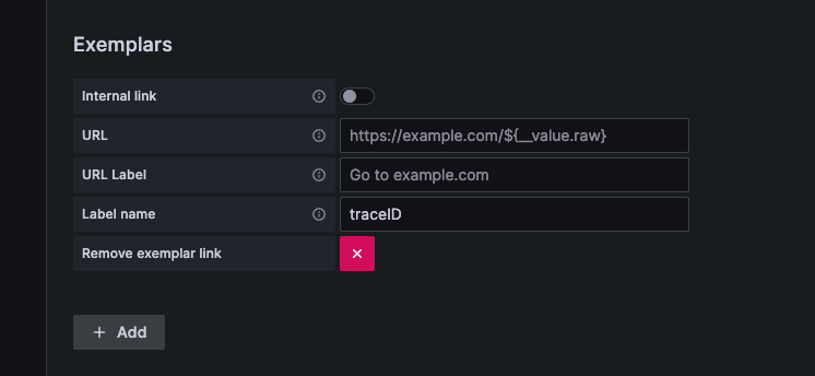

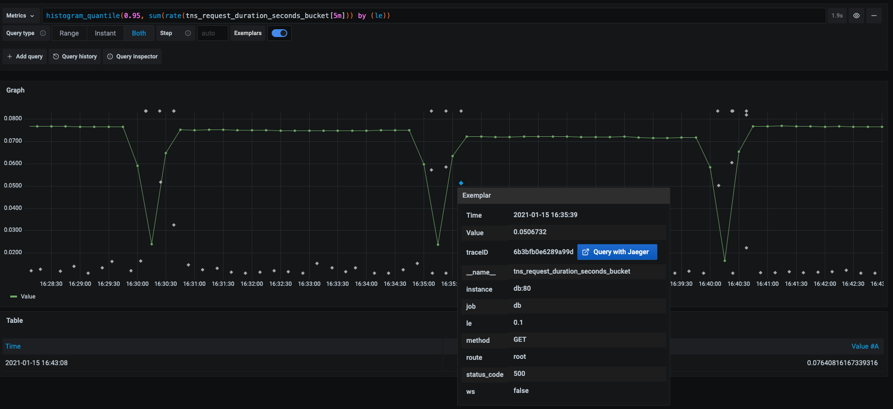

Exemplars
Exemplars associate higher-cardinality metadata from a specific event with traditional time series data. See Introduction to exemplars in Prometheus documentation for detailed information on how they work.
Note
Available in Prometheus v2.26 and higher with Grafana v7.4 and higher.
Grafana can show exemplars data alongside a metric both in Explore and in Dashboards.
See the Exemplars section in Configure Prometheus data source.
