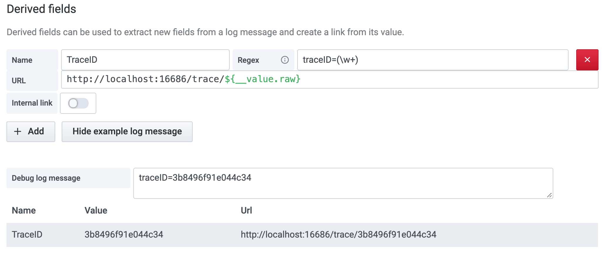

Derived fields
Derived Fields are used to extract new fields from your logs and create a link from the value of the field.
For example, you can link to your tracing backend directly from your logs, or link to a user profile page if the log line contains a corresponding userId
These links appear in the
log details.
You can add multiple derived fields.

Each derived field consists of the following:
Name - Sets the field name. Displayed as a label in the log details.
Type - Defines the type of the derived field. It can be either:
Caution
Using complex regular expressions in either type can impact browser performance when processing large volumes of logs. Consider using simpler patterns when possible.
Regex: A regular expression to parse a part of the log message and capture it as the value of the new field. Can contain only one capture group.
Label: A label from the selected log line. This can be any type of label - indexed, parsed or structured metadata. When using this type, the input will match as a regular expression against label keys, allowing you to match variations like
traceid
andtrace_id
with a single regex pattern liketrace[_]?id
. The value of the matched label will be used as the value of the derived field.URL/query Sets the full link URL if the link is external, or a query for the target data source if the link is internal. You can interpolate the value from the field with the
${__value.raw}
macro.URL Label - Sets a custom display label for the link. This setting overrides the link label, which defaults to the full external URL or name of the linked internal data source.
Internal link - Toggle on to define an internal link. For internal links, you can select the target data source from a selector. This supports only tracing data sources.
Open in new tab - Toggle on to open the link in a new tab or window.
Show example log message - Click to paste an example log line to test the regular expression of your derived fields.

Troubleshoot interpolation
You can use a debug section to see what your fields extract and how the URL is interpolated. Select Show example log message to display a text area where you can enter a log message.
The new field with the link shown in log details:
