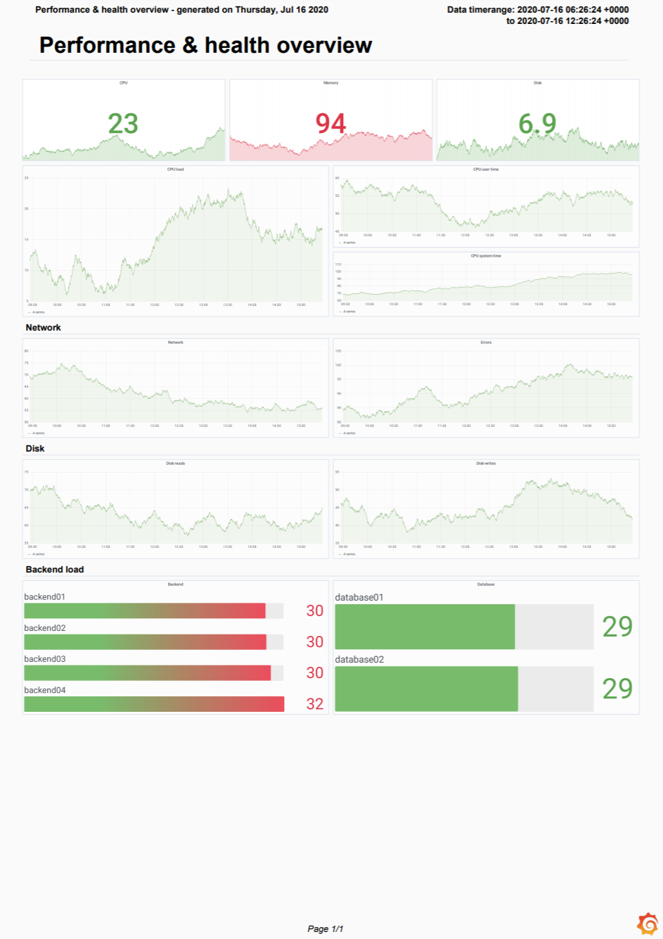

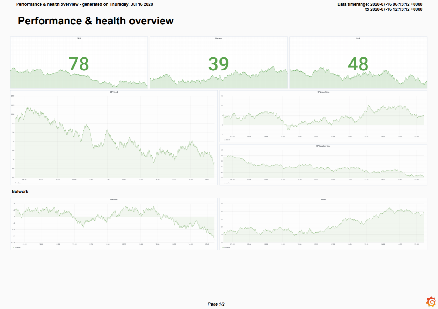

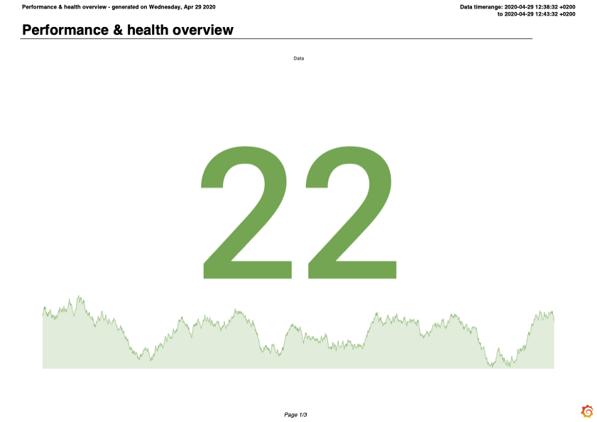

LayoutOrientationDescriptionPreview
SimplePortraitGenerates an A4 page in portrait mode with three panels per page.
Simple layout in portrait
SimpleLandscapeGenerates an A4 page in landscape mode with a single panel per page.
Simple layout in landscape
GridPortraitGenerates an A4 page in portrait mode with panels arranged in the same way as at the original dashboard.
Grid layout in portrait
GridLandscapeGenerates an A4 page in landscape mode with panels arranged in the same way as in the original dashboard.
Grid layout in landscape
