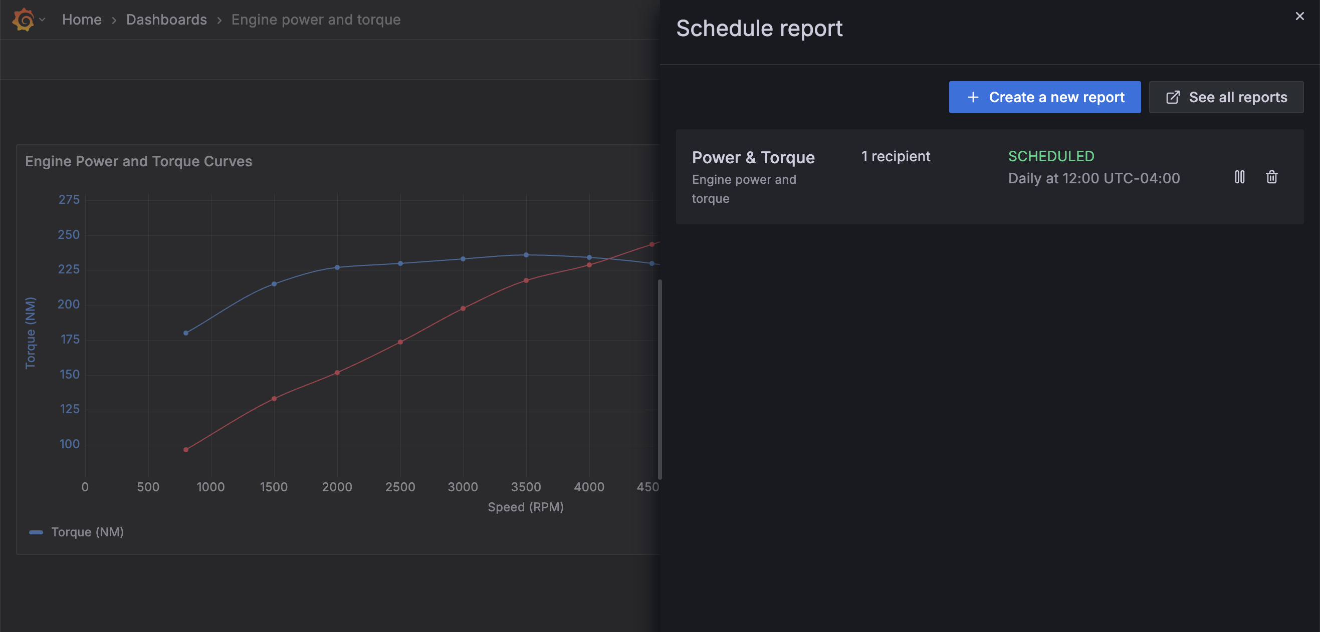

In the main menu, click Dashboards.
Navigate to the dashboard from which you want to create a report.
Click the Share drop-down list in the top-right corner of the dashboard.
Click Schedule report.
The Schedule report drawer opens. Any other reports using this dashboard are listed in the drawer. You can also click See all reports to navigate to Reporting for a full list of reports generated from all dashboards.

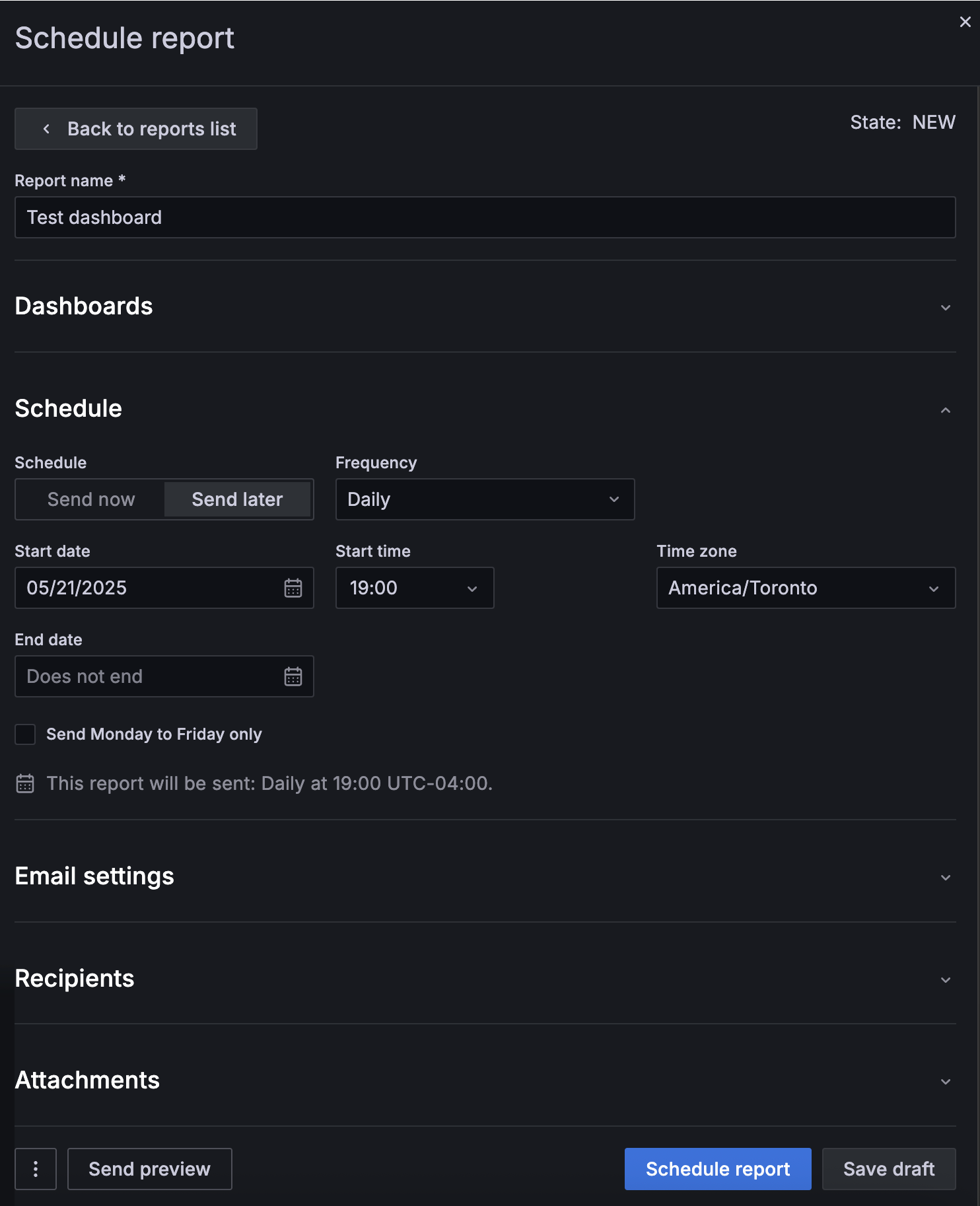

In the main menu, click Dashboards > Reporting.
Click + Create a new report.
Enter a name for the report.
Expand and complete each section of the report, as needed:
Click one of the following buttons at the bottom of the Schedule report drawer:
The menu icon to access the following options:
- Download CSV
- Preview PDF
- Report settings - Opens the Report template settings drawer, where you can configure organization-level report settings.
Send preview - Send a preview of the report to your desired recipient. You can choose to use the report recipients:
![The Send preview modal]()
Schedule report - The report is sent according the schedule you’ve set.
Save draft - Save a draft at any point during the initial report creation process, even if it’s missing required fields. The report won’t be sent according to its schedule while it’s a draft.
If you click the x at the top of the drawer without scheduling or saving the report as a draft, the report is discarded. This action can’t be reversed.
When you finish configuring the report, click the x at the top of the Schedule report drawer to close it.

2. Schedule
At this step, set scheduling information. Options vary depending on the frequency you select.
Time zone
Reports use the time zone of the dashboard from which they’re generated. You can control the time zone for your reports by setting the dashboard to a specific time zone. Note that this affects the display of the dashboard for all users.
If a dashboard has the Browser Time setting, the reports generated from that dashboard use the time zone of the Grafana server. As a result, this time zone might not match the time zone of users creating or receiving the report. If you want to use a specific time zone, save the dashboard with a fixed time zone instead of Browser Time
Each dashboard’s time zone setting is visible in the time range controls.

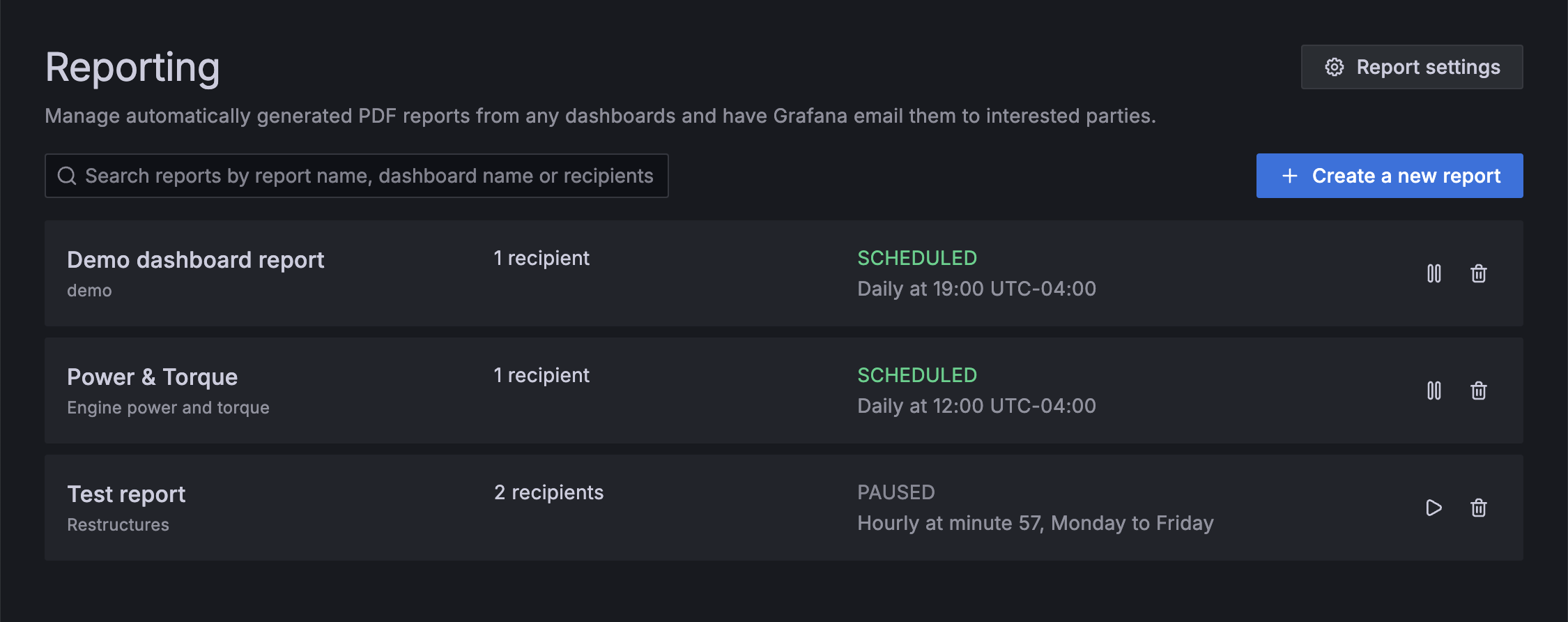

You can view and manage all your reports, and create new ones, on the Reporting page:
Alternatively, from any dashboard you can view and manage any reports generated from that dashboard, as well as create a new report You can also navigate to the list of all reports from the dashboard-specific list:
