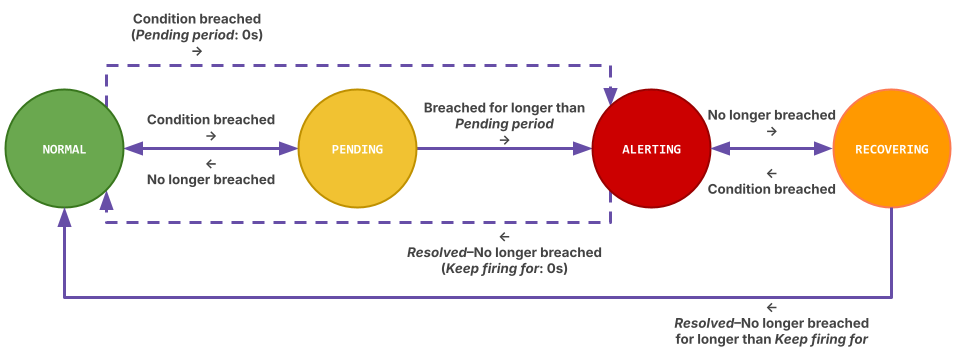

Alerting lifecycle
Each alert rule can generate one or more alert instances.
An alert instance transitions between these common states based on how long the alert condition remains met or not met.
StateDescription
NormalThe state of an alert when the condition (threshold) is not met.
PendingThe state of an alert that has breached the threshold but for less than the pending period.
AlertingThe state of an alert that has breached the threshold for longer than the pending period.
RecoveringThe state of a firing alert when the threshold is no longer breached, but for less than the keep firing for period.
A diagram of the lifecyle of a firing alert instance.
If an alert rule changes (except for updates to annotations, the evaluation interval, or other internal fields), its alert instances reset to the Normal state, and update accordingly during the next evaluation.

Pending period
You can set a Pending period to prevent unnecessary notifications caused by temporary issues.
When the alert condition is met, the alert instance enters the Pending state. It remains in this state until the condition has been continuously true for the entire Pending period.
This ensures the condition breach is stable before the alert transitions to the Alerting state and routed for notification.
  • Normal -> Pending -> Alerting*
You can also set the Pending period to zero to skip the Pending state entirely and transition to Alerting immediately.
Keep firing for
You can set a Keep firing for period to avoid repeated firing-resolving-firing notifications caused by flapping conditions.
When the alert condition is no longer met during the Alerting state, the alert instance enters the Recovering state.
  • AlertingRecoveringNormal (Resolved)*
  • After the Keep firing for period elapses, the alert transitions to the Normal state and is marked as Resolved.
  • If the alert condition is met again, the alert transitions back to the Alerting state, and no new notifications are sent.
You can also set the Keep firing for period to zero to skip the Recovering state entirely.
