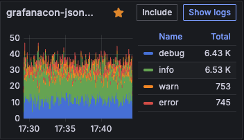

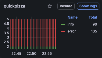

To interact with the JSON view, select the Show Logs button for your service in Logs Drilldown.
JSON Table viewer with selector and include exclude highlighted
Show Logs button

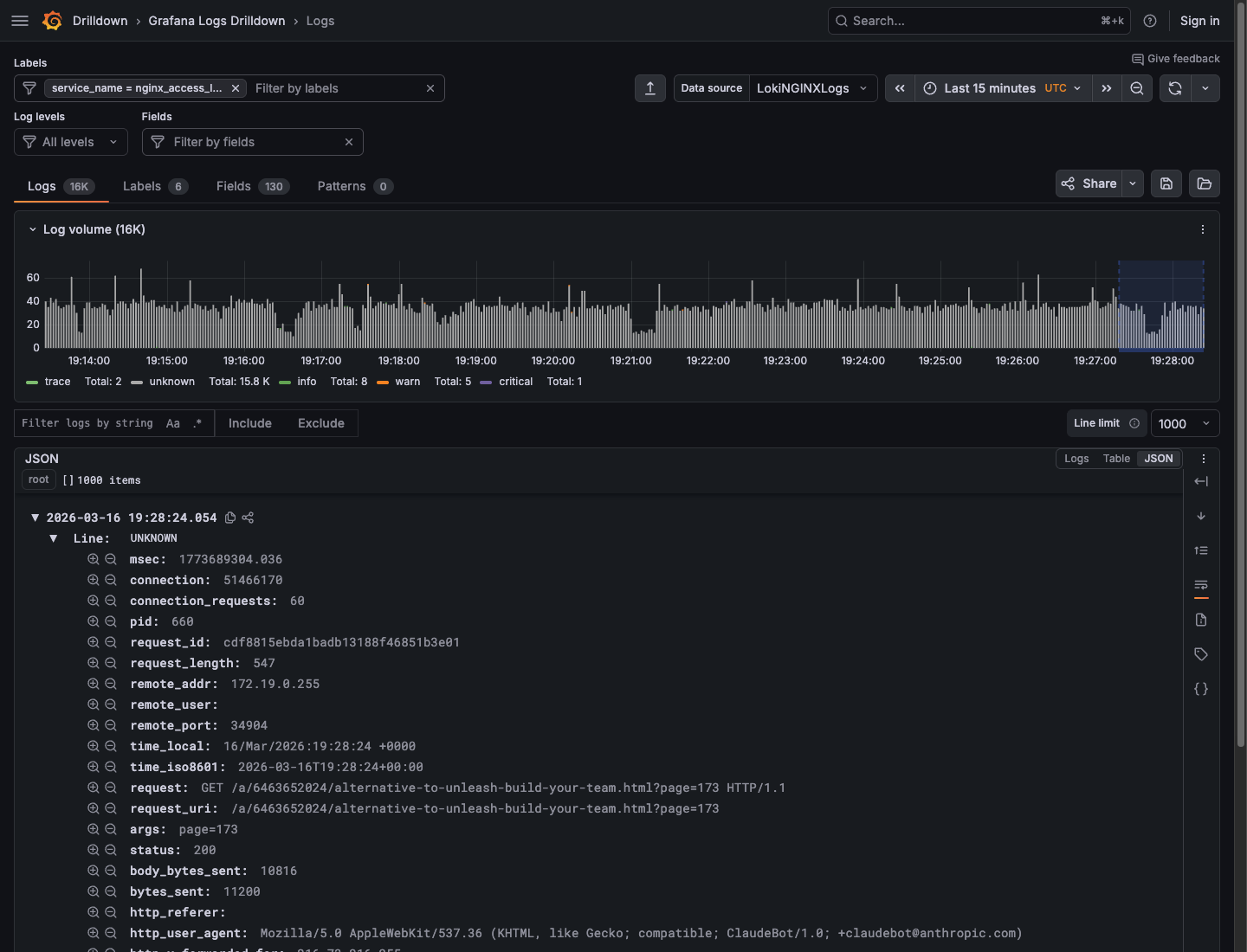

From there, select JSON in the Logs format menu. This will show your logs in a structured, collapsible way, enabling you to sort, filter, and otherwise adjust your log data in the visualizations for your logs.
Show Logs button on a JSON logging service
The JSON viewer

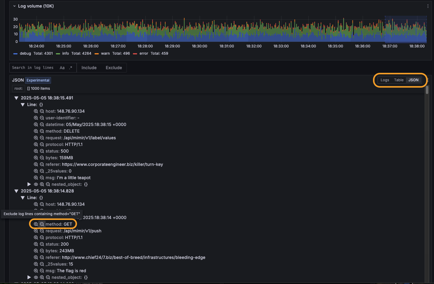

Filtering log lines with the JSON view
You can include and exclude specific log data from your visualizations by selecting the Include/Exclude icons next to a given label.
For example: Given a set of logs from am API request service, you can select the Exclude button next the method field with status “GET”. This will result in the Log Volume visualization showing only requests of other method types (DELETE/PATCH/POST/PUT).
To include filtered log data again, remove the excluded data from the Fields filter above the Logs Volume visualization.
