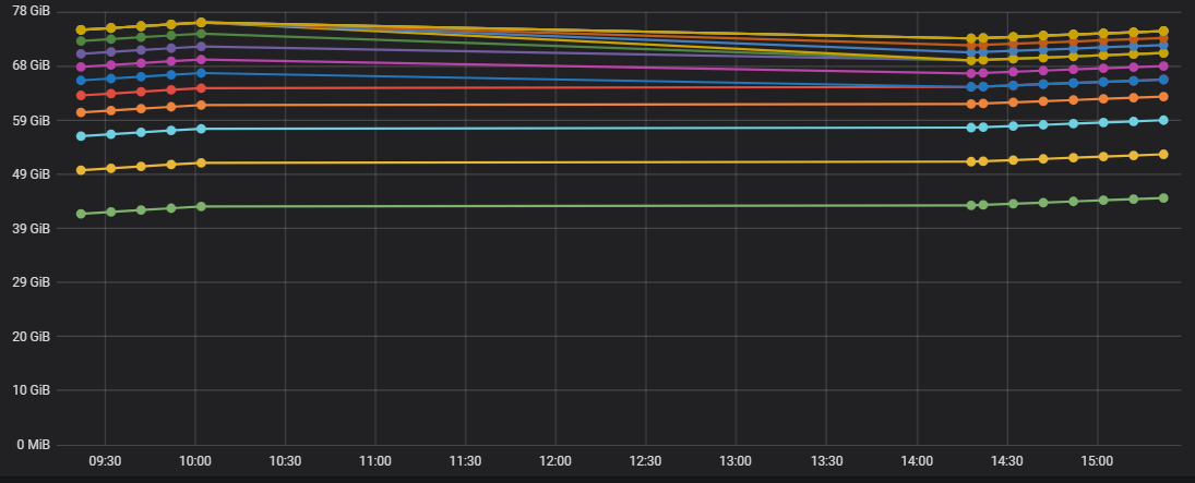

Handling or rendering null data is wrong or confusing
Some applications publish data intermittently; for example, they only post a metric when an event occurs. By default, Grafana graphs connect lines between the data points, but this can be deceptive.
The graph in the following image has:
  • Points and 3-point radius enabled to highlight where data points are actually present.
  • Connect null values set to Always.
Graph with null values connected

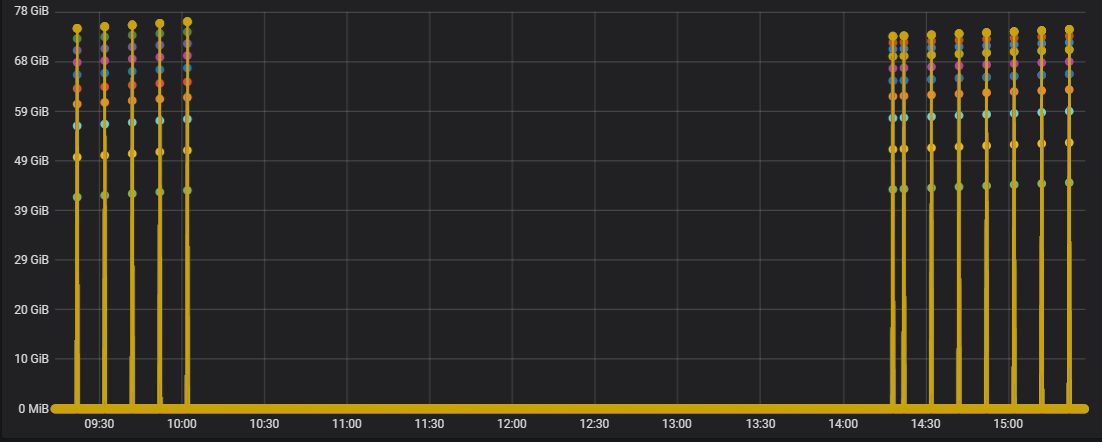

The graph in this next image shows bars instead of lines and has the No value option under Standard options set to 0.
Graph with null values not connected
As you can see, there’s a significant difference in the visualizations.
