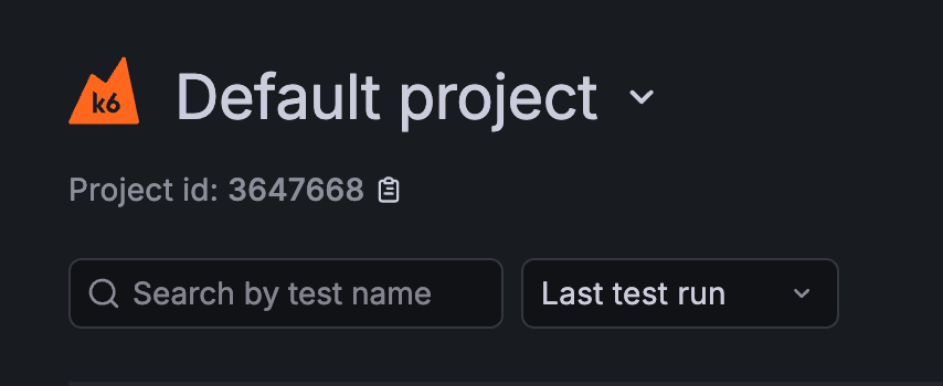

By default, when you run a test from the CLI, the test runs in your default project. To create and run tests in a specific project, you can set the Project ID when running your script.
In Grafana Cloud, you can find the Project ID value below the project name on the project view:
k6 Project ID
You can pass the Project ID to k6 in two ways:
