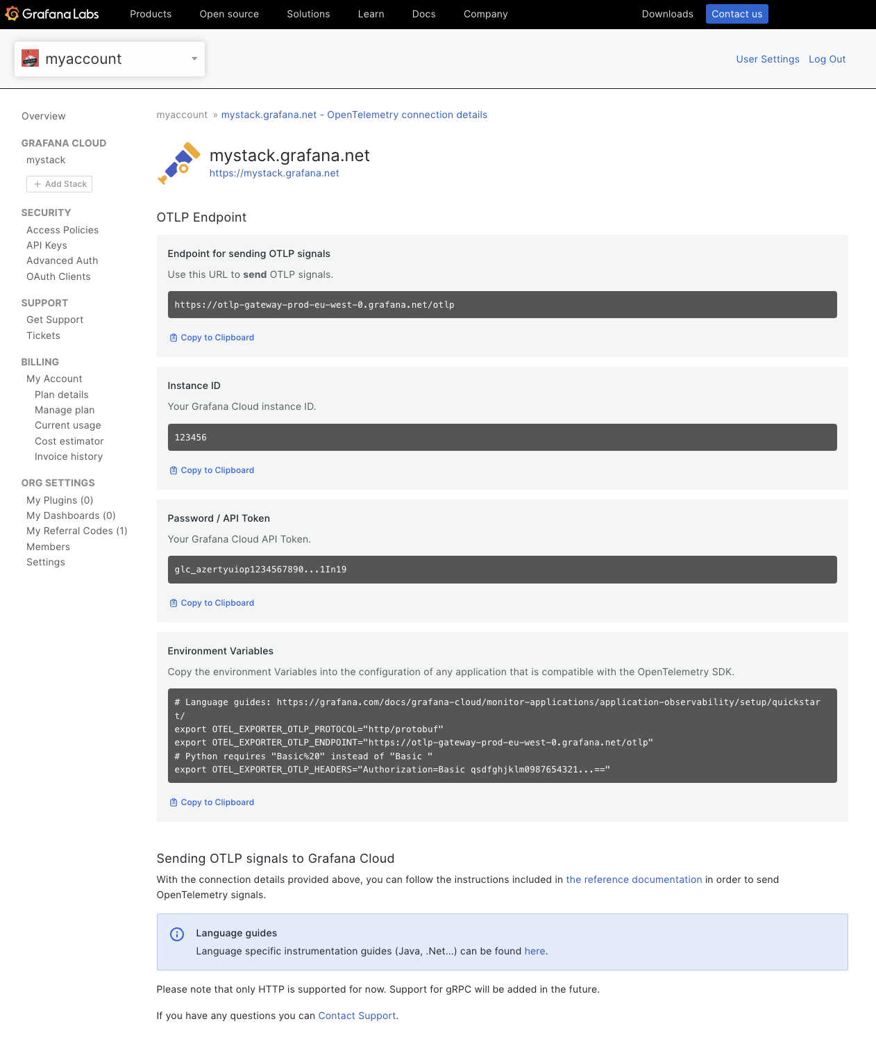

  • Open the Cloud Portal, and click Configure on the OpenTelemetry card. Make a note of the following values associated with your instance:
    • Instance ID (e.g. 130834)
    • OTLP Endpoint URL (e.g. https://otlp-gateway-prod-us-central-0.grafana.net/otlp)
Examples in this topic
The examples in this topic are based on the following Grafana Cloud instance.
OpenTelemetry connection details example

The following sample shows how to add the otlphttp exporter to the collector. Using the example image above, the instanceID is 130834 and the endpoint is https://otlp-gateway-prod-us-central-0.grafana.net/otlp.

To automatically obtain those values, click on Generate Now in the Password / API Token section. As a result, the Environment Variable section will be populated with environment variables necessary to send data directly to Grafana Cloud.
OpenTelemetry OTLP Environment Variables
