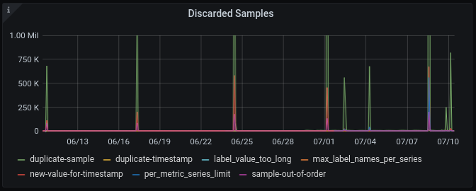

Billing and Usage dashboard
The bottom-right graph shows Discarded Samples aggregated by reason. It queries the metric grafanacloud_instance_samples_discarded from the grafanacloud-usage data source.
A Grafana panel showing discarded samples over time, aggregated by reason.
This graph can help you detect problems, but sometimes you need to investigate further to locate the source of an issue. For example, the dashboard doesn’t show series reporting 0 discarded samples. To learn more about the reasons for discarded samples, refer to Ingest problems.
If you are hitting rate limits or number limits, contact Grafana Labs support.

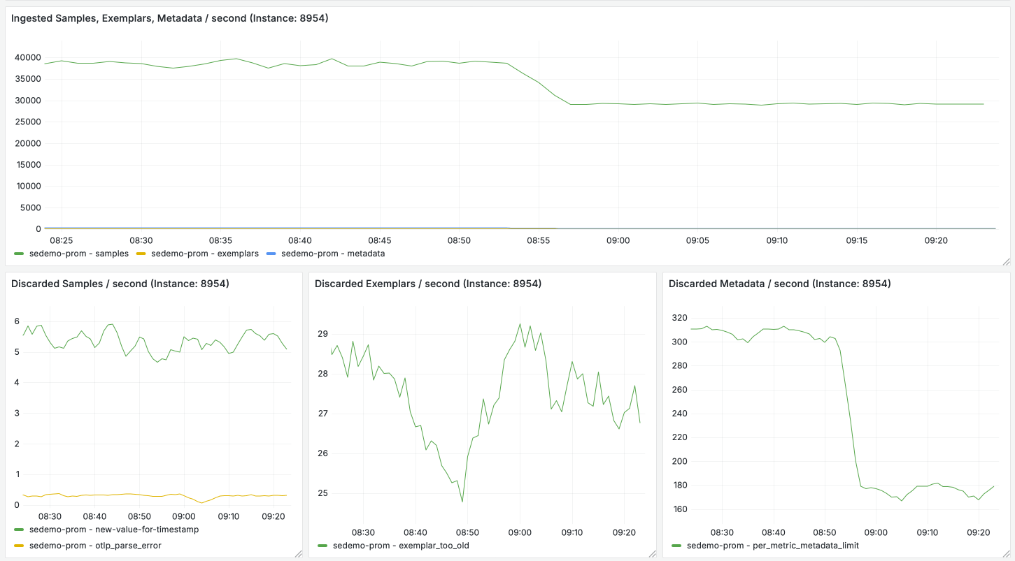

Metrics Ingestion dashboard
The Metrics Ingestion dashboard shows you the rate of successful sample ingestion as well as the rate of samples discarded due to ingestion failures. It also surfaces error messages to help you understand which samples are failing to be ingested and why.
It uses following metrics from the grafanacloud-usage data source:
  • Ingested samples: grafanacloud_instance_samples_per_second
  • Discarded samples: grafanacloud_instance_samples_discarded_per_second
  • Ingested exemplars: grafanacloud_instance_exemplars_per_second
  • Discarded exemplars: grafanacloud_instance_exemplars_discarded_per_second
  • Ingested metadata: grafanacloud_instance_metadata_per_second
  • Discarded metadata: grafanacloud_instance_metadata_discarded_per_second
The dashboard showing with four panels. One panel shows the combined ingestion rate of samples, metadata, and exemplars. The three panels below show the discarded rate for each of them.
The Ingestion Error Details panel shows error messages for failed ingestion, split by selected Hosted Metrics instance.
You can set up Grafana-managed alerts to query these metrics from the grafanacloud-usage and send yourself a notification when discard rate exceeds acceptable levels. Alerting on the condition below notifies you if some of your samples are being discarded because you’ve exceeded the number of active time series allowed in your Hosted Metrics instance.
grafanacloud_instance_samples_discarded_per_second{reason="per_user_series_limit"} > 0
If you are using Adaptive Metrics, you may also want to alert on the following condition. This notifies you that some of your samples are being discarded because you’re sending too many samples to Adaptive Metrics for aggregation.
grafanacloud_instance_samples_discarded_per_second{reason=~"aggregator-too-many-raw-series|aggregator-too-many-aggregated-series"} > 0
Grafana Cloud automatically scales up in response to increases in your traffic, but this scaling happens gradually. If you’re seeing a high volume of samples continue to be discarded due to the per_user_series_limit, aggregator-too-many-raw-series, and aggregator-too-many-aggregated-series reasons please contact Support.
