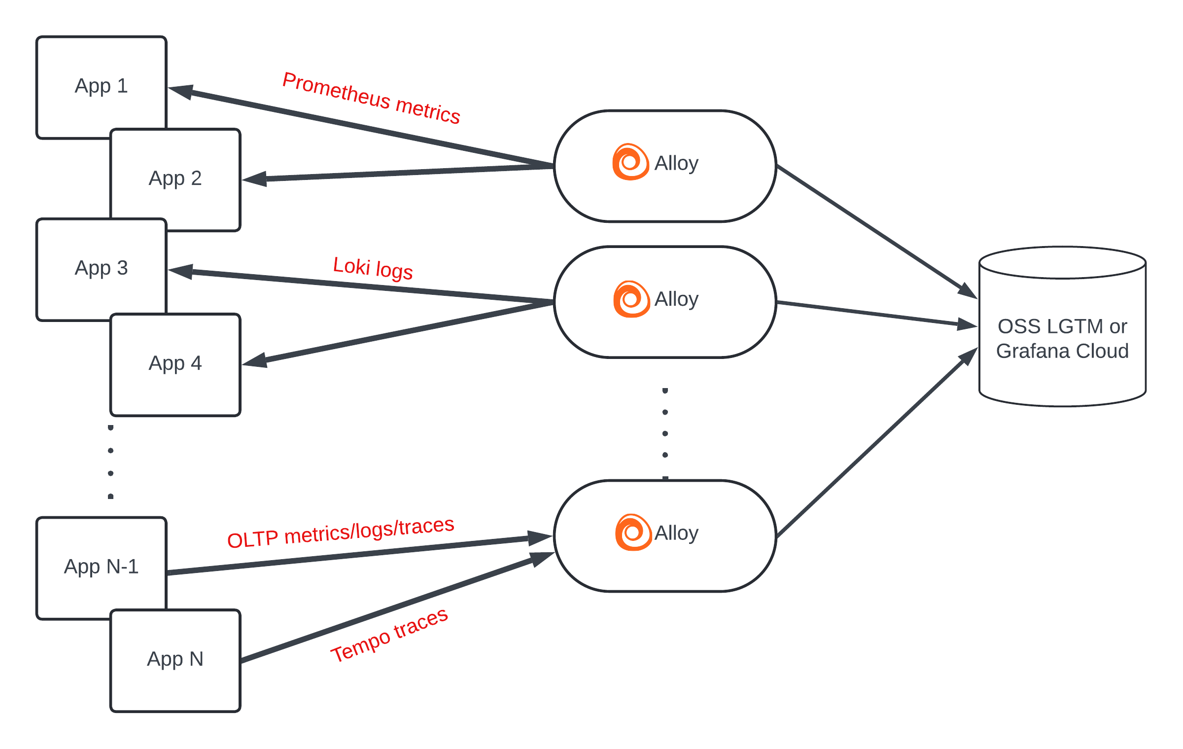

As a centralized collection service
Deploying Alloy as a centralized service is recommended for collecting application telemetry. This topology allows you to use a smaller number of collectors to coordinate service discovery, collection, and remote writing.
Centralized collection with Alloy
Using this topology requires deploying Alloy on separate infrastructure, and making sure that they can discover and reach these applications over the network. The main predictor for the size of an Alloy deployment is the number of active Prometheus metrics series it’s scraping. A rule of thumb is approximately 10 KB of memory for each series. We recommend you start looking towards horizontal scaling around the 1 million active series mark.

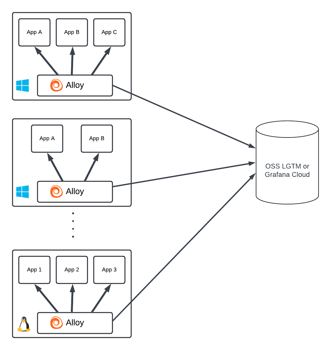

As a host daemon
Deploying one Alloy instance per machine is required for collecting machine-level Prometheus metrics and logs, such as node_exporter hardware and network metrics or journald system logs.
Alloy as a host daemon
Each Alloy instance requires you to open an outgoing connection for each remote endpoint it’s shipping data to. This can lead to NAT port exhaustion on the egress infrastructure. Each egress IP can support up to (65535 - 1024 = 64511) outgoing connections on different ports. So, if all Alloys are sending Prometheus metrics and log data, an egress IP can support up to 32,255 collectors.
Use Kubernetes DaemonSets
The simplest use case of the host daemon topology is a Kubernetes DaemonSet, and it’s required for node-level observability (for example cAdvisor metrics) and collecting Pod logs.

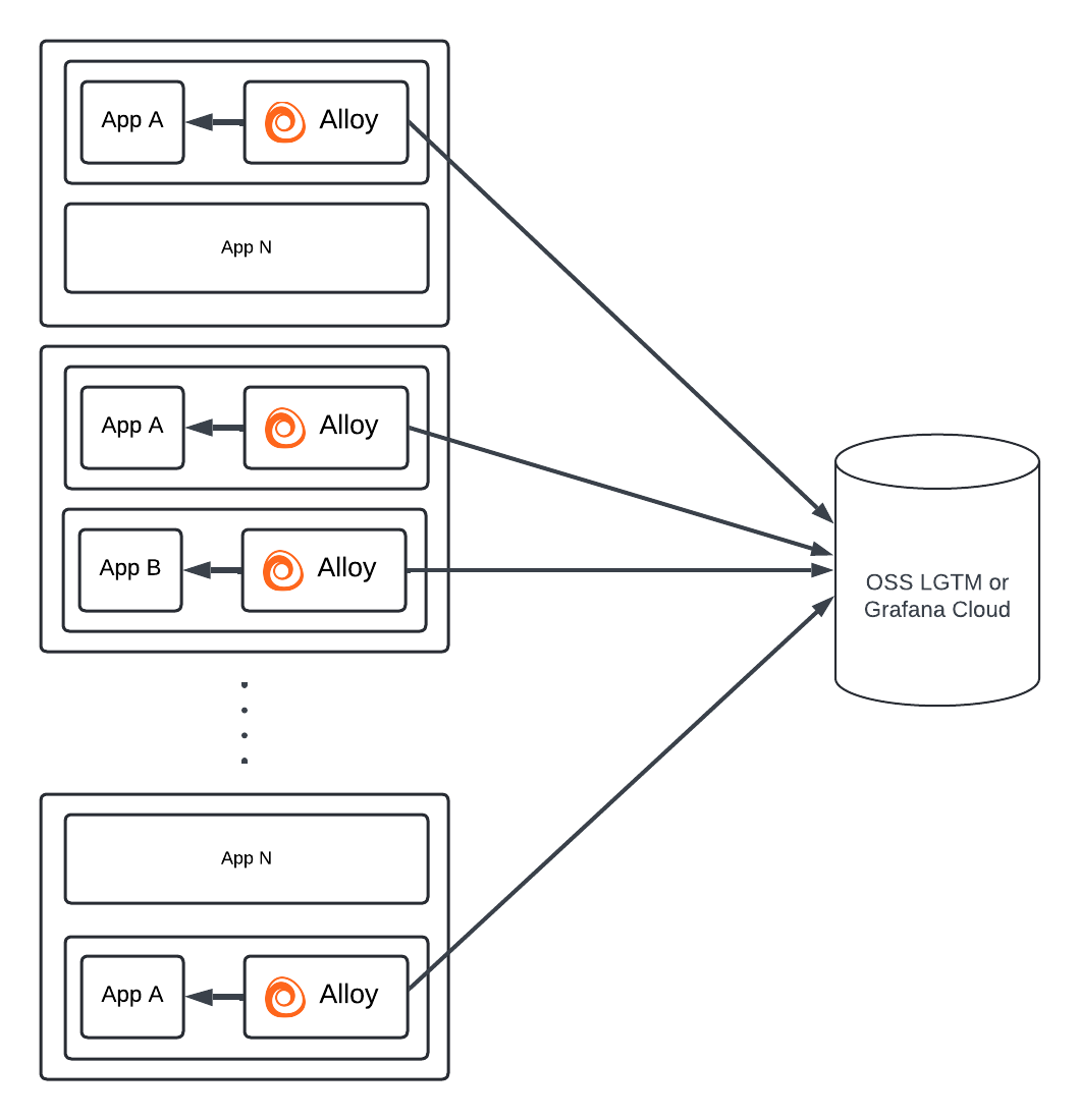

As a container sidecar
Deploying Alloy as a container sidecar is only recommended for short-lived applications or specialized Alloy deployments.
Use Kubernetes Pod sidecars
In a Kubernetes environment, the sidecar model consists of deploying Alloy as an extra container on the Pod. The Pod’s controller, network configuration, enabled capabilities, and available resources are shared between the actual application and the sidecar Alloy.

Process different types of telemetry in different Alloy instances
If the load on Alloy is small, you can process all necessary telemetry signals in the same Alloy process. For example, a single Alloy deployment can process all of the incoming metrics, logs, traces, and profiles.
However, if the load on Alloy is big, it may be beneficial to process different telemetry signals in different deployments of Alloy.
This provides better stability due to the isolation between processes. For example, an overloaded Alloy instance processing traces won’t impact an Alloy instance processing metrics. Different types of signal collection require different methods for scaling:
  • “Pull” components such as prometheus.scrape and pyroscope.scrape are scaled using hashmod sharing or clustering.
  • “Push” components such as otelcol.receiver.otlp are scaled by placing a load balancer in front of the components.
