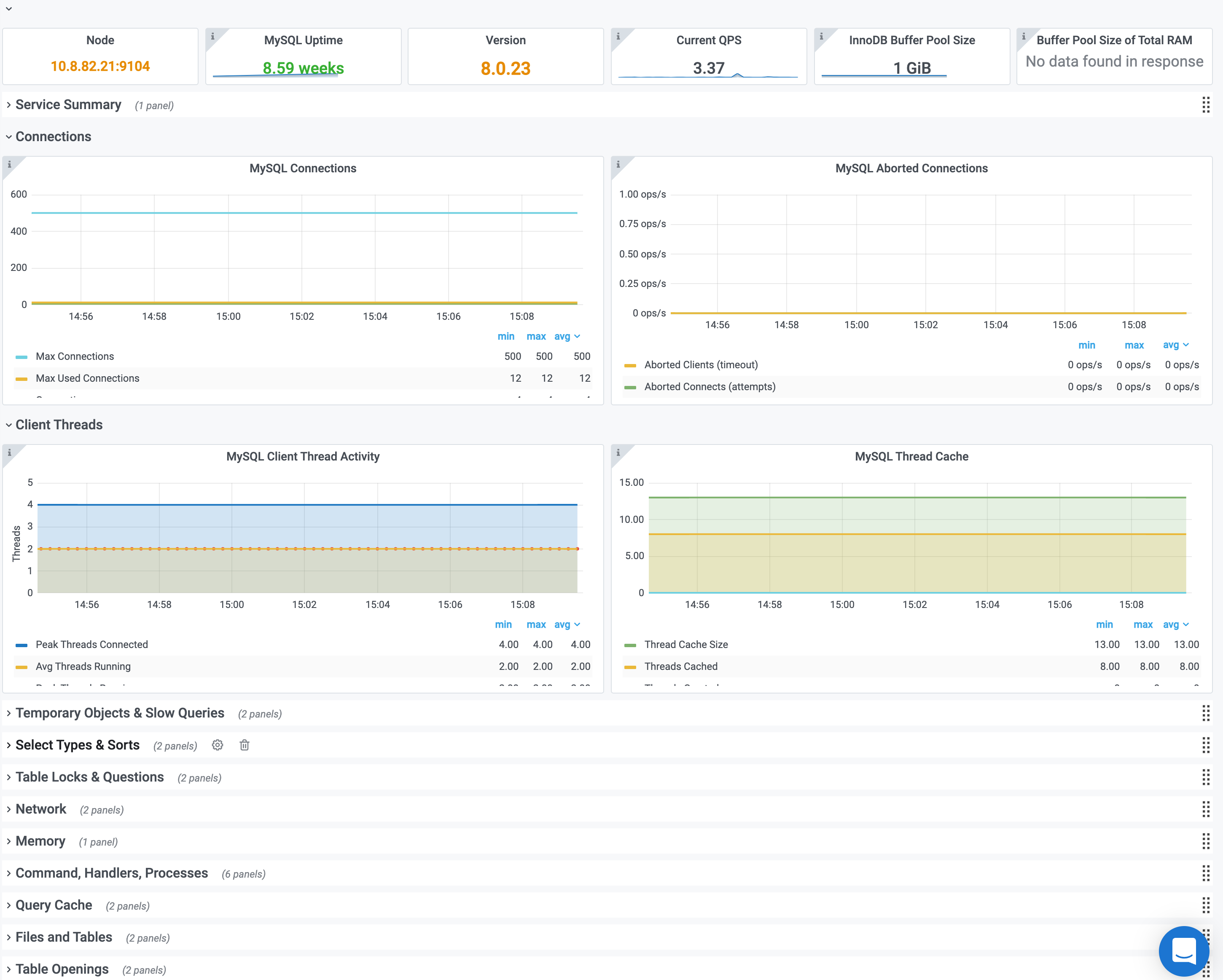

Dashboards
The following MySQL dashboard shows summary level metrics.
MySQL dashboard

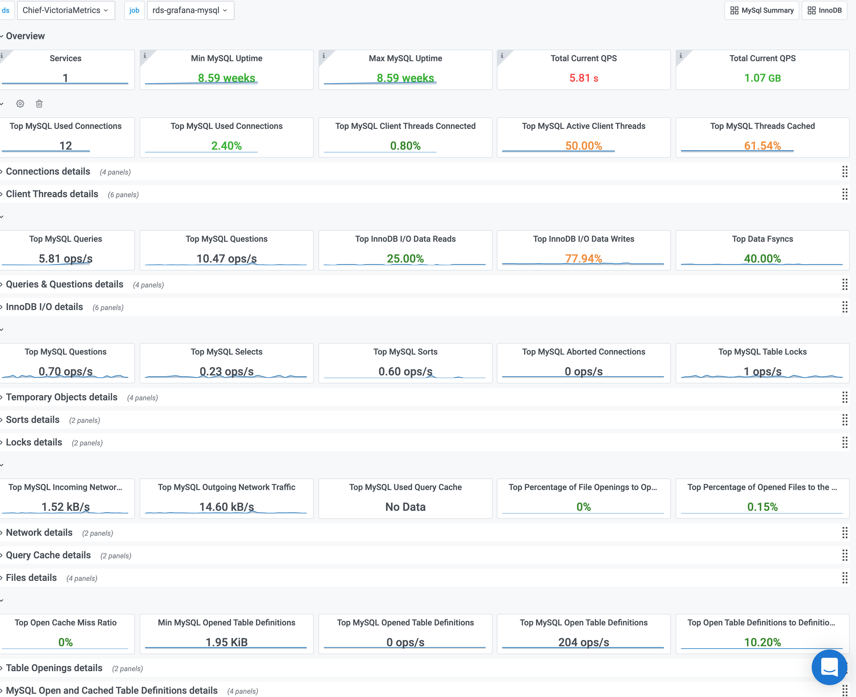

The following dashboard shows additional metric details.
MySQL details

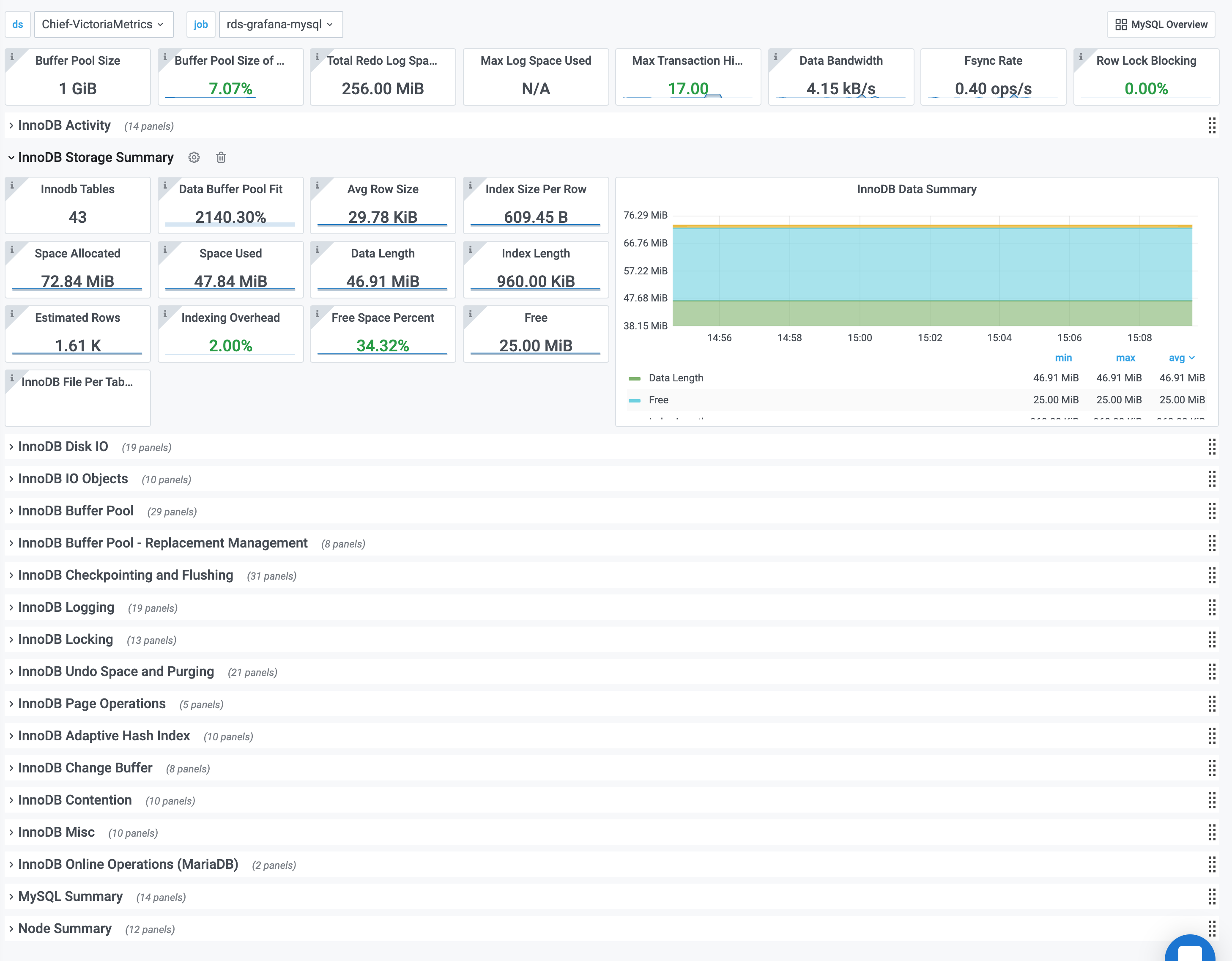

The following dashboard shows InnoDB metrics.
InnoDB metrics
