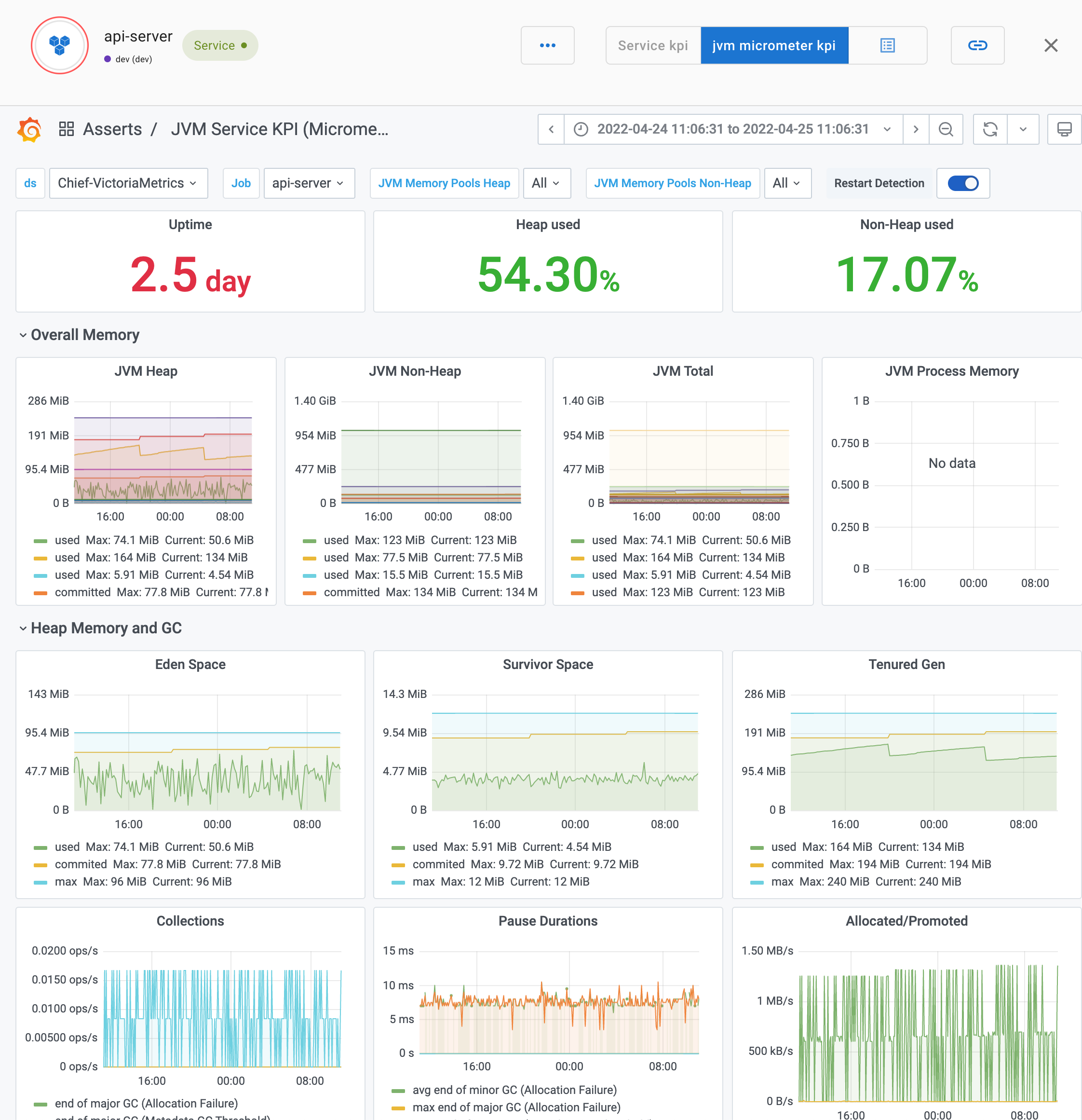

JVM Micrometer KPI dashboard
The JVM Micrometer KPI dashboard includes the following KPIs:
  • JVM memory
  • CPU-Usage, Load, Threads, Thread States, File Descriptors, Log Events
  • JVM Memory Pools (Heap, Non-Heap)
  • Garbage Collection
  • Classloading
  • Direct-/Mapped-Buffer
JVM Micrometer KPI Dashboard
