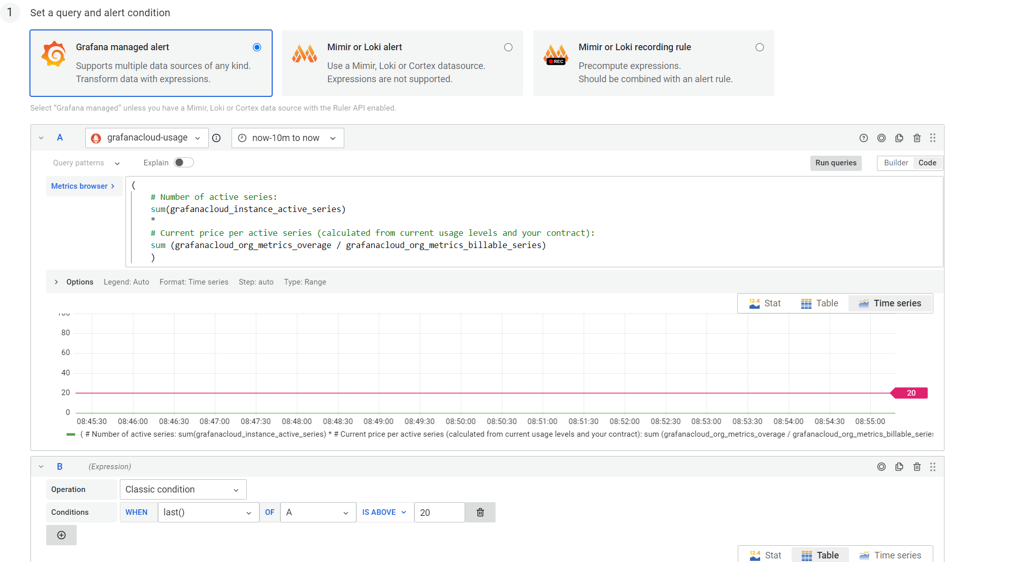

  3. Select Grafana managed alert.
  4. In query panel A, select grafanacloud-usage from the data source dropdown menu.
  5. Select the Code option in the upper-right corner of the panel.
  6. Enter the following query:
    promql
    # Number of active series:
    sum(grafanacloud_instance_active_series)
    # Current price per billable-series (calculated from current usage levels and your contract):
    sum (grafanacloud_org_metrics_overage) / sum (grafanacloud_org_metrics_billable_series)
  7. Run the query if it hasn’t run yet; click Run queries.
  8. Set your budget threshold by dragging the red tab at the right of the graph, or by setting an IS ABOVE condition in the panel that has this threshold setting. This is probably panel B or C.

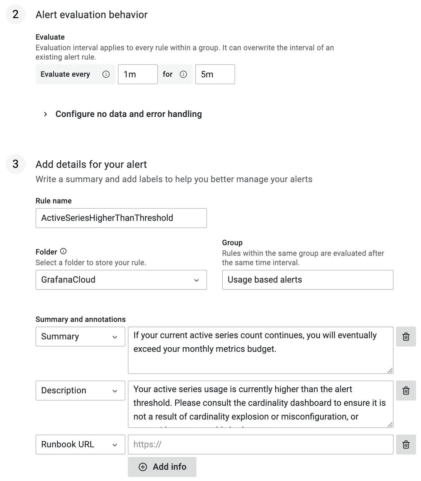

    Alert setup
    Alert setup
  9. Add optional descriptive details to your alert, for example:
    • Summary: If your current active series count continues, you will eventually exceed your monthly metrics budget.
    • Description: Your active series usage is currently higher than the alert threshold. Consult the cardinality dashboard to ensure it is not a result of high cardinality or a misconfiguration, or reconsider your monthly budget.
      Alert details
      Alert details
