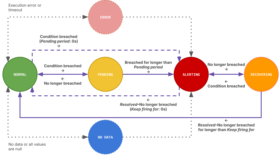

Alert instance states
A Grafana-managed alert instance can be in any of the following states, depending on the outcome of the alert rule evaluation:
| State | Description |
| Normal | The state of an alert when the condition (threshold) is not met. |
| Pending | The state of an alert that has breached the threshold but for less than the pending period. |
| Alerting | The state of an alert that has breached the threshold for longer than the pending period. |
| Recovering | The state of a firing alert when the threshold is no longer breached, but for less than the keep firing for period. |
| Error* | The state of an alert when an error or timeout occurred evaluating the alert rule. You can customize the behavior of the Error state, which by default triggers a different alert.  |
| No Data* | The state of an alert whose query returns no data or all values are null. You can customize the behavior of the No Data state, which by default triggers a different alert.  |

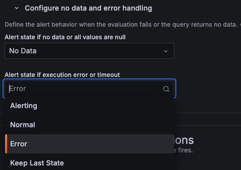

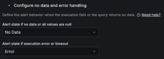

Modify the No Data or Error state
These states are supported only for Grafana-managed alert rules.
In Configure no data and error handling, you can change the default behavior when the evaluation returns no data or an error. You can set the alert instance state to Alerting, Normal, Error, or Keep Last State.
| Configure | Set alert state | Description |
| No Data | No Data | The default option for No Data events. Sets alert instance state to No Data.The alert rule immediately creates a new DatasourceNoData alert instance after evaluation, with the alert rule’s name, UID, and the data source UID as labels. |
| Error | Error | The default option for Error events. Sets alert instance state to Error.The alert rule immediately creates a new DatasourceError alert instance after evaluation, with the alert rule’s name, UID, and the data source UID as labels. |
| No Data or Error | Alerting | Sets the alert instance state to Pending and then transitions to Alerting once the pending period ends. If you sent the pending period to 0, the alert instance state is immediately set to Alerting. |
| No Data or Error | Normal | Sets alert instance state to Normal. |
| No Data or Error | Keep Last State | Maintains the alert instance in its last state. Useful for mitigating temporary issues. |
Note that when you configure the No Data or Error behavior to Alerting or Normal, Grafana attempts to keep a stable set of fields under notification Values. If your query returns no data or an error, Grafana re-uses the latest known set of fields in Values, but will use -1 in place of the measured value.
