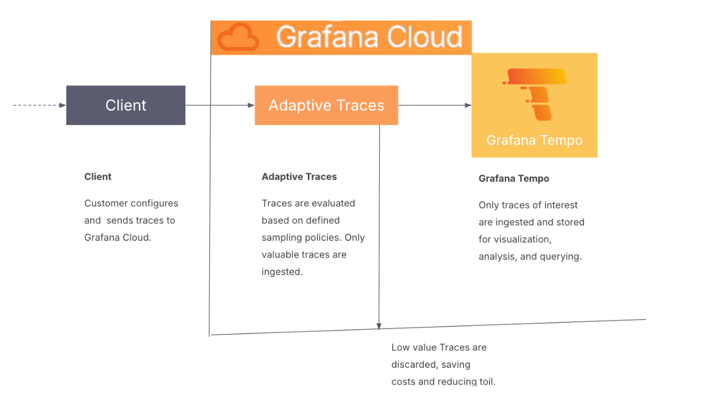

How it works at a glance
The following diagram gives you an overview of Adaptive Traces and introduces you to some of the fundamental features that are the principles of how Adaptive Traces works.
An image showing how Adaptive Traces works.
  • Adaptive Traces performs what’s referred to as tail sampling, where the decision to sample a trace takes place by considering all or most of the spans within the trace. This sampling method gives you the option to filter your traces based on specific criteria.
  • Sampling policies define a set of criteria that evaluates traces and decides which to keep (sample) or not keep (not sampled, or drop).
  • Each policy has a type which specifies what information (for example, latency, string attribute) or condition (for example, percentage) is used for evaluation.
