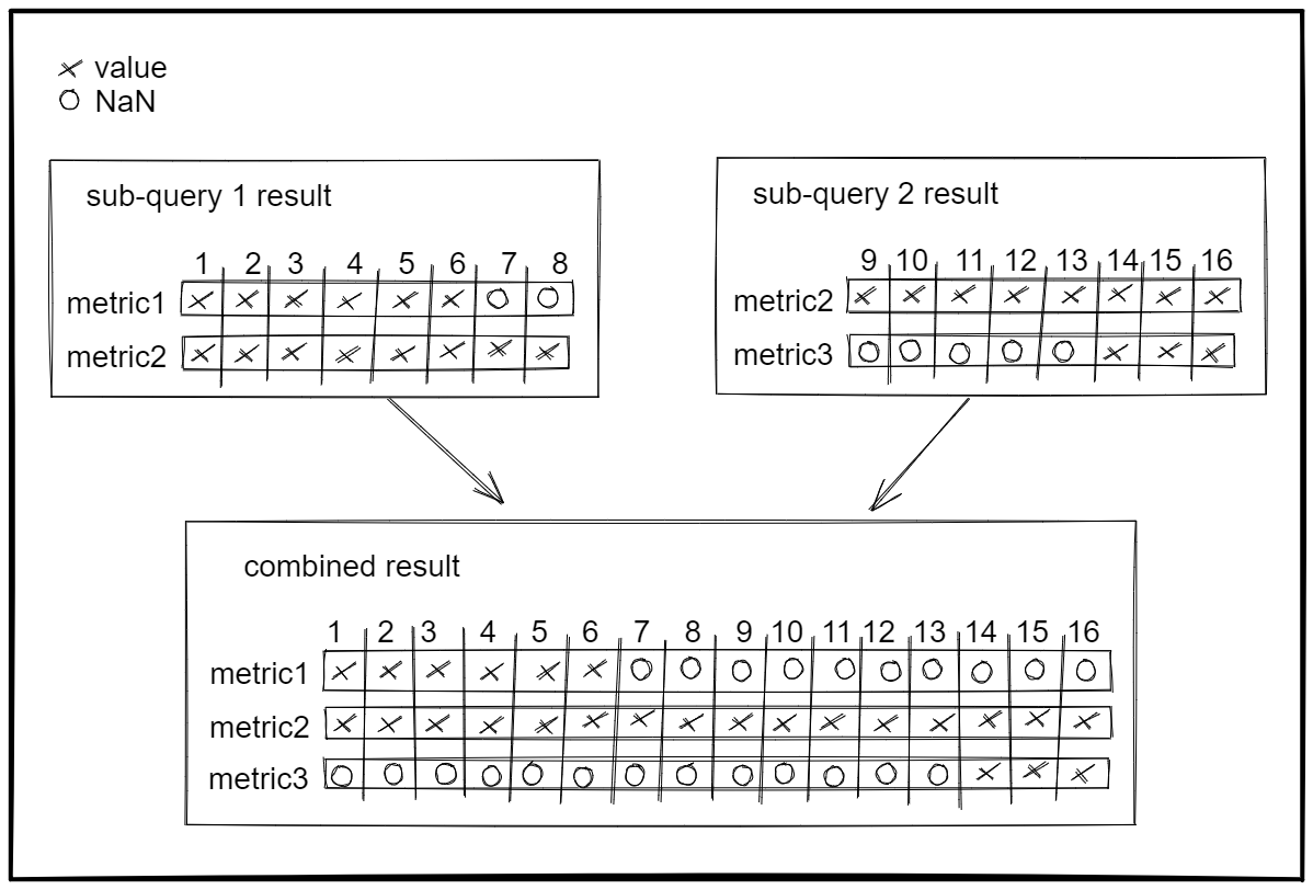

Each sub-query returns a set of metrics that has been aligned and aggregated to the correct interval, now the results of the different sub-queries get combined into one set of metrics.
If a sub-query result contains a metric which is not present in another sub-query result then the gap is filled with NaN.
Concatenating sub-query results
At this point it is possible that the same metric has been aggregated to different intervals in the different sub-queries, because if one sub-query resulted in a larger number of metrics than another then its retention might have been bumped to fit the number of points generated by the sub-query into its soft budget In this situation the sub-query results with the lower interval get aggregated to match the interval of the sub-query result with the higher interval, because the Graphite query engines require each metric to have a constant interval.
The result after combining the sub-query results is one set of metrics, where each metric is guaranteed to have a consistent interval and each metric has data points filling the entire queried time range because all gaps have been filled with NaN values.

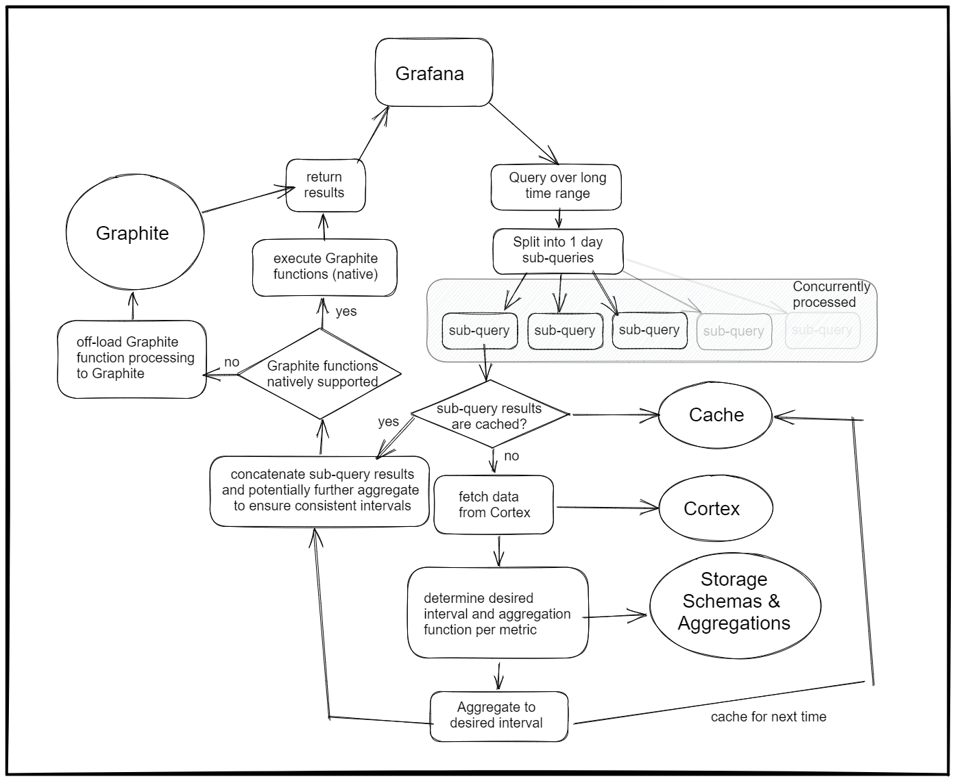

Illustration
This is an illustration of the above described query handling process:
Graphite query processing

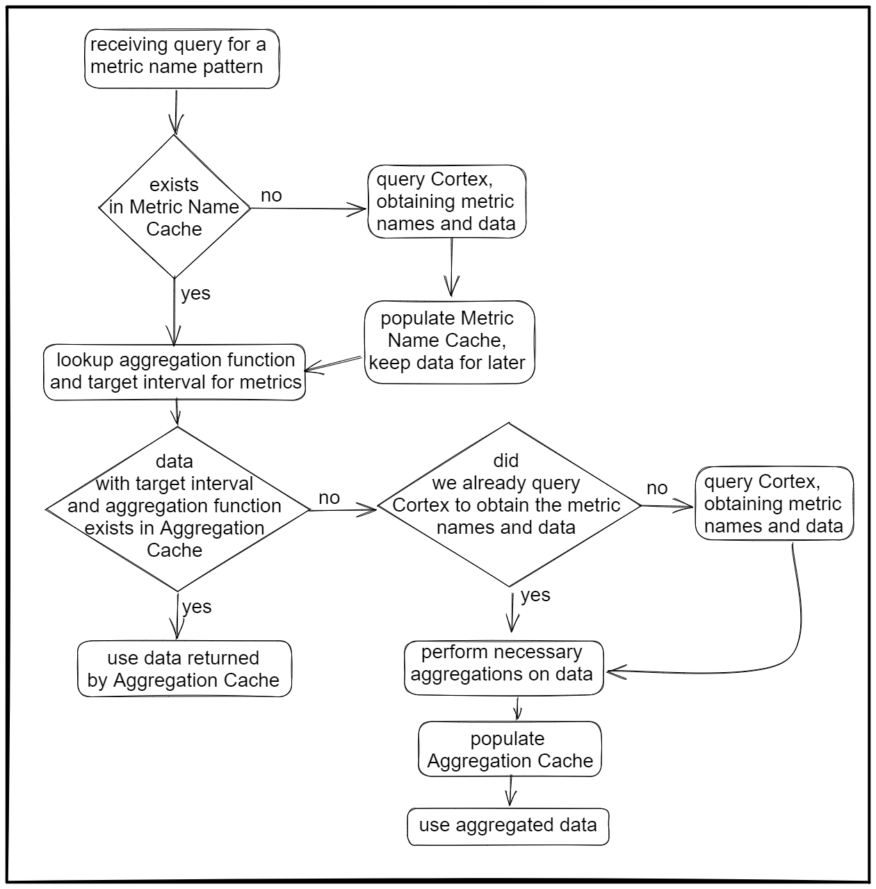

Cache usage
This illustrates the flow how these two caches are used in the query handling process. cache usage flow
