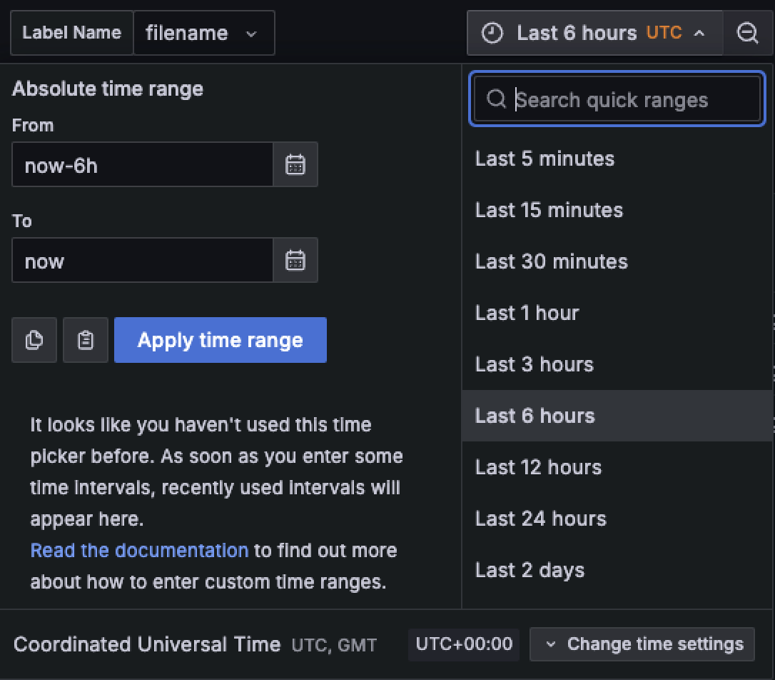

In Grafana
If you’re using Loki with Grafana, you can use the dropdown menu on the upper right hand corner of a dashboard to select a time range, either relative (last X hours) or absolute (a specific date and time).
