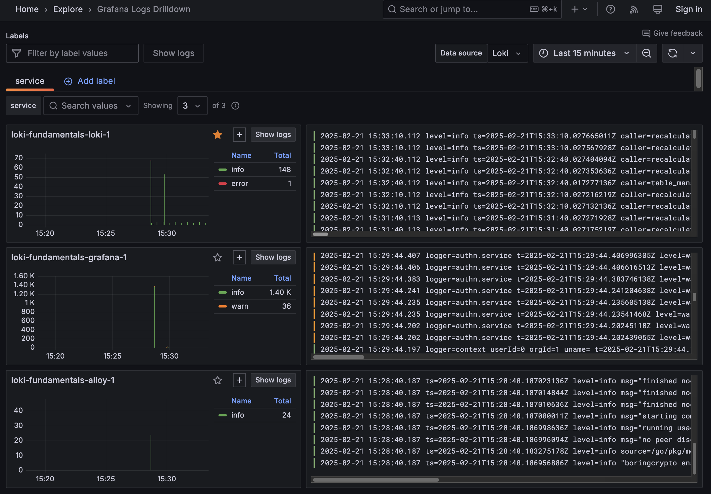

  4. With the Loki stack running, you can now verify each component is up and running:

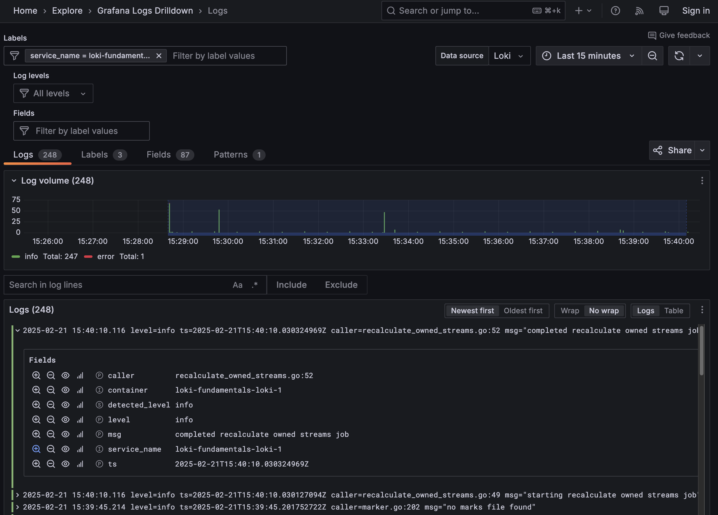

Since Grafana Alloy is configured to tail logs from all Docker containers, Loki should already be receiving logs. The best place to verify log collection is using the Grafana Logs Drilldown feature. To do this, navigate to http://localhost:3000/drilldown. Select Logs. You should see the Grafana Logs Drilldown page.
If you have only the getting started demo deployed in your Docker environment, you should see three containers and their logs; loki-fundamentals-alloy-1, loki-fundamentals-grafana-1 and loki-fundamentals-loki-1. In the loki-fundamentals-loki-1 container, click Show Logs to drill down into the logs for that container.
Grafana Drilldown Service View
We will not cover the rest of the Grafana Logs Drilldown features in this quickstart guide. For more information on how to use the Grafana Logs Drilldown feature, refer to Get started with Grafana Logs Drilldown.

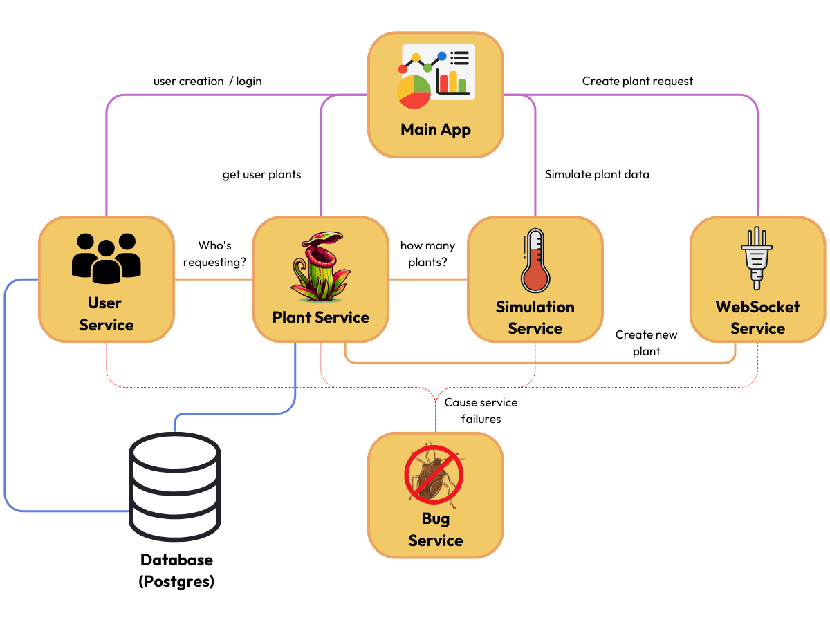

Collect logs from a sample application
Currently, the Loki stack is collecting logs about itself. To provide a more realistic example, you can deploy a sample application that generates logs. The sample application is called The Carnivorous Greenhouse, a microservices application that allows users to login and simulate a greenhouse with carnivorous plants to monitor. The application consists of seven services:
  • User Service: Manages user data and authentication for the application. Such as creating users and logging in.
  • Plant Service: Manages the creation of new plants and updates other services when a new plant is created.
  • Simulation Service: Generates sensor data for each plant.
  • WebSocket Service: Manages the websocket connections for the application.
  • Bug Service: A service that when enabled, randomly causes services to fail and generate additional logs.
  • Main App: The main application that ties all the services together.
  • Database: A PostgreSQL database that stores user and plant data.
The architecture of the application is shown below:
Sample Microservice Architecture

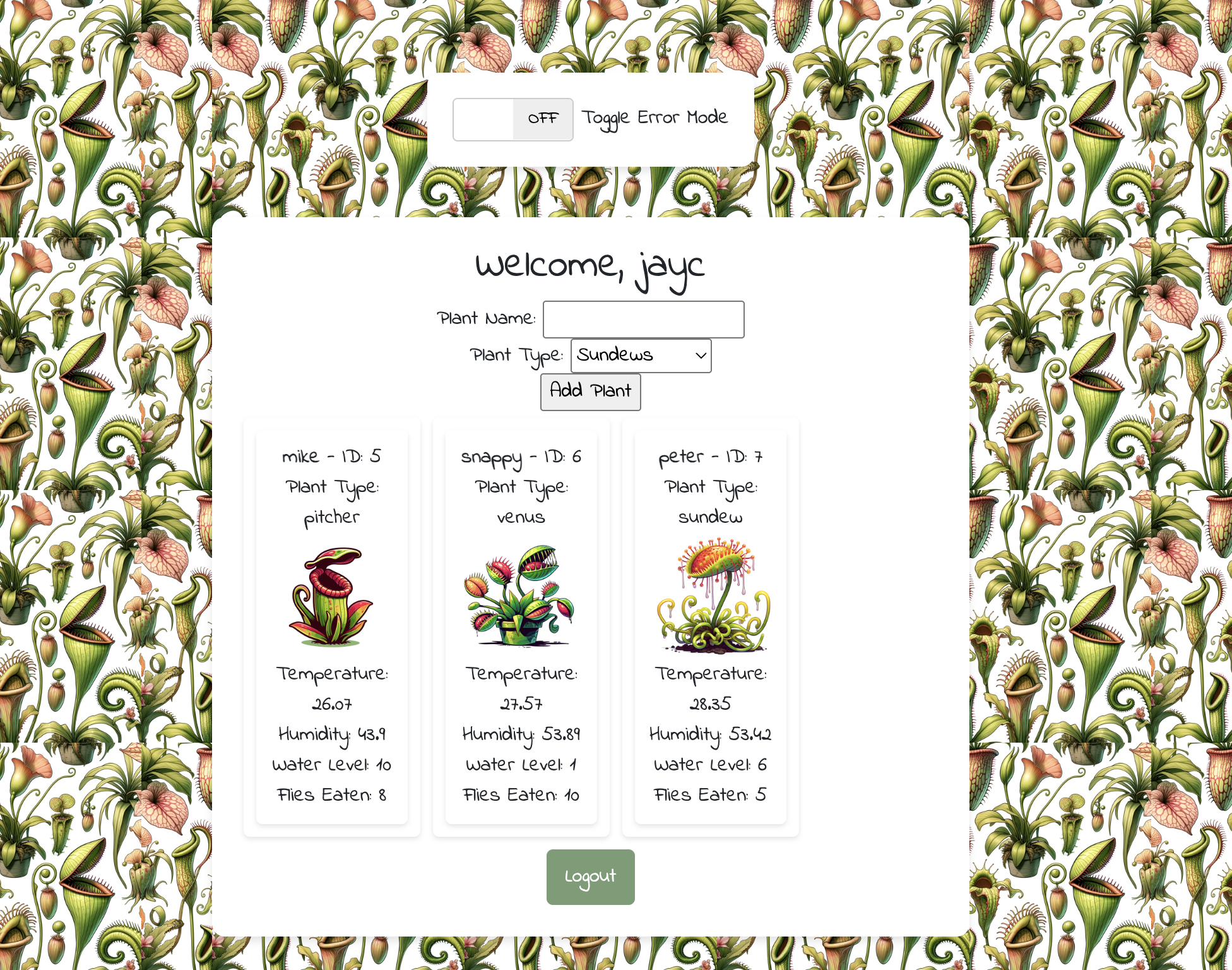

    Now that the sample application is running, run some actions in the application to generate logs. Here is a list of actions:
    1. Create a user: Click Sign Up and create a new user. Add a username and password and click Sign Up.
    2. Login: Use the username and password you created to login. Add the username and password and click Login.
    3. Create a plant: Once logged in, give your plant a name, select a plant type and click Add Plant. Do this a few times if you like.
Your greenhouse should look something like this:
Greenhouse Dashboard

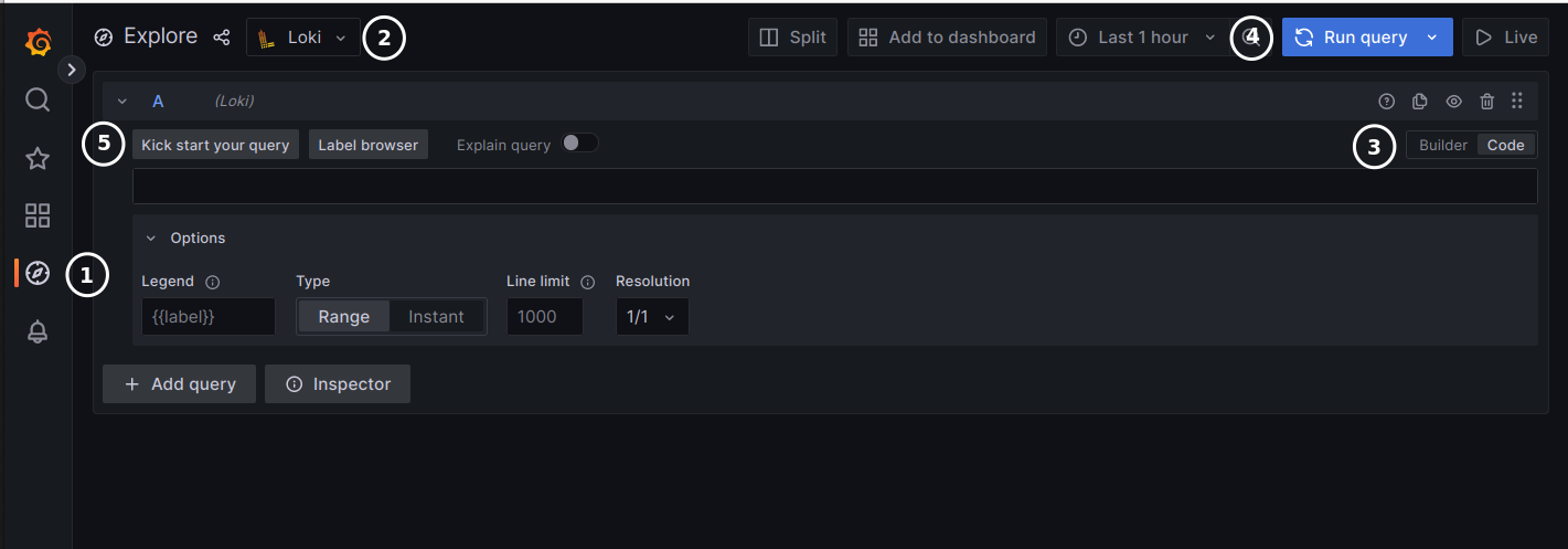

  1. Open a browser and navigate to http://localhost:3000 to open Grafana.
  2. From the Grafana main menu, click the Explore icon (1) to open the Explore tab.
    To learn more about Explore, refer to the Explore documentation.
    Grafana Explore
    Grafana Explore
  3. From the menu in the dashboard header, select the Loki data source (2).
    This displays the Loki query editor.
    In the query editor you use the Loki query language, LogQL, to query your logs. To learn more about the query editor, refer to the query editor documentation.
  4. The Loki query editor has two modes (3):
    • Builder mode, which provides a visual query designer.
    • Code mode, which provides a feature-rich editor for writing LogQL queries.
    Next we’ll walk through a few queries using the code view.
  5. Click Code (3) to work in Code mode in the query editor.

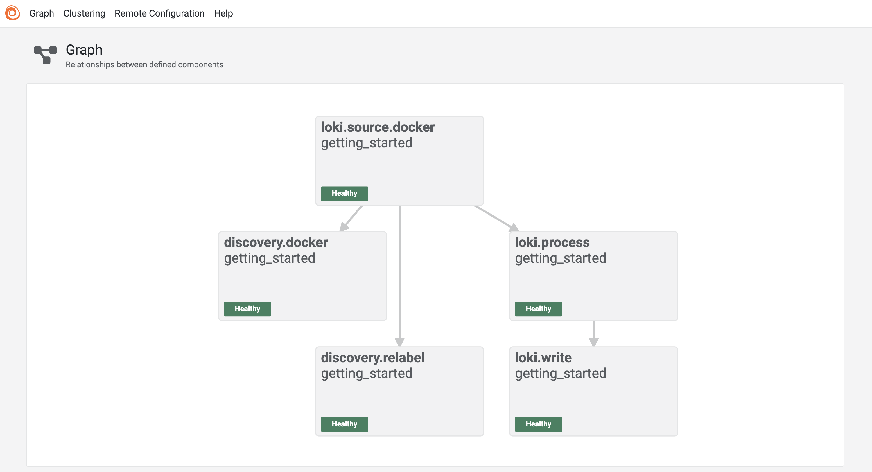

This configuration file can be viewed visually via the Alloy UI at http://localhost:12345/graph.
Alloy UI
Alloy UI
In this view you can see the components of the Alloy configuration file and how they are connected:
