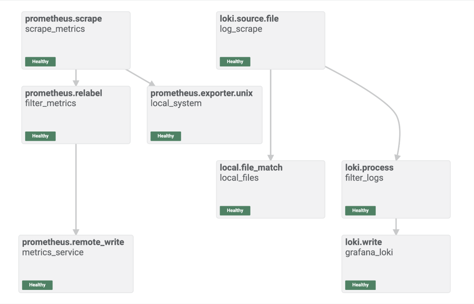

Inspect your configuration in the Alloy UI
Open http://localhost:12345 and click the Graph tab at the top. The graph should look similar to the following:
The Alloy UI shows you a visual representation of the pipeline you built with your Alloy component configuration.
You can see that the components are healthy, and you are ready to explore the metrics in Grafana.

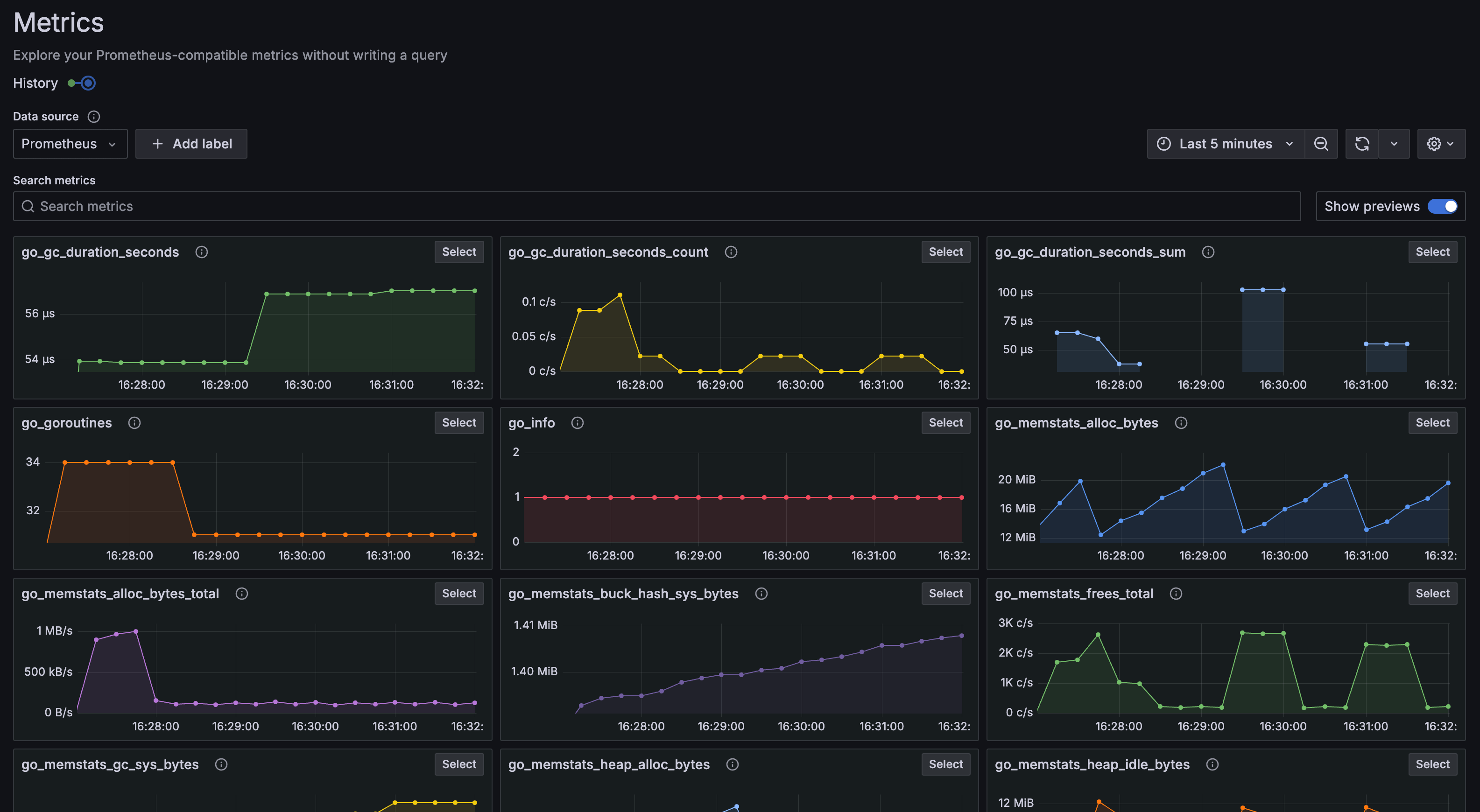

Log into Grafana and explore metrics in Prometheus
Open http://localhost:3000/explore/metrics/ to access the Metrics Drilldown feature in Grafana.
From here you can visually explore the metrics sent to Prometheus by Alloy.
You can also build PromQL queries manually to explore the data further.
Open http://localhost:3000/explore to access the Explore feature in Grafana.
Select Prometheus as the data source and click the Metrics Browser button to select the metric, labels, and values for your labels.
Here you can see that metrics are flowing through to Prometheus as expected, and the end-to-end configuration was successful.
