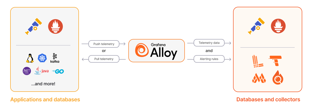

Grafana Alloy dynamically configures and connects components using the Alloy configuration syntax. Alloy collects, transforms, and delivers telemetry data. Each configuration component performs a specific task or defines data flow and component connections.
Alloy flow diagram
The following example demonstrates the basic concepts and how an Alloy configuration forms a pipeline.
