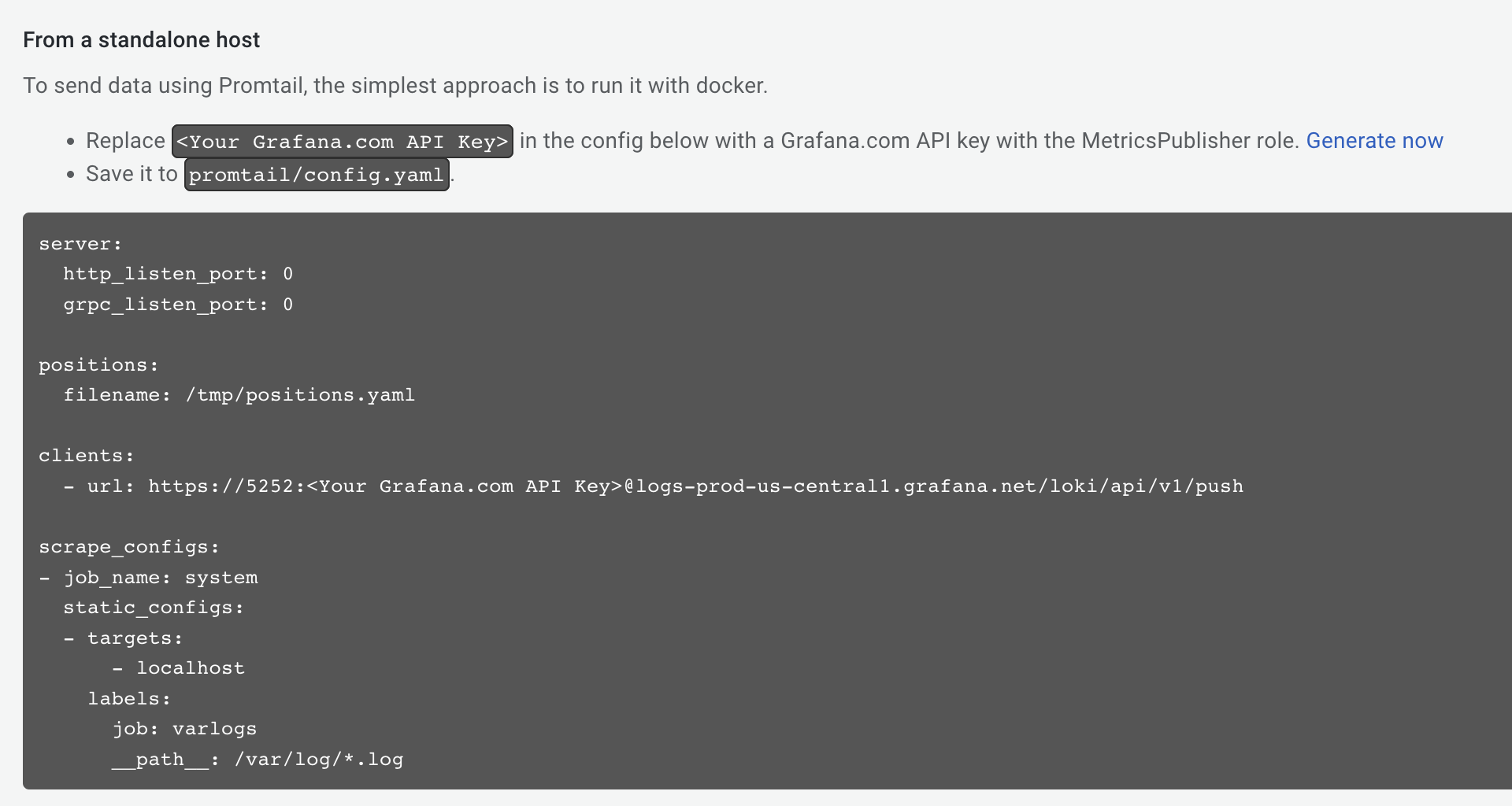

To use Loki with basic-auth, which is required with Grafana Cloud Loki, you must configure the loki.write component. You can get the Loki configuration from the Loki Details page in the Grafana Cloud Portal:
river
otelcol.exporter.loki "grafana_cloud_loki" {
	forward_to = [loki.write.grafana_cloud_loki.receiver]
loki.write "grafana_cloud_loki" {
	endpoint {
		url = "https://logs-prod-us-central1.grafana.net/loki/api/v1/push"
		basic_auth {
			username = 5252
			password = env("GRAFANA_CLOUD_API_KEY")

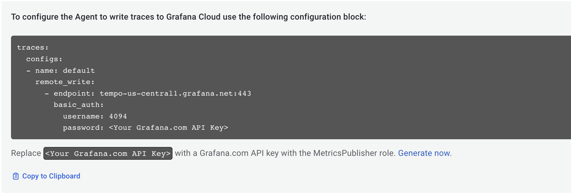

To use Tempo with basic-auth, which is required with Grafana Cloud Tempo, you must use the otelcol.auth.basic component. You can get the Tempo configuration from the Tempo Details page in the Grafana Cloud Portal:
river
otelcol.exporter.otlp "grafana_cloud_tempo" {
	client {
		endpoint = "tempo-us-central1.grafana.net:443"
		auth     = otelcol.auth.basic.grafana_cloud_tempo.handler
otelcol.auth.basic "grafana_cloud_tempo" {
	username = 4094

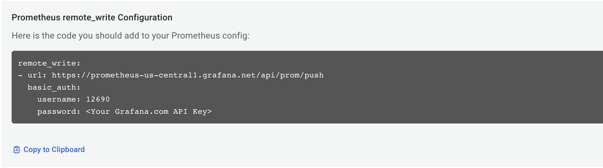

To use Prometheus with basic-auth, which is required with Grafana Cloud Prometheus, you must configure the prometheus.remote_write component. You can get the Prometheus configuration from the Prometheus Details page in the Grafana Cloud Portal:
river
otelcol.exporter.prometheus "grafana_cloud_prometheus" {
        forward_to = [prometheus.remote_write.grafana_cloud_prometheus.receiver]
prometheus.remote_write "grafana_cloud_prometheus" {
    endpoint {
        url = "https://prometheus-us-central1.grafana.net/api/prom/push"
        basic_auth {
            username = 12690

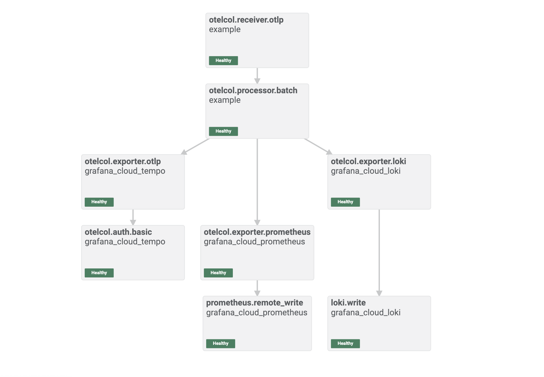

You can now check the pipeline graphically by visiting http://localhost:12345/graph
