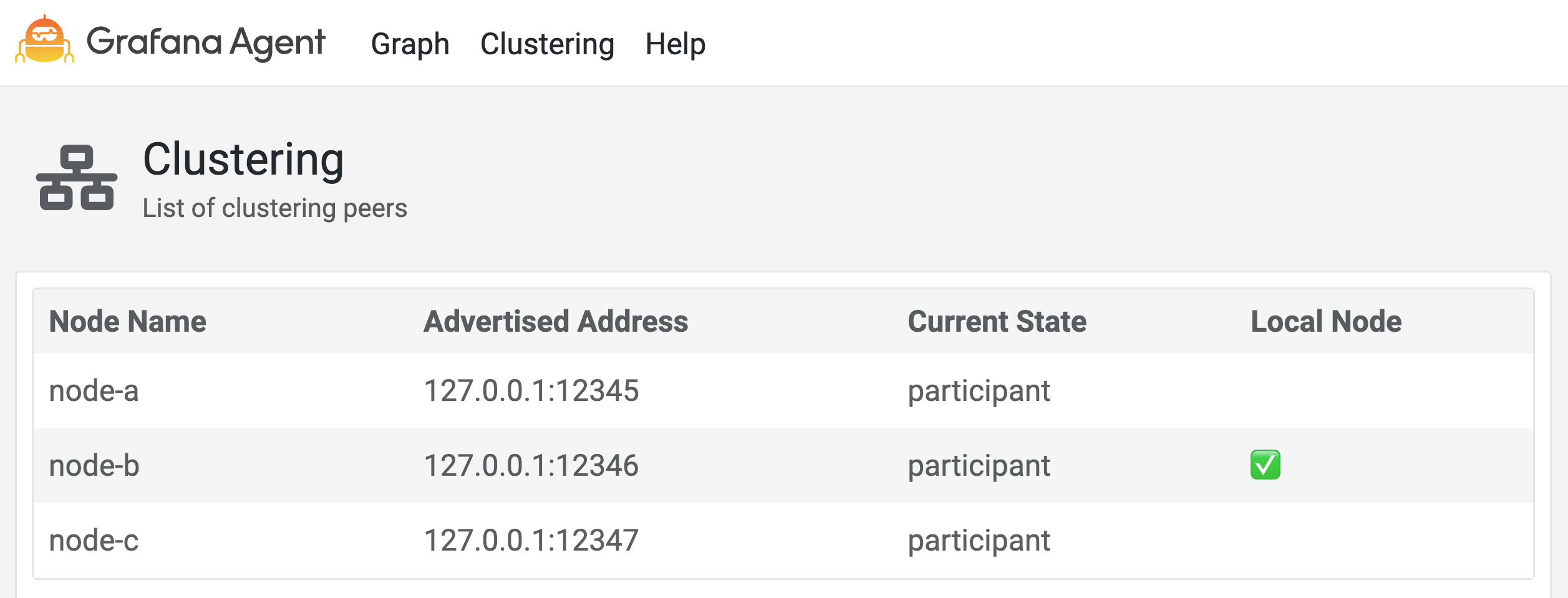

Clustering page
The clustering page shows the following information for each cluster node:
  • The node’s name.
  • The node’s advertised address.
  • The node’s current state (Viewer/Participant/Terminating).
  • The local node that serves the UI.
