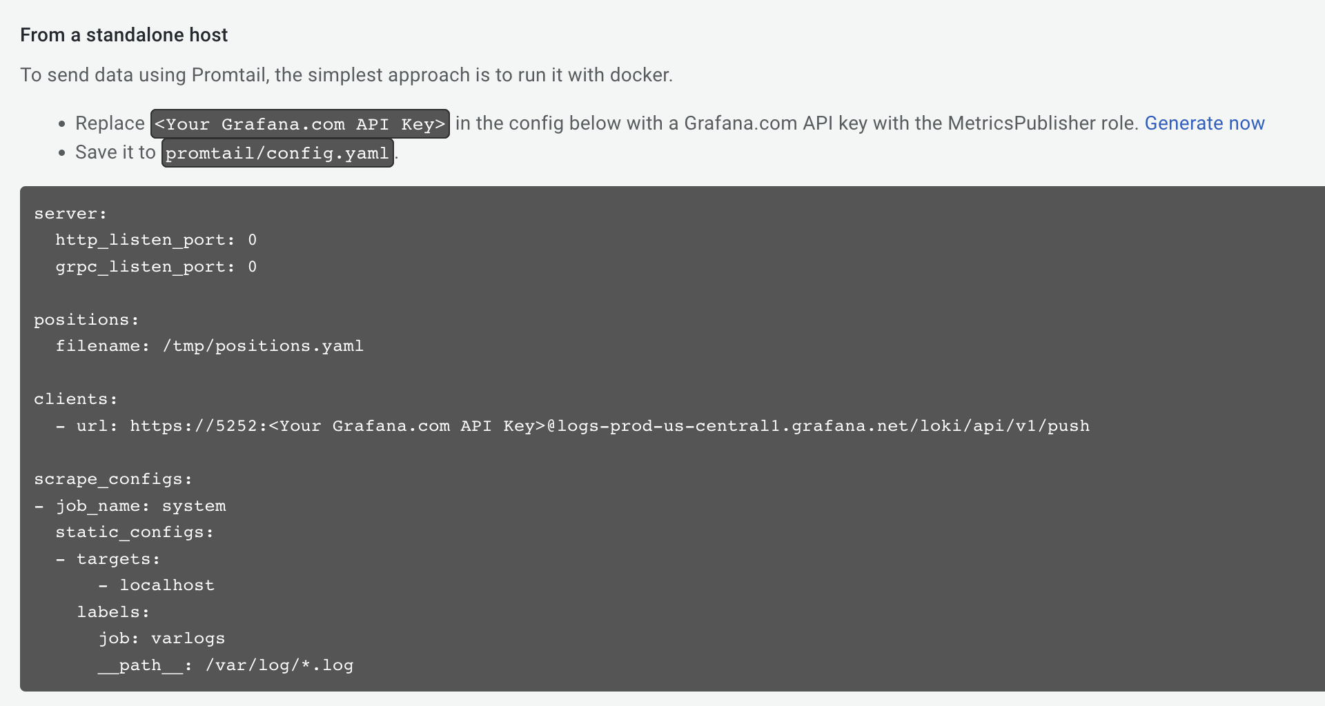

Grafana Loki is a horizontally scalable, highly available, multi-tenant log aggregation system inspired by Prometheus. Similar to Prometheus, to send from OTLP to Loki, we will do a passthrough from the otelcol.exporter.loki component to loki.write component.
otelcol.exporter.loki "default" {
	forward_to = [loki.write.default.receiver]
loki.write "default" {
	endpoint {
		url = "http://loki-endpoint:8080/loki/api/v1/push"
}To use Loki with basic-auth, which is required with GrafanaCloud Loki, you must configure the loki.write component. You can get the Loki config from the Loki Details page in the GrafanaCloud Portal:

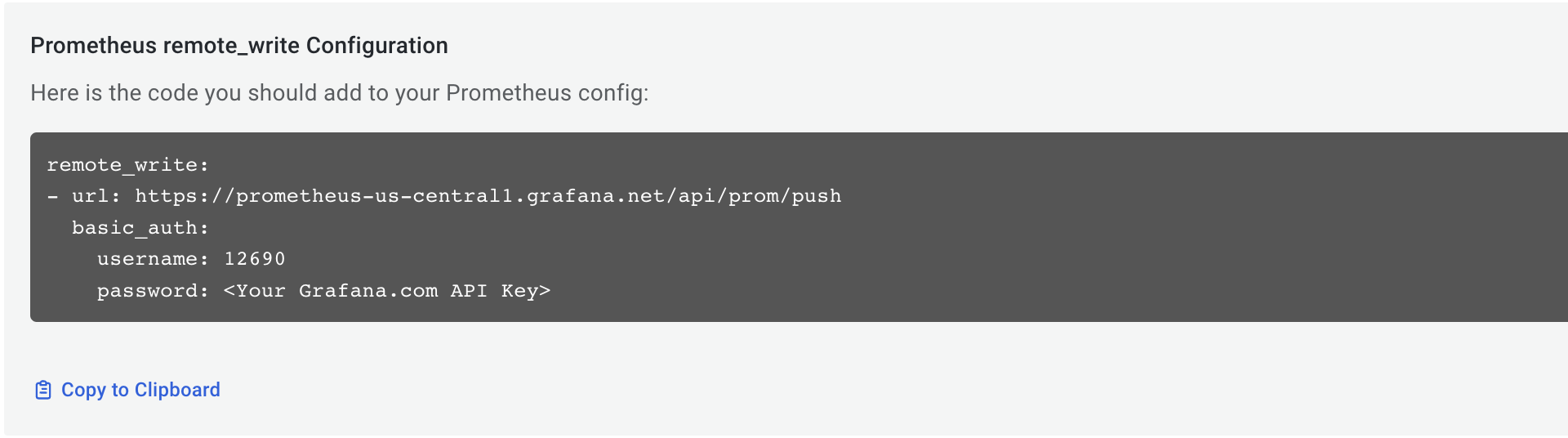

}To use Prometheus with basic-auth, which is required with GrafanaCloud Prometheus, you have to configure the prometheus.remote_write component. You can get the Prometheus config from the Prometheus Details page in the GrafanaCloud Portal:
otelcol.exporter.prometheus "grafana_cloud_prometheus" {
