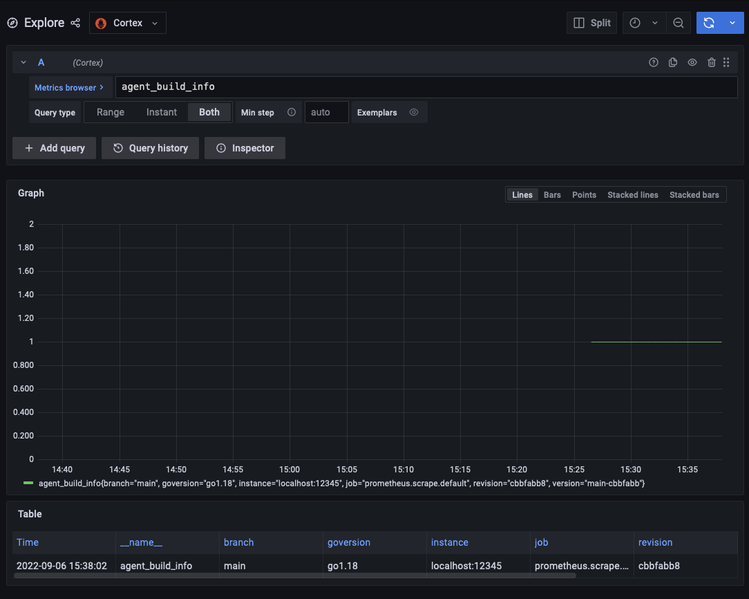

Allow the Grafana Agent to run for two minutes, then navigate to Grafana.
This example scrapes the Grafana Agent’s http://localhost:12345/metrics endpoint and pushes those metrics to the Mimir instance.

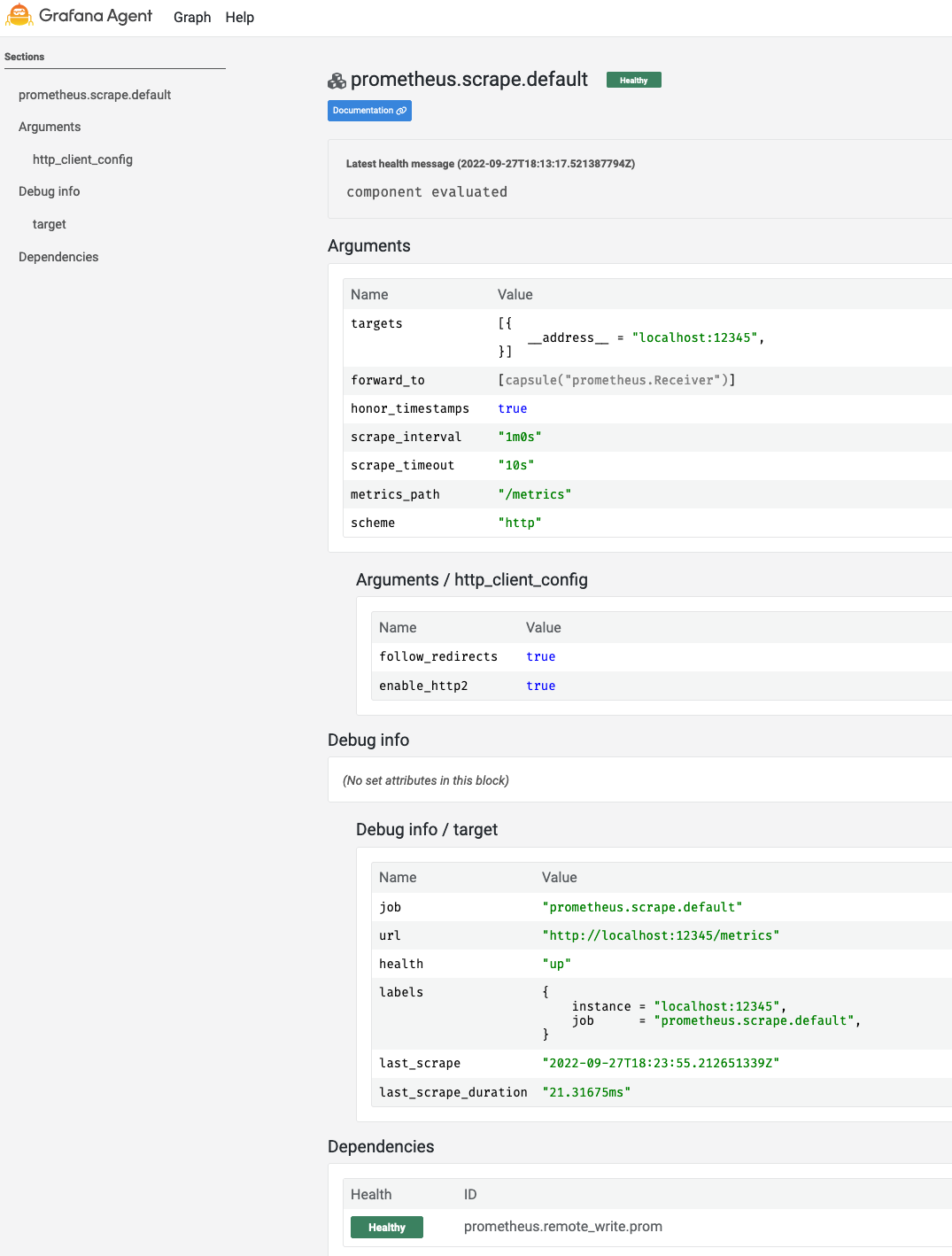

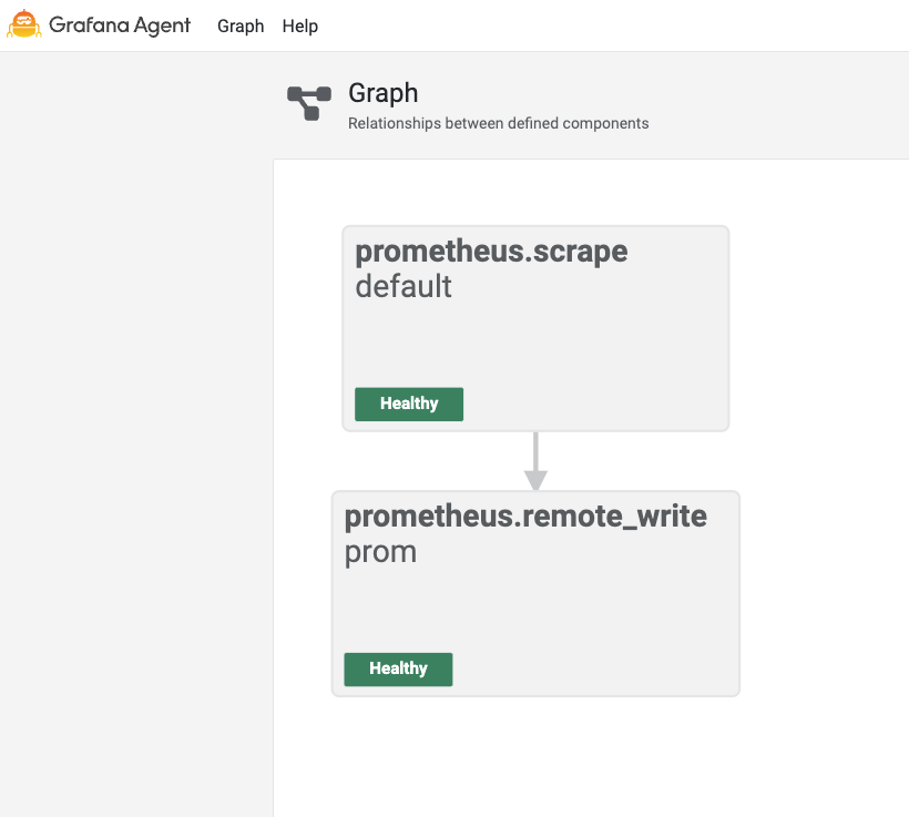

Navigate to http://localhost:12345/graph to view the Grafana Agent Flow UI.
The Agent displays the component pipeline in a dependency graph. See Scraping component and Remote Write component for details about the components used in this configuration. Click the nodes to navigate to the associated component page. There, you can view the state, health information, and, if applicable, the debug information.

The prometheus.scrape component is responsible for scraping the metrics of a particular endpoint and passing them on to another component.
Alloy
// prometheus.scrape is the name of the component and "default" is its label.
prometheus.scrape "default" {
    // Tell the scraper to scrape at http://localhost:12345/metrics.
    // The http:// and metrics are implied but able to be overwritten.
    targets = [{"__address__" = "localhost:12345"}]
    // Forward the scrape results to the receiver. In general,
    // Flow uses forward_to to tell which receiver to send results to.
    // The forward_to is an argument of prometheus.scrape.default and
    // the receiver is an exported field of prometheus.remote_write.prom.
    forward_to = [prometheus.remote_write.prom.receiver]
The prometheus.scrape "default" annotation indicates the name of the component, prometheus.scrape, and its label, default. All components must have a unique combination of name and if applicable label.
The targets attribute is an argument. targets is a list of labels that specify the target via the special key __address__. The scraper is targeting the Agent’s /metrics endpoint. Both http and /metrics are implied but can be overridden.
The forward_to attribute is an argument that references the export of the prometheus.remote_write.prom component. This is where the scraper will send the metrics for further processing.
