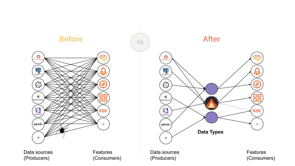

Data plane diagram
The use of data plane is generally not enforced, although it's mandatory for labeled data when using SQL expressions. Refer to Requirements to support SQL expressions to learn more.
Why use the data plane layer?
The main objective of the data plane is to make Grafana more self-interoperable between data sources and features like dashboards and alerting. With data planes compatibility becomes about supporting data types and not specific features and data sources.
For example, if data source produces type "A", and alerting and certain visualizations accept type "A", then that data source works with alerting and those visualizations.
