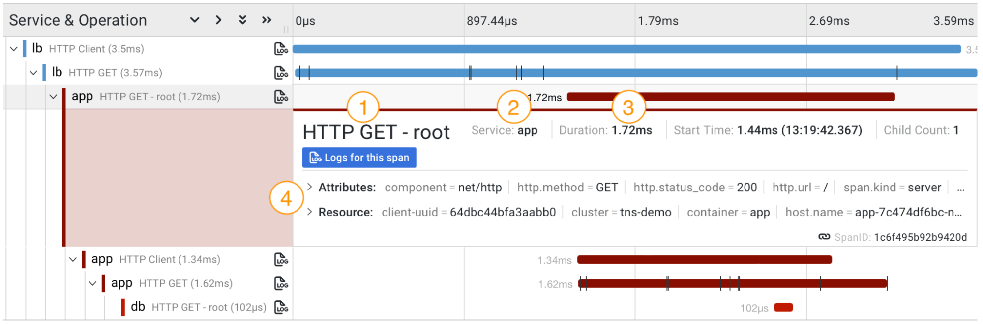

Let’s recap the structure of a trace. As you can see from the image below, we have a trace from a standard three-tiered app with a load-balancer (lb), app, and a database. The tree on the left is the sequence of events starting from the root load balancer and ending with calls to the database. I’ve expanded the details for the main API call in the app and labeled some data points.
A screenshot describes the various components of a trace that are outlined in the paragraph above.
  1. Span name. The unique text for this event: HTTP GET - root
  2. Service name. The name of the component that created this span: app. On the left, you can see several spans all from app.
  3. Duration. This specific request took 1.72ms.
  4. Attributes. The metadata attached to this span is a list of key/value pairs that can contain a wealth of information. These values can be anything you want, but there are some industry conventions that improve interoperability and many instrumentation libraries populate data here automatically.
