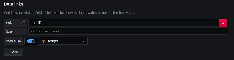

The trick to setting up a link from Elasticsearch to Tempo is to use a data link. In the Elasticsearch data source configuration, it will look something like this:
With this configuration, Grafana will look for an Elasticsearch field called “traceID.” If one is found, Grafana will build a link using this ID to the Tempo data source.

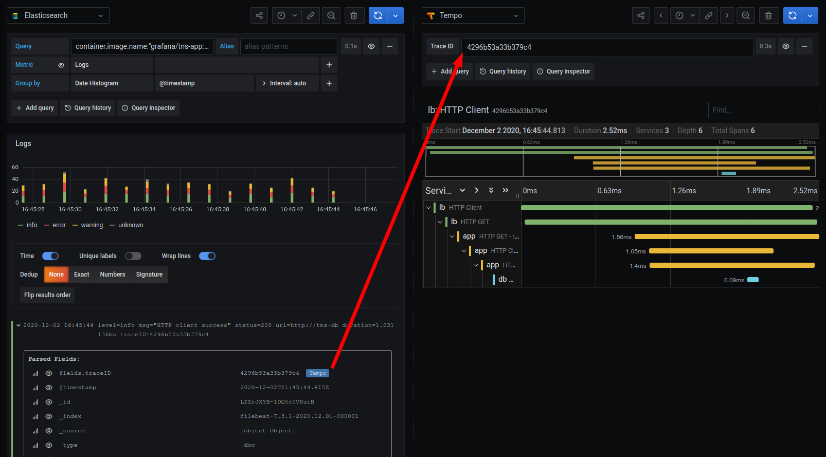

After we get this link set up correctly, then in Explore, we can jump directly from logs to traces:
Now all the power of your Elasticsearch logging backend is available to you for finding traces as well!

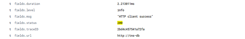

The Elasticsearch ecosystem seems primarily geared toward JSON logging, but at Grafana Labs, logfmt is the preferred formatting for logs. In order to get links to work from Elasticsearch fields, we needed to extract the logfmt key/value pairs and insert them as Elasticsearch fields.
We used Filebeat along with a custom pipeline processor to accomplish this, but it seems that perhaps logstash along with a third party processor may have been a better path.
With the above configuration, the following log line…
level=info msg="HTTP client success" status=200 url=http://tns-db duration=2.213011ms traceID=2bd4c457541a72fa
…was parsed into the following fields in Elasticsearch:
Obviously if you are using Elasticsearch as a logging backend, you have probably already figured out how to extract values from your logs and expose them as fields. So go with whatever is already working for you!
