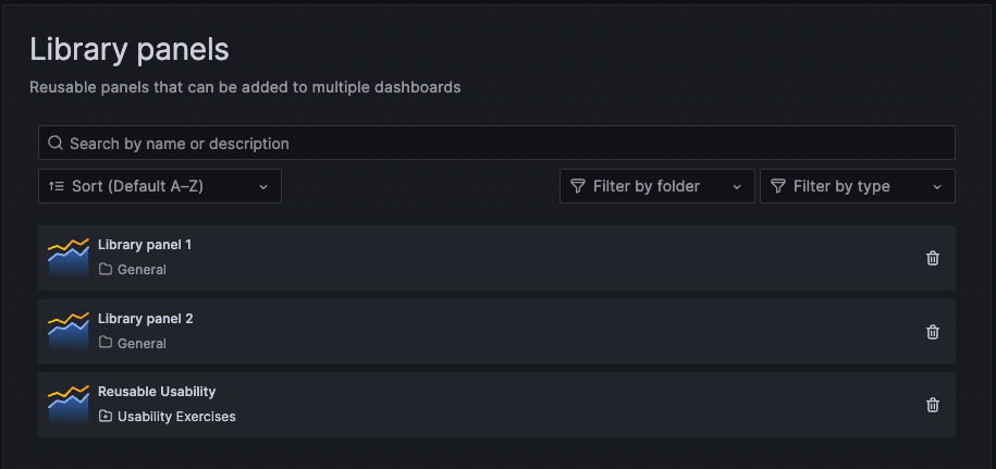

View a list of library panels
You can view a list of available library panels and see where those panels are being used.
To view and manage library panels, follow these steps:
  1. Click Dashboards > Library panels in the main menu.
    You can see a list of previously defined library panels.
    Library panels page with list of library panels
  2. Search for a specific library panel if you know its name.
    You can also filter the panels by folder or type.
  3. Click the panel to see if it’s being used in any dashboards.
  4. (Optional) If the library panel is in use, select one of the dashboards using it.
  5. (Optional) Click View panel in <dashboard name> to see the panel in context.
