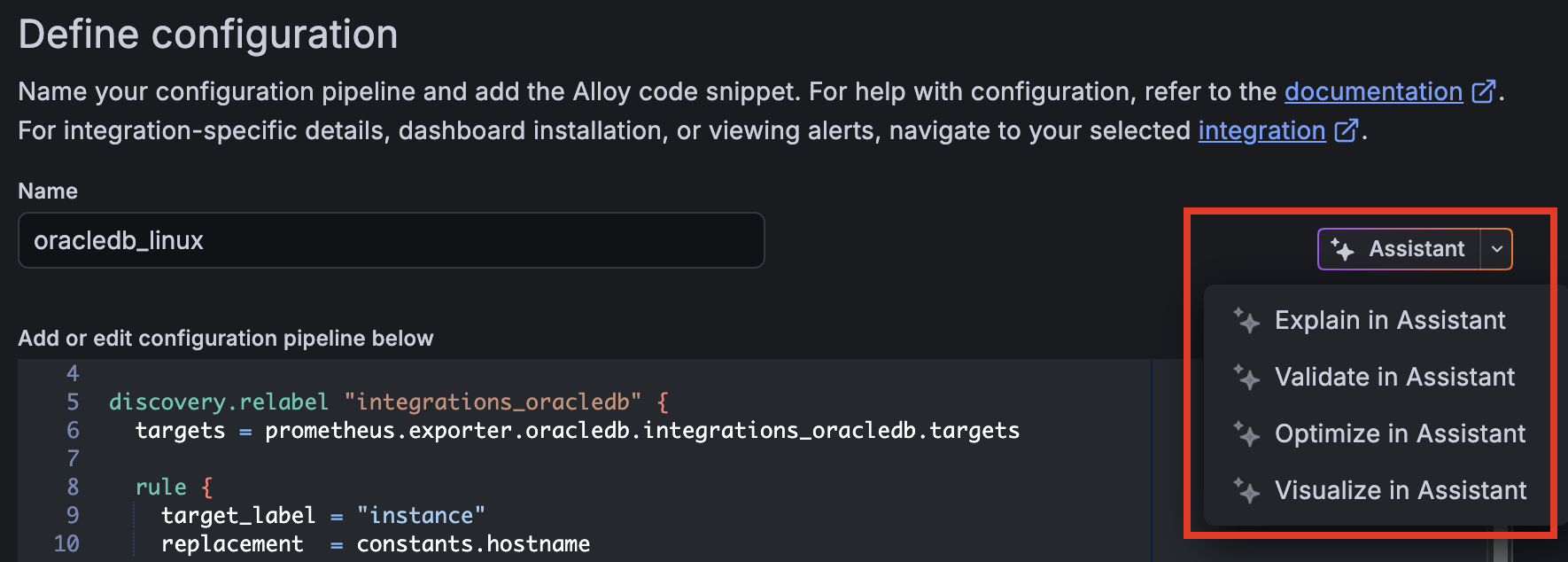

Review the content of the new configuration pipeline and make any changes you might require.

Click Test configuration pipeline to validate the configuration syntax. The pipeline editor provides real-time feedback on the syntactic validity of the configuration content.
Click Next to assign the configuration pipeline to collectors or click Save to save an incomplete pipeline.
Defining and validating a new configuration pipeline using the InfluxDB Linux integration.
