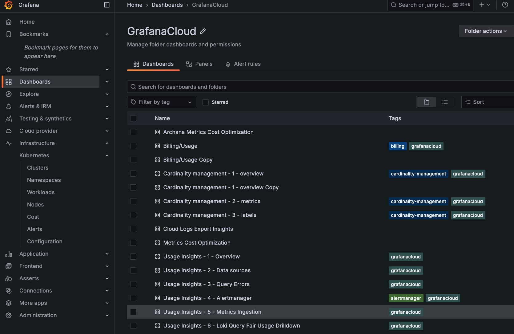

In this phase, metrics are sent to Grafana Cloud. If there is an issue, there are likely no metrics being delivered. This can occur if your account limits for metrics is reached. Check the Usage Insights - 5 - Metrics Ingestion dashboard.
List of Grafana Cloud dashboards with Metrics Ingestion dashboard highlighted

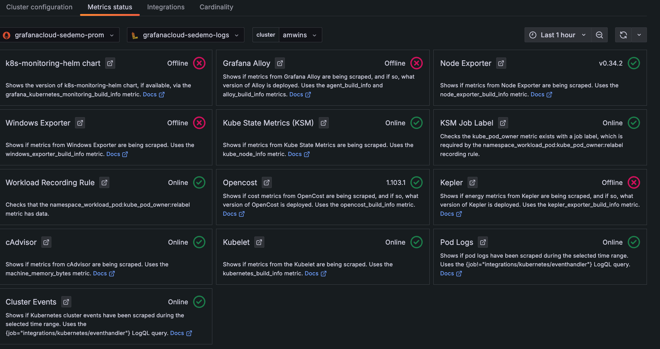

View metrics status
To view the status of metrics being collected:
  1. Click Configuration on the menu.
  2. Click the Metrics status tab.
  3. Filter for the Cluster or Clusters you want to see the status of.
**Metrics status** tab with status indicators for one Cluster
Metrics status tab with status indicators for one Cluster
Status icons
Each panel of the Metrics status shows an icon that indicates the status of the incoming data, based on the selected data source, Cluster, and time range:

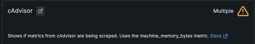

  • Check mark in a circle (green): Data for this source is being collected. The version of the source or online status also displays (if available).
  • Caution with exclamation mark (yellow): Duplicate data is being collected for the metric source.
  • X in a circle (red): There is no data available for this item within the time range specified, and it appears to be offline.
**Metrics status** panel with icon warning of multiple metrics
Metrics status panel with icon warning of multiple metrics
Check initial configuration
When you initially configure, if any box shows a red X in a circle, it can be any of the following:
  • The feature was not selected during Cluster configuration.
  • The system is not running correctly.
  • Alloy was not able to gather data correctly.
  • No data was gathered during the time range specified.
View the query with Explore
If something in the metrics status looks incorrect, click the icon next to the panel title. This opens the query in Explore where you can examine the query for any issues, such as an incorrect label.

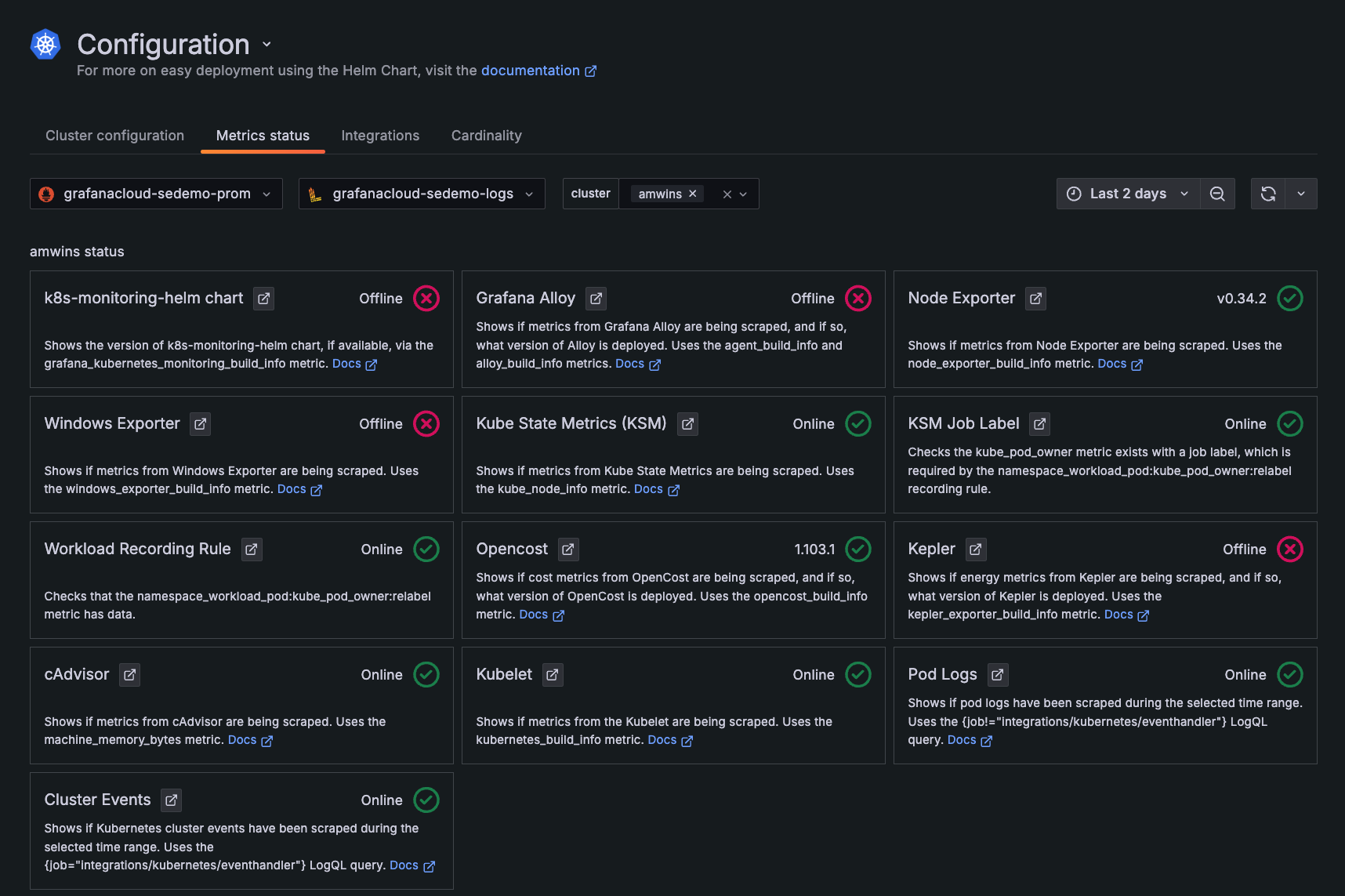

Look at a historical time range
Use the time range selector to understand what was occurring in the past. In the following example, Cluster events were being collected but are not currently.
Time range of last two days for **Metrics status**
Time range of last two days for Metrics status
