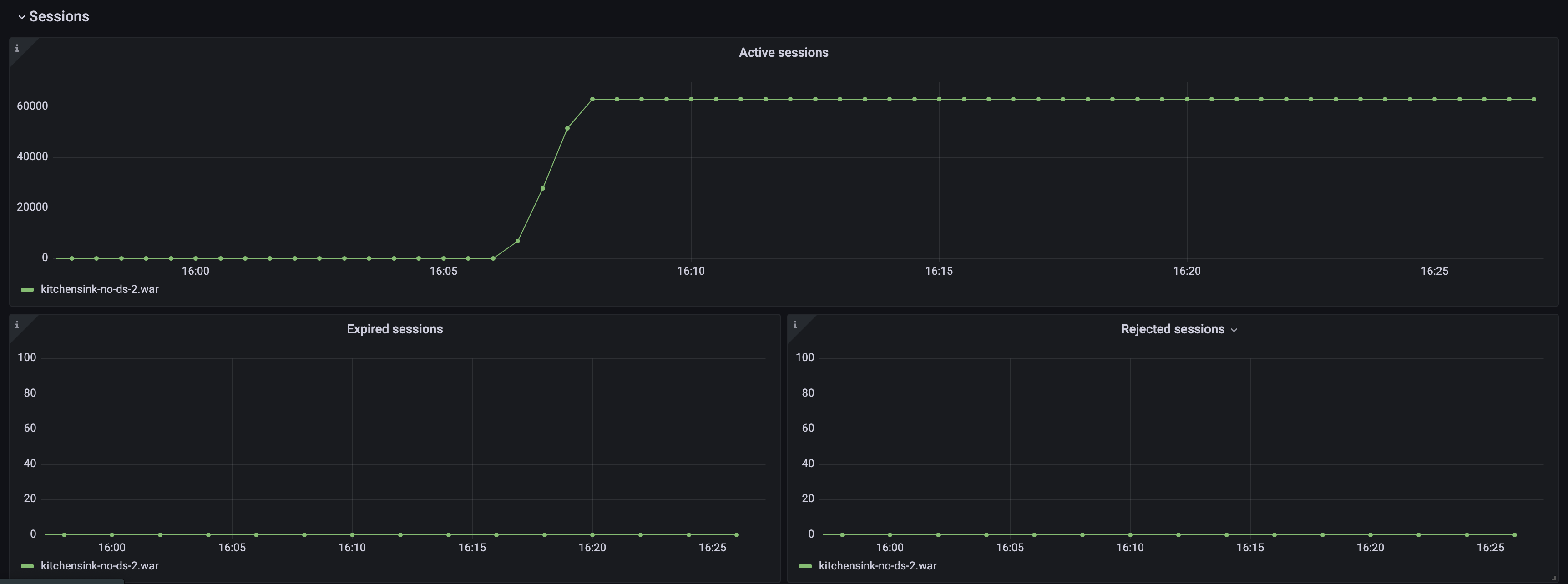

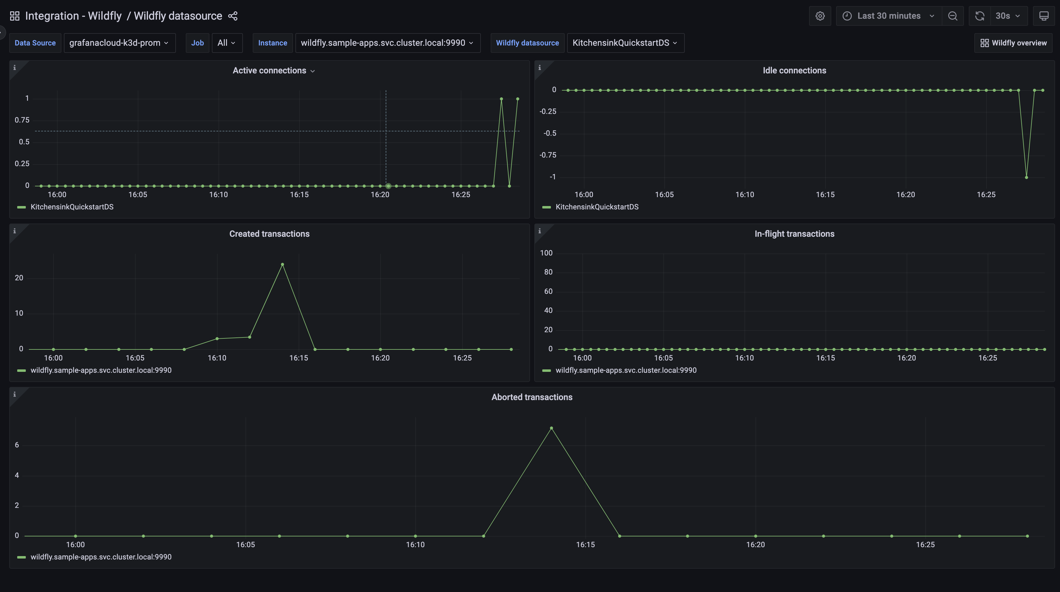

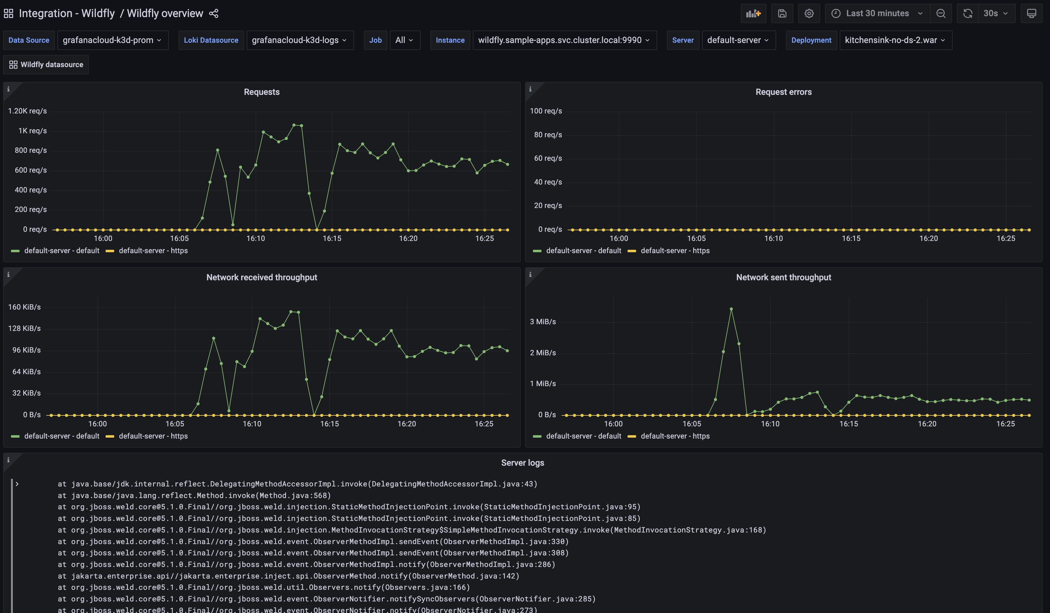

Wildfly overview
Wildfly overview (Sessions)
Wildfly datasource dashboard
