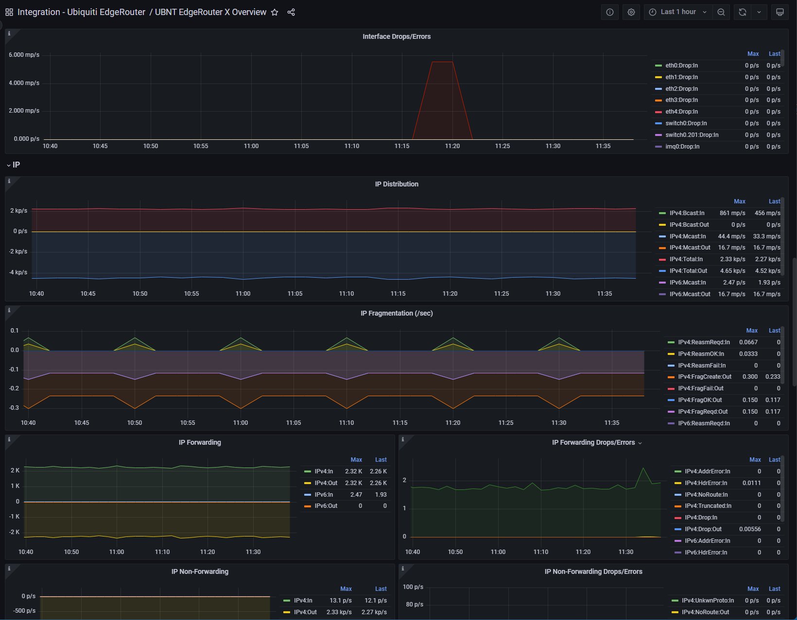

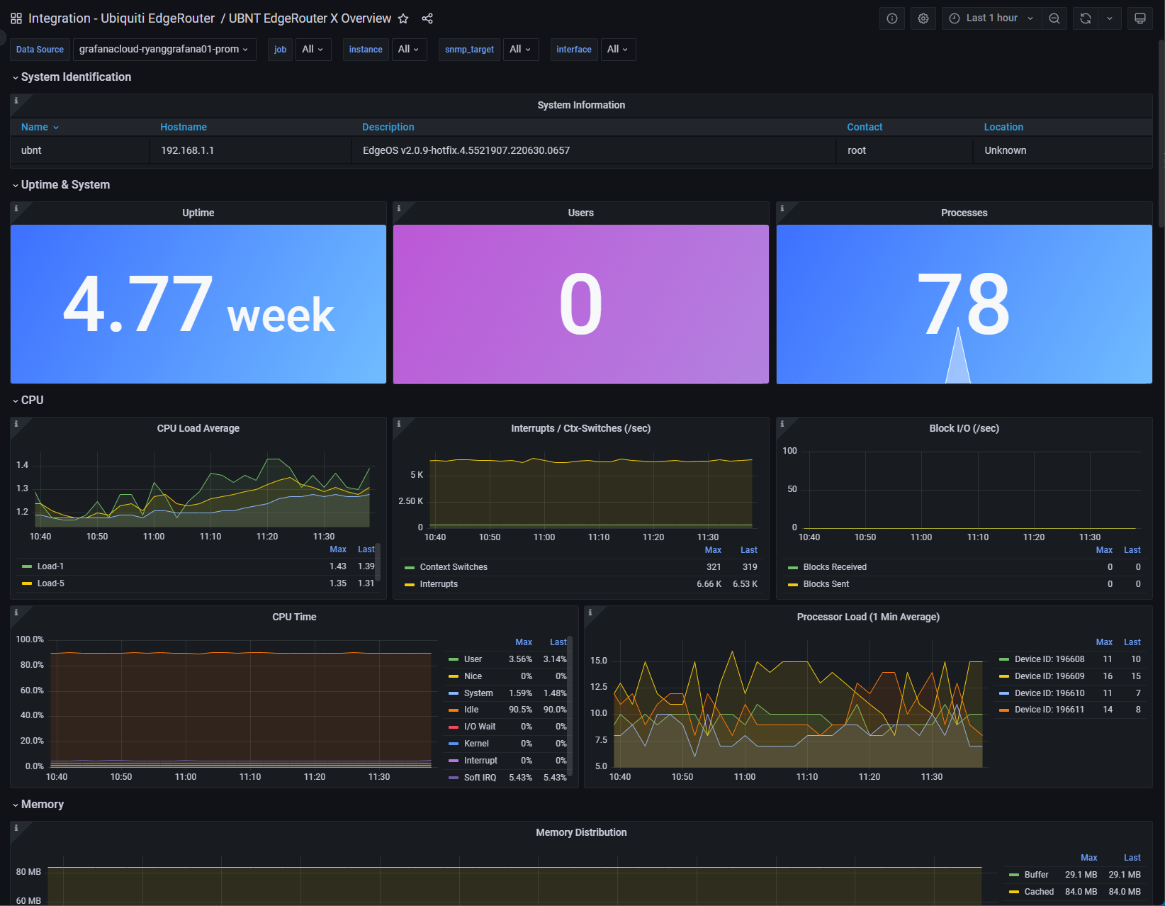

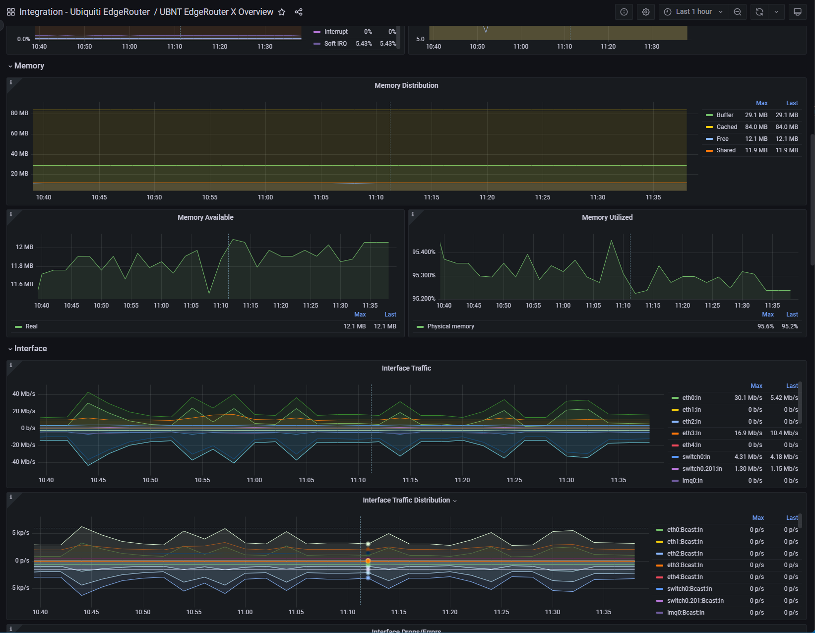

The Ubiquiti EdgeRouter integration installs the following dashboards in your Grafana Cloud instance to help monitor your system.
- Ubiquiti EdgeRouter Overview
System Identification, Uptime & System, CPU
Memory, Interface
IP
Metrics
The most important metrics provided by the Ubiquiti EdgeRouter integration, which are used on the pre-built dashboard, are as follows:
