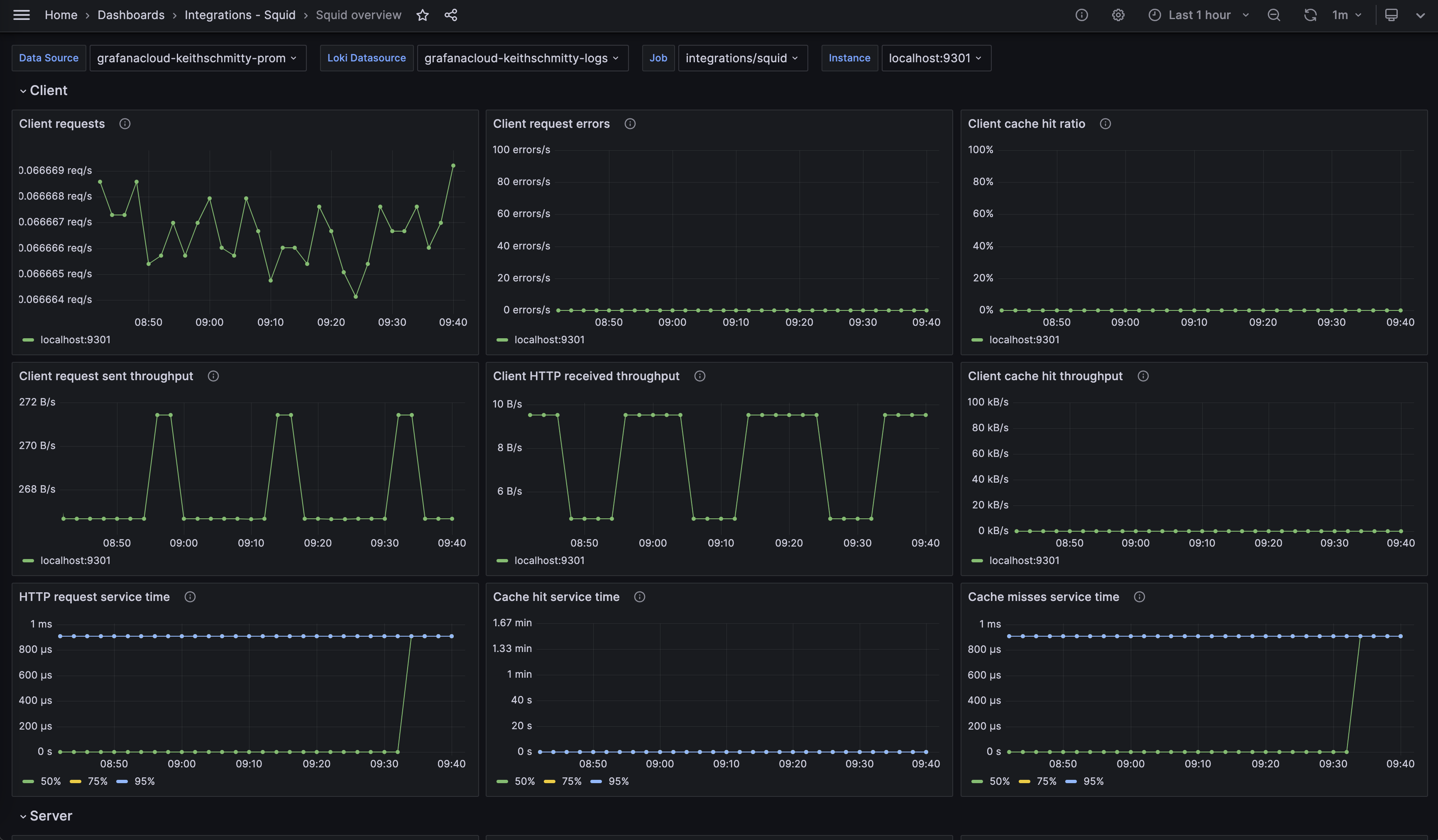

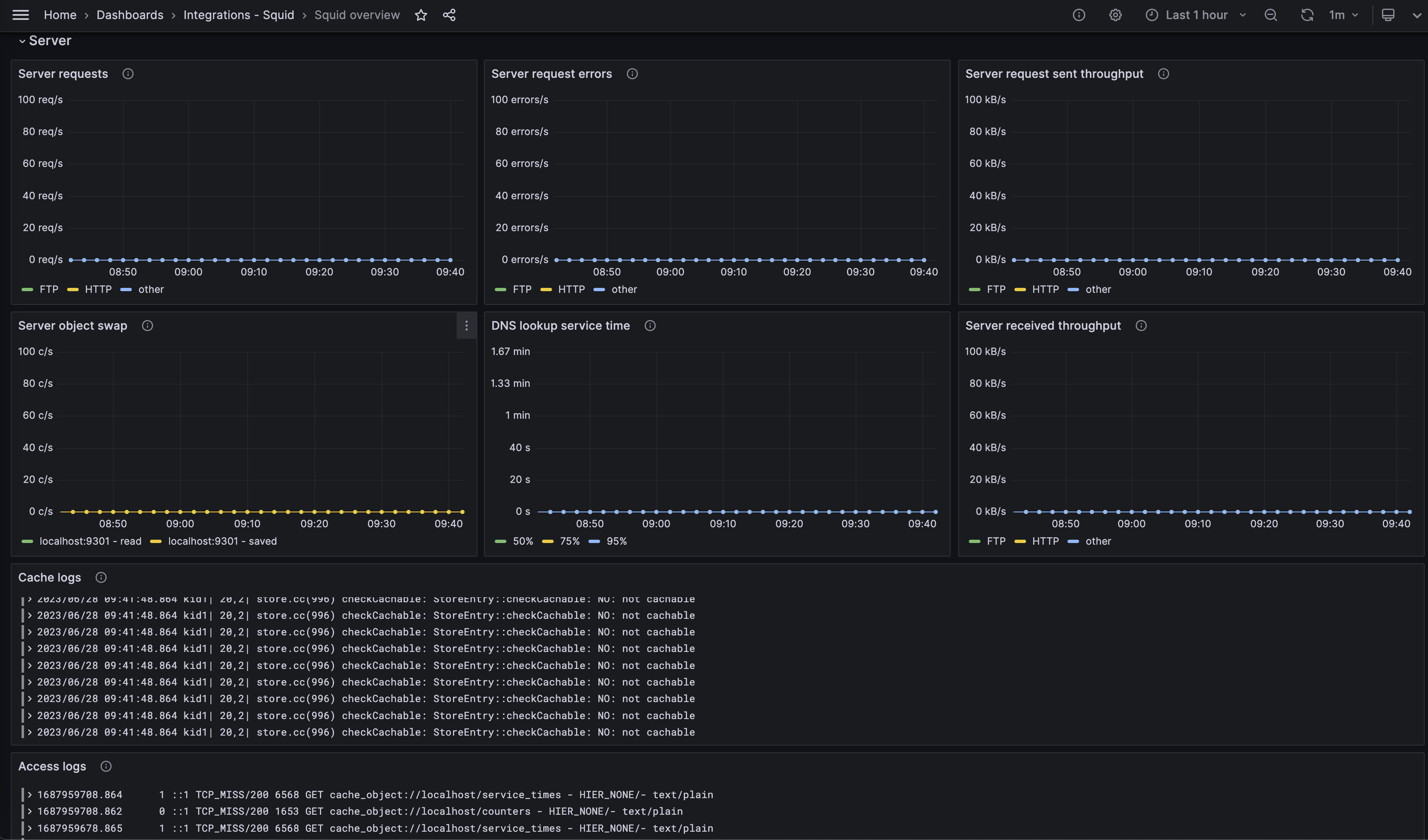

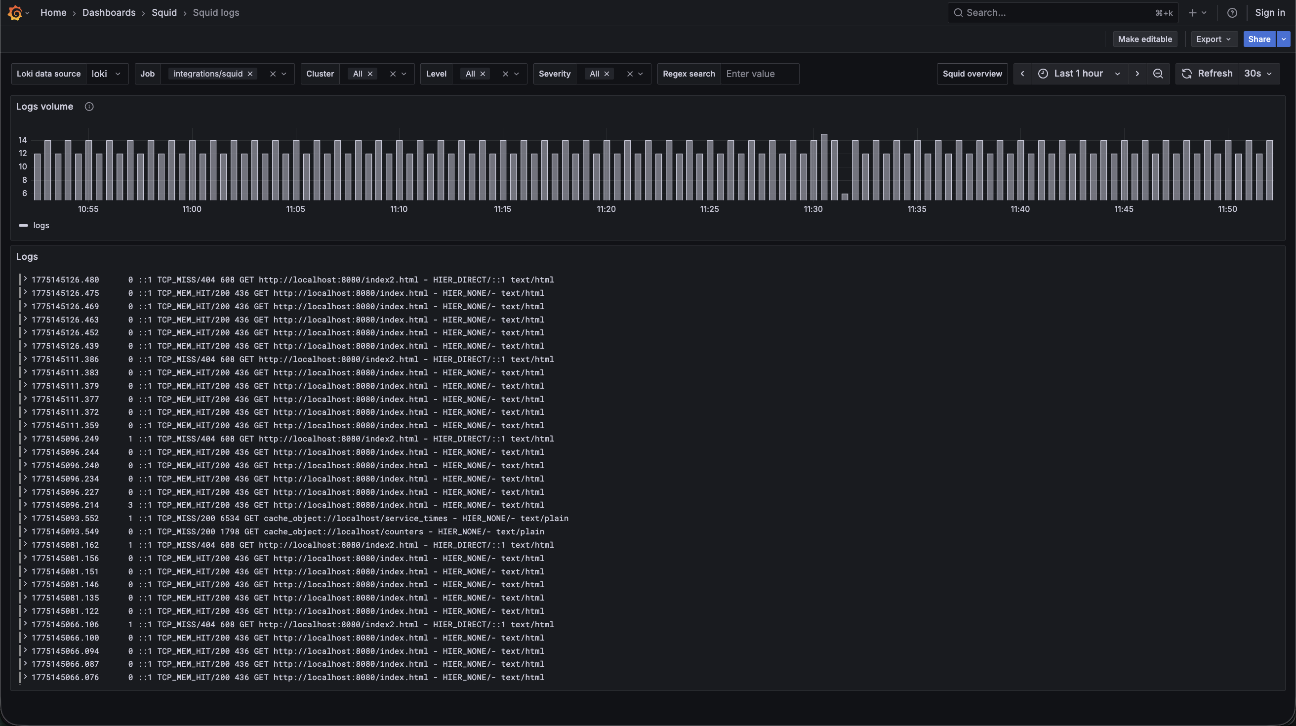

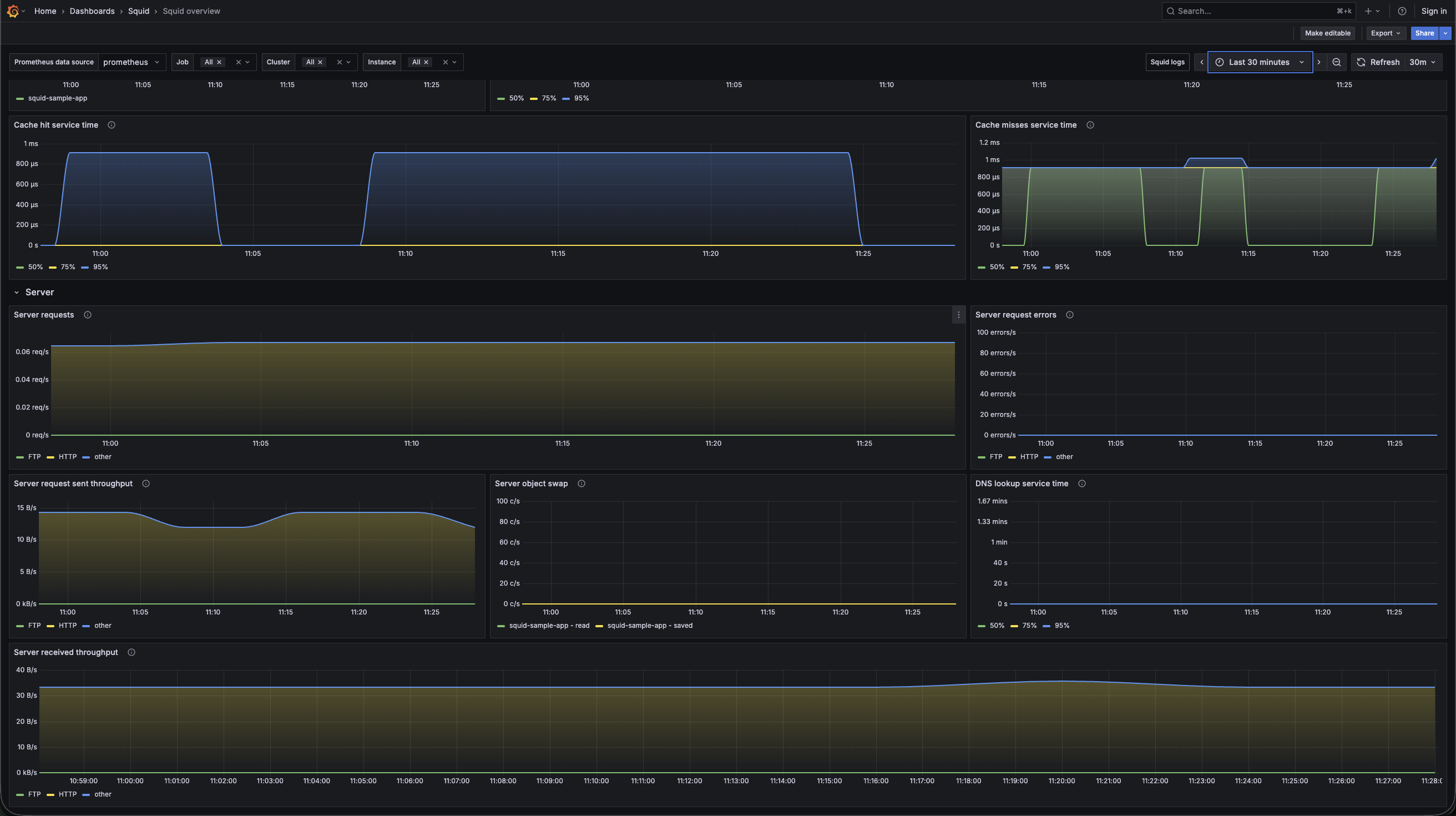

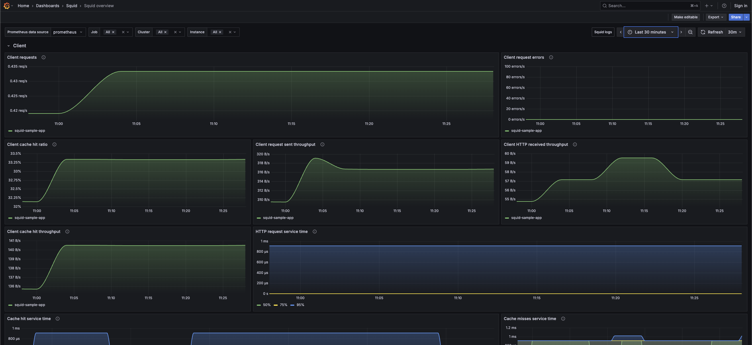

}Dashboards
The Squid integration installs the following dashboards in your Grafana Cloud instance to help monitor your system.
- Squid logs
- Squid overview
Squid overview dashboard (client)
Squid overview dashboard (server)
Squid logs dashboard
