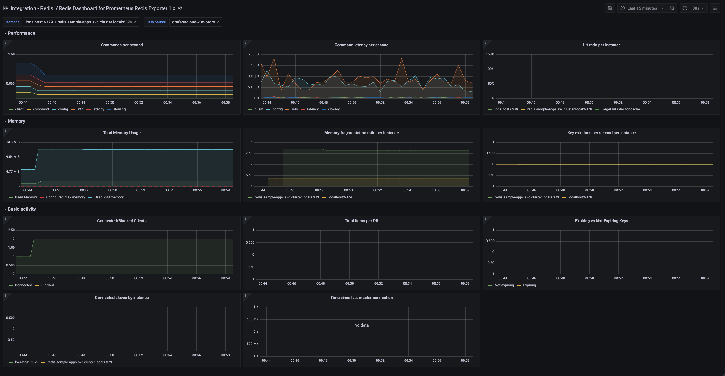

Dashboards
The Redis integration installs the following dashboards in your Grafana Cloud instance to help monitor your system.
- Redis Dashboard for Prometheus Redis Exporter 1.x
