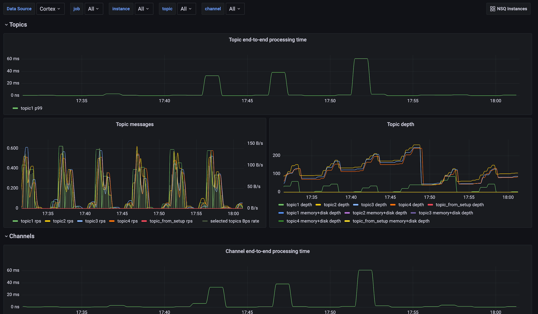

NSQ topics dashboard

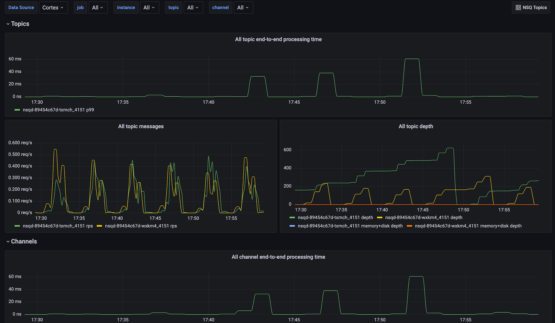

NSQ instances dashboard
